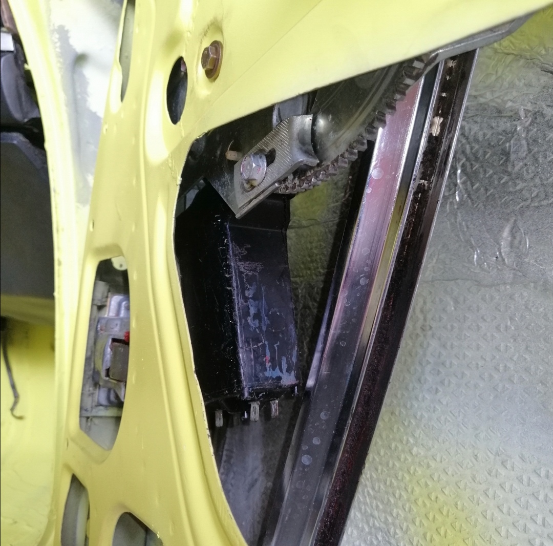

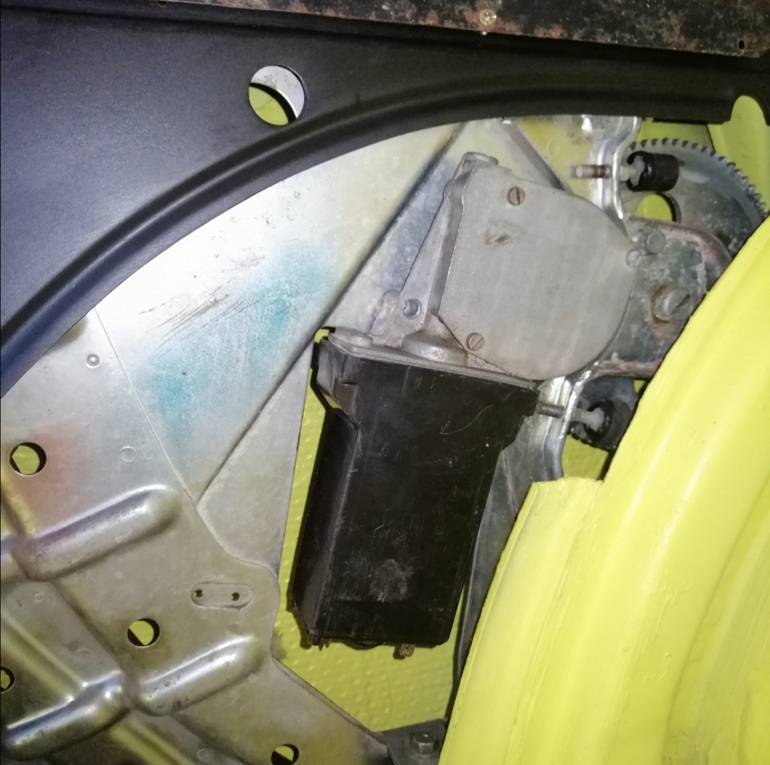

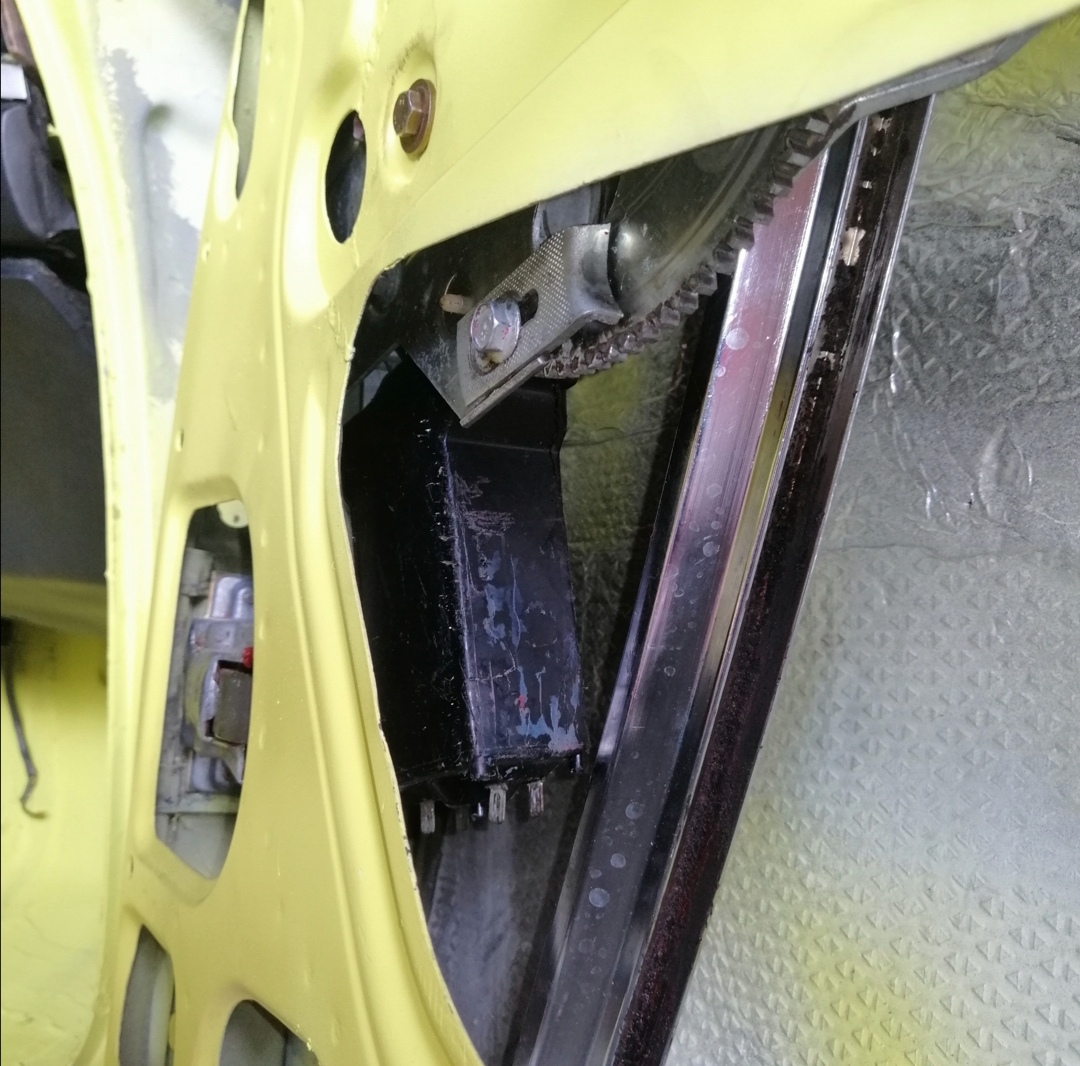

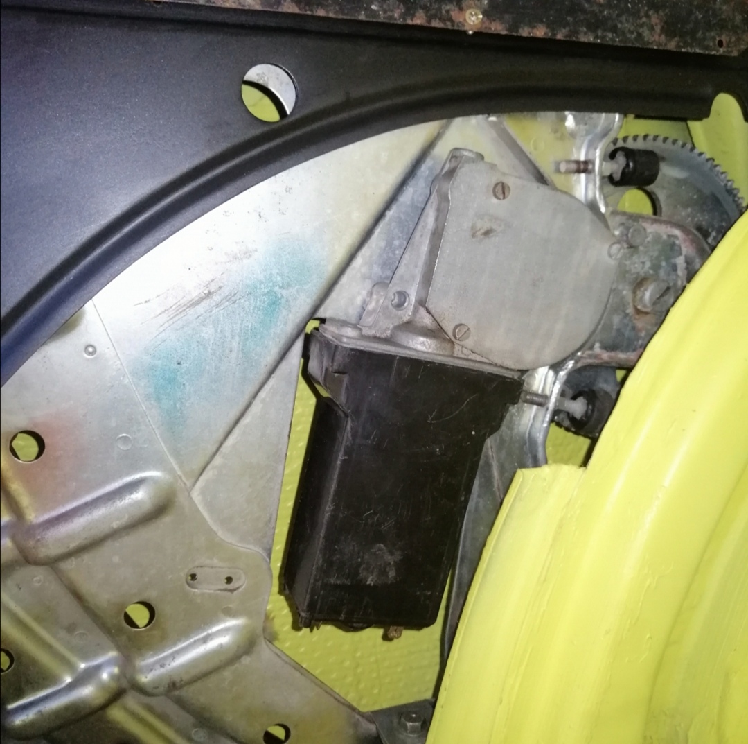

Here is picture of my front and rear motor
I did the full maintenance on all of them and they were basically pulled apart every single part and and a new grease was applied and trust me they work fine but I though that there was an other type of motor that can be used but in this case I won't bother anymore as mines are working just perfect
