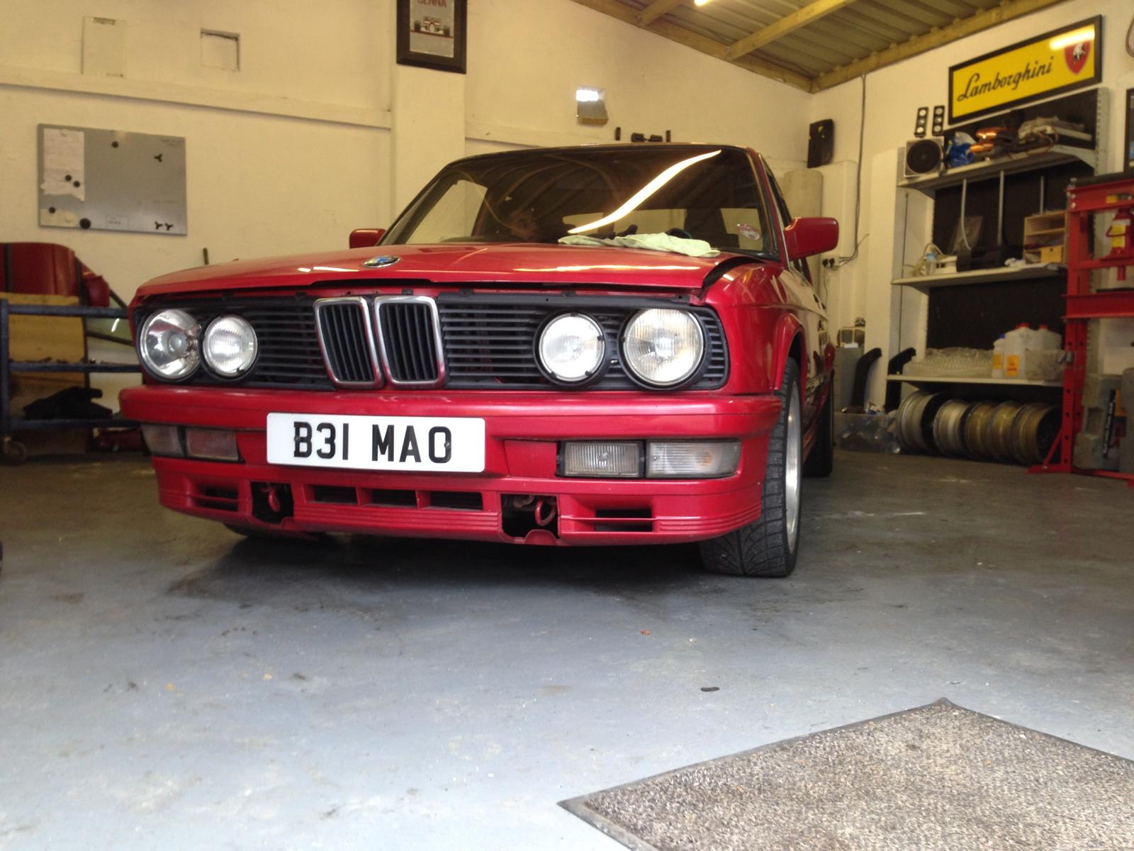

So since I bought the E24 and put it back on the road after 20 years I have been discovering the joys of getting slightly crispy cars on the verge of needing a LOT of work, taking an educated gamble and fixing up to an acceptable level and just enjoying it.
Latest was a MK4 Golf R32 that had been turned into a full show car and then laid up for 5 years. Promptly returned to as close as I could do standard however it was always needing something. Now constant maintenance I can deal with, however the fact you need to take the front end off to do pretty much anything (bumper off to change a bulb) or be blessed with incredibly small hands meant that the hunt was on for something a bit more vintage.

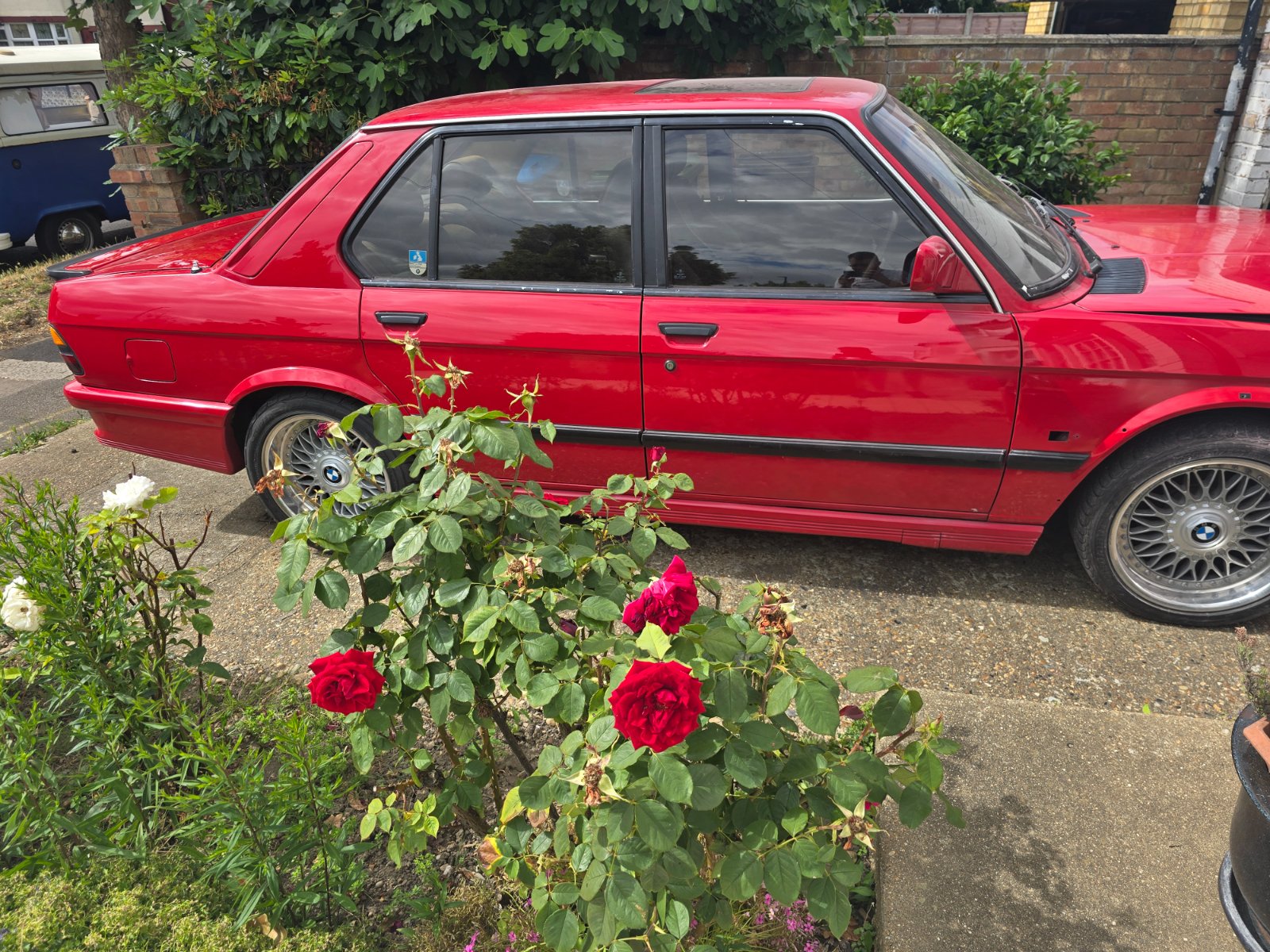

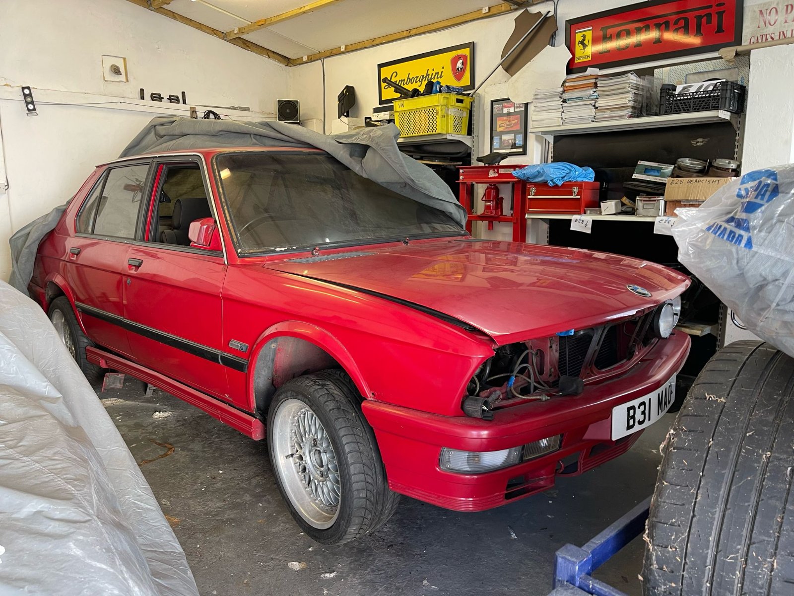

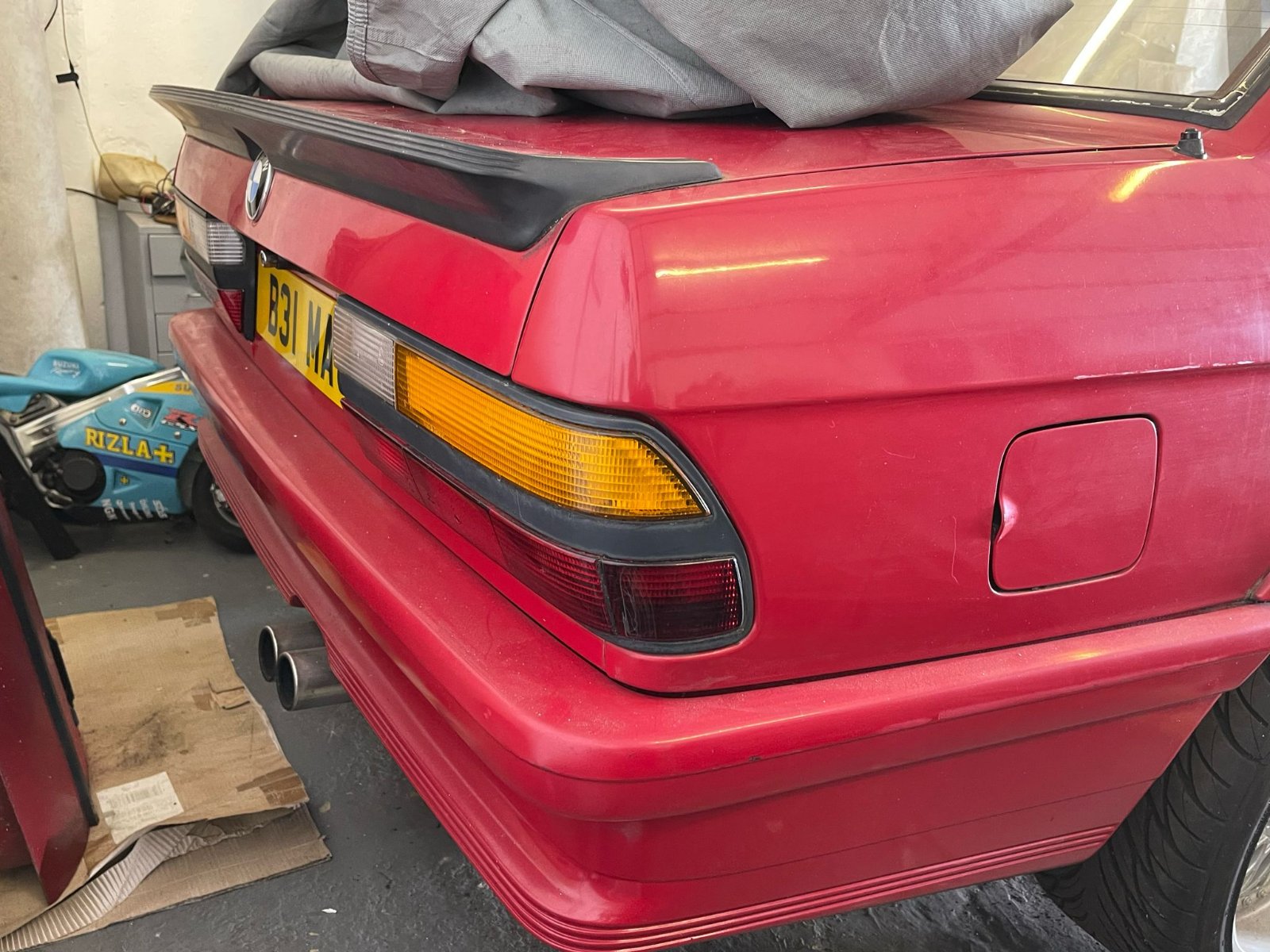

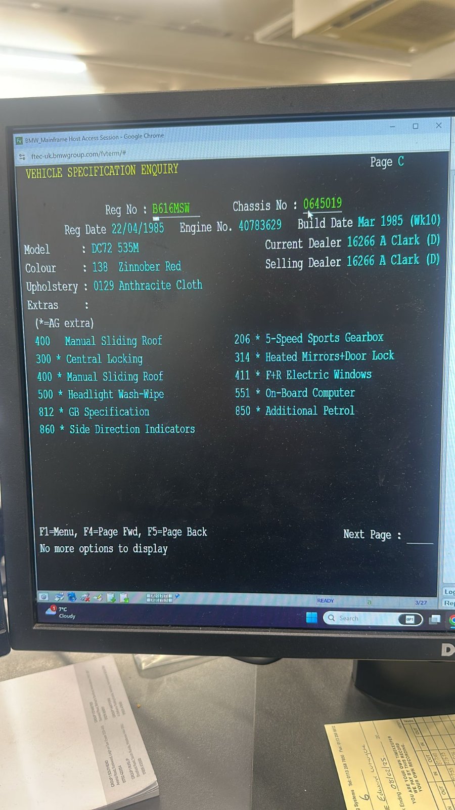

Was offered this E28, a genuine dogleg manual M535, March 85 built only chassis number 0019 of DC72 type production. Zinnobar red with anthracite cloth, a surprisingly solid car with minimal rust on the O/S wing and a few surface scabs here and there. The metrics are long gone and some RC090s are there which I will keep, probably refurbish before I get fresh rubber. Car has been sitting since COVID when it was dismantled somewhat as a little project then left. All rubber hoses need to be changed, at the same time will do water and fuel pump, viscous fan, clean the injectors and give it a full service.

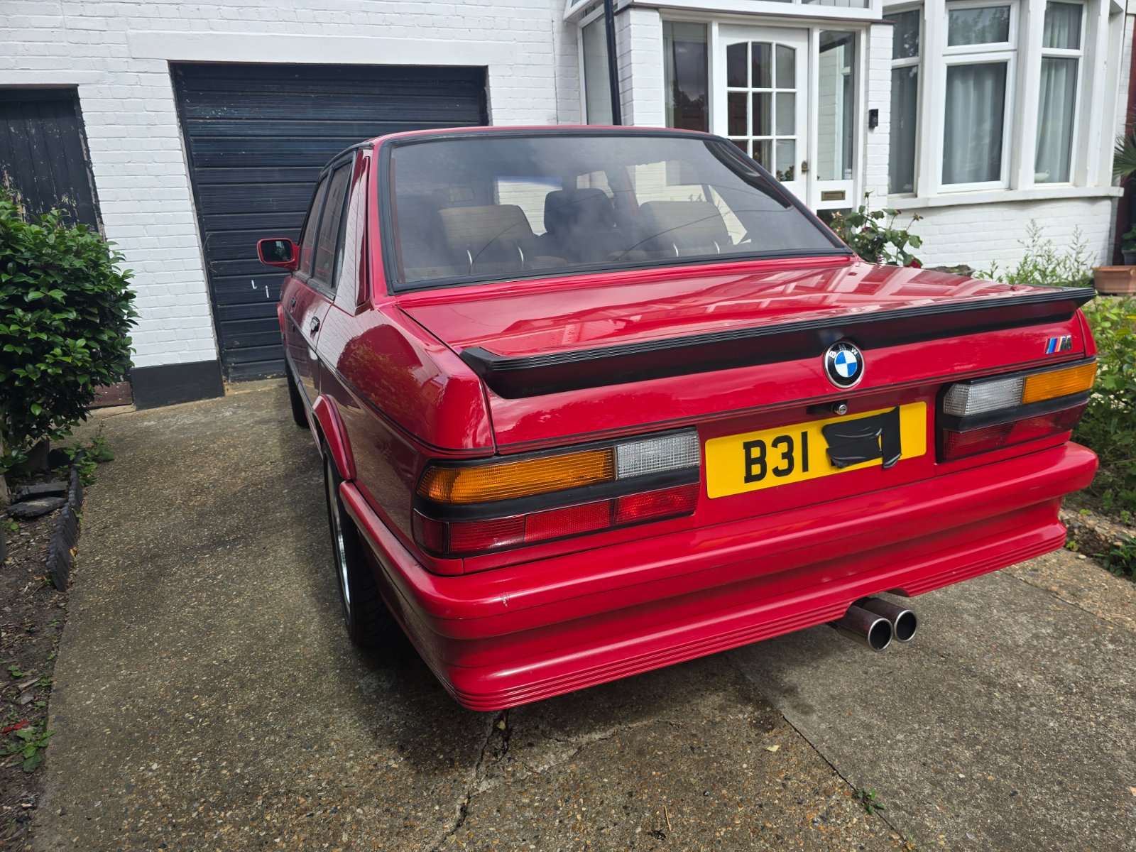

I'll be honest I do prefer the chrome bumpers/euro m5 valance to the 'tupperware' kit the m535s had but it's very of it's period especially with the colour.

Thanks Jim!
It's very much a driver spec car, minimal options, originally a demo car for the dealership, just like my e24! But less to go wrong and I prefer a bit more bare bones for less weight and conplication. The all important "why don't you have wipers for your headlights, peasant?" box was ticked though!

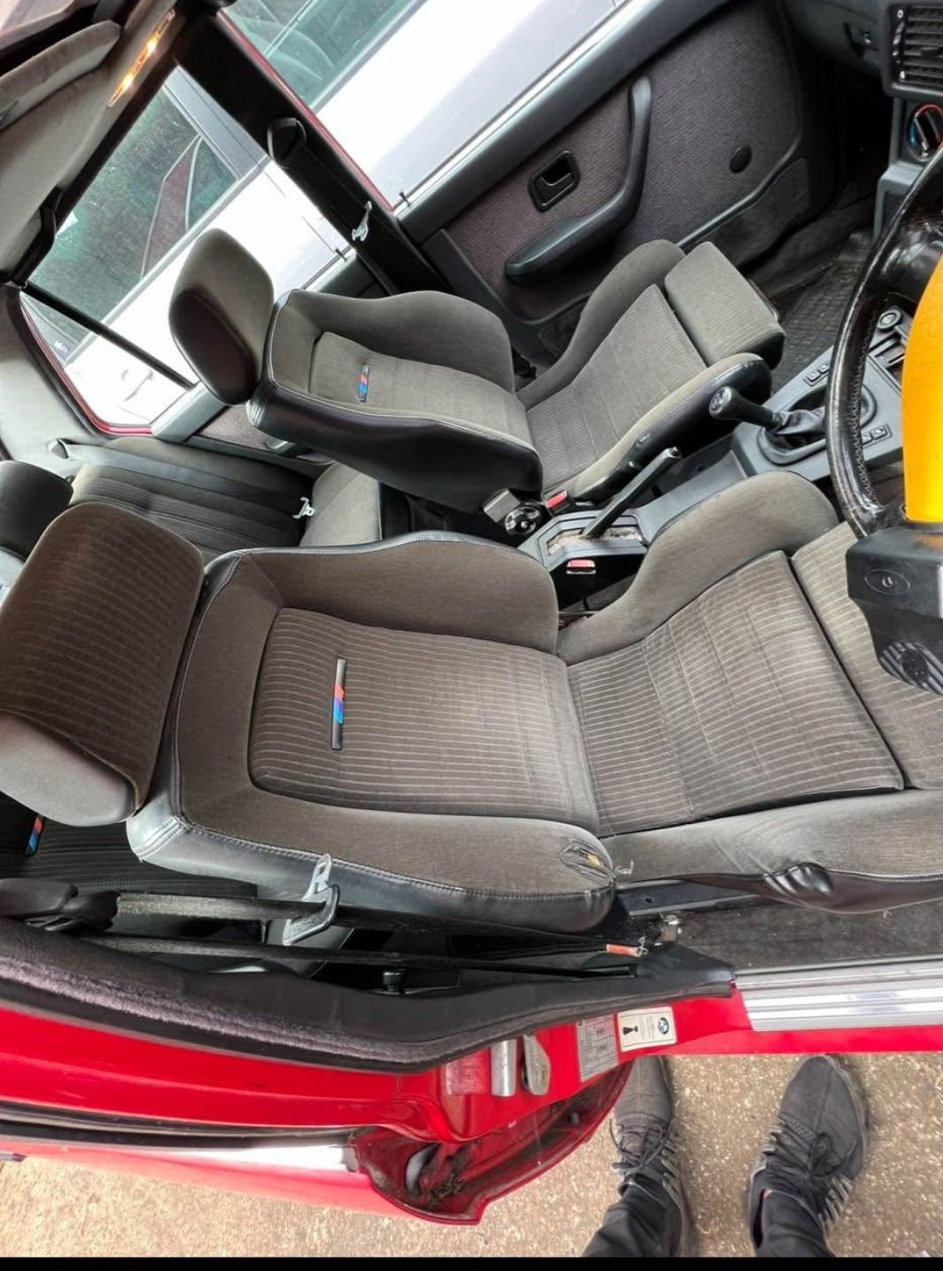

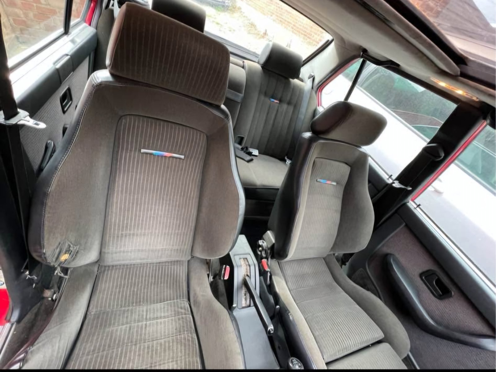

Saw these come up for sale local to me and couldn't resist, when have you seen factory cloth e28 recaros!? Even in anthracite cloth and with the m technic badges, the stars aligned and simply had to be snagged for this car. Does need a bolster repair but nothing .ajor

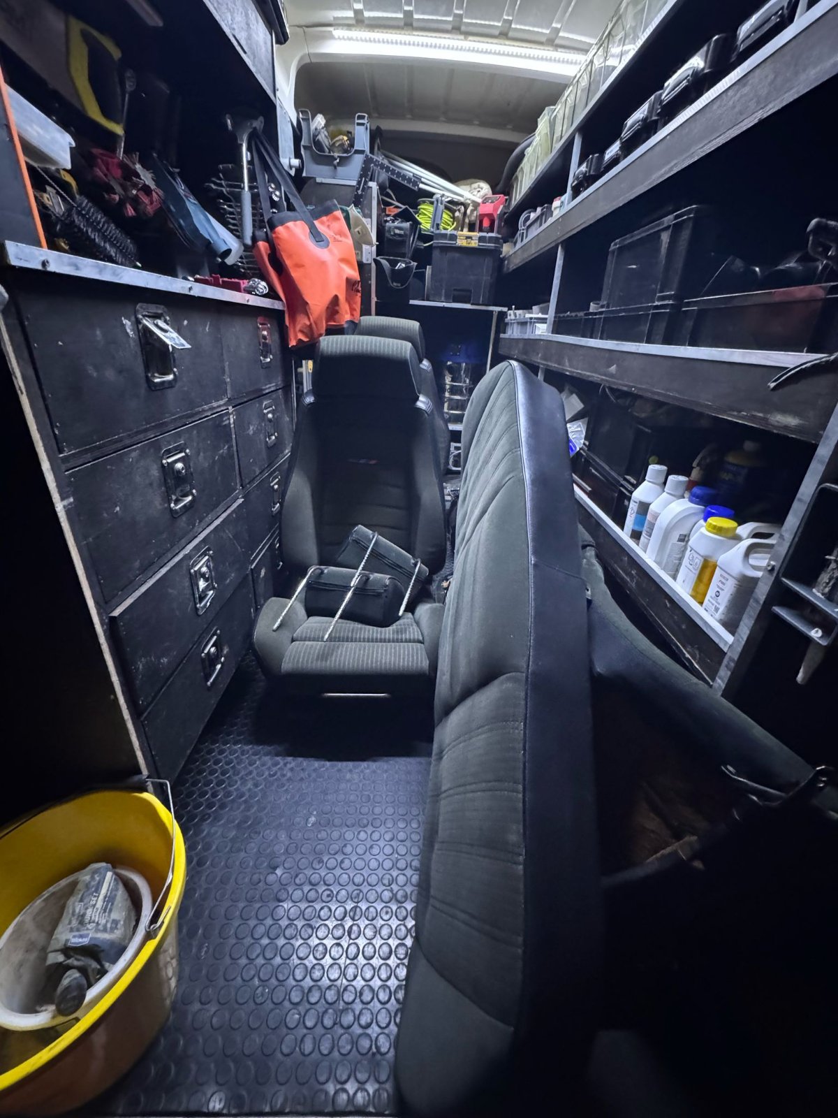

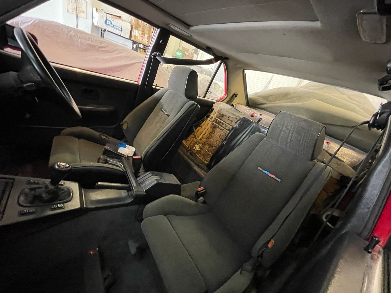

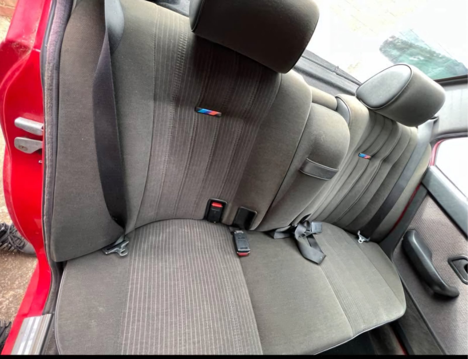

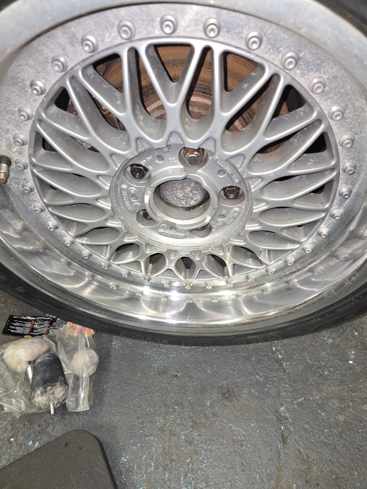

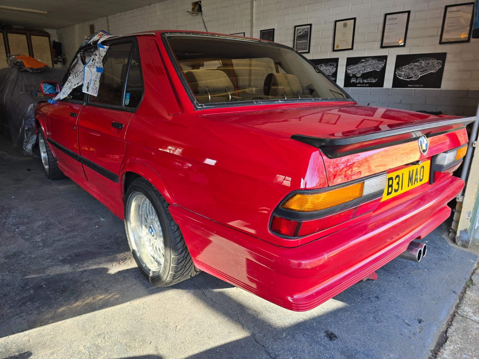

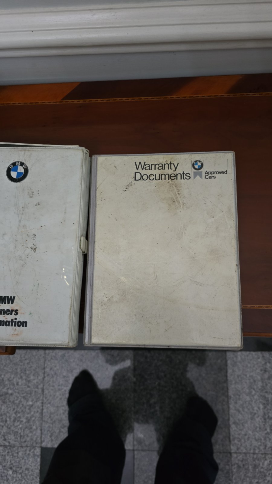

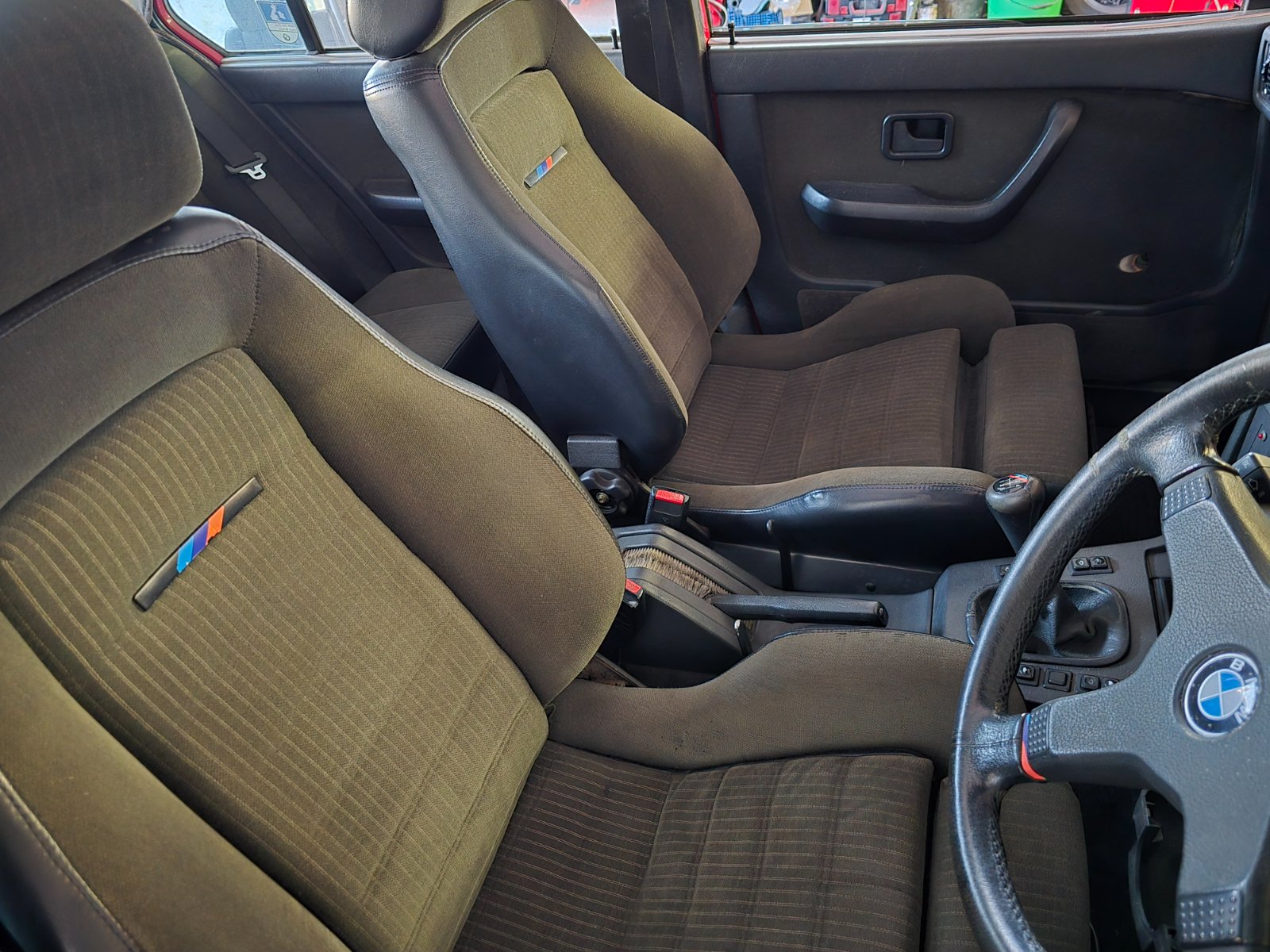

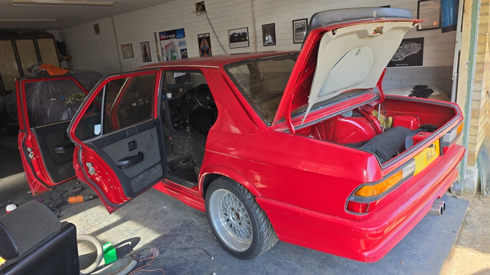

Picked her up yesterday. First things first pulled everything out and fitted the recaros. Also found some OE mats in the boot as well as some original paperwork. Latch buffers were all missing luckily i keep plenty of these spare. Lots of history on the car which is nice. Odometer was changed at 127k to one reading about 163, so car has done about 35k miles less than I was expecting which is a result! Paint has also started to come up a treat

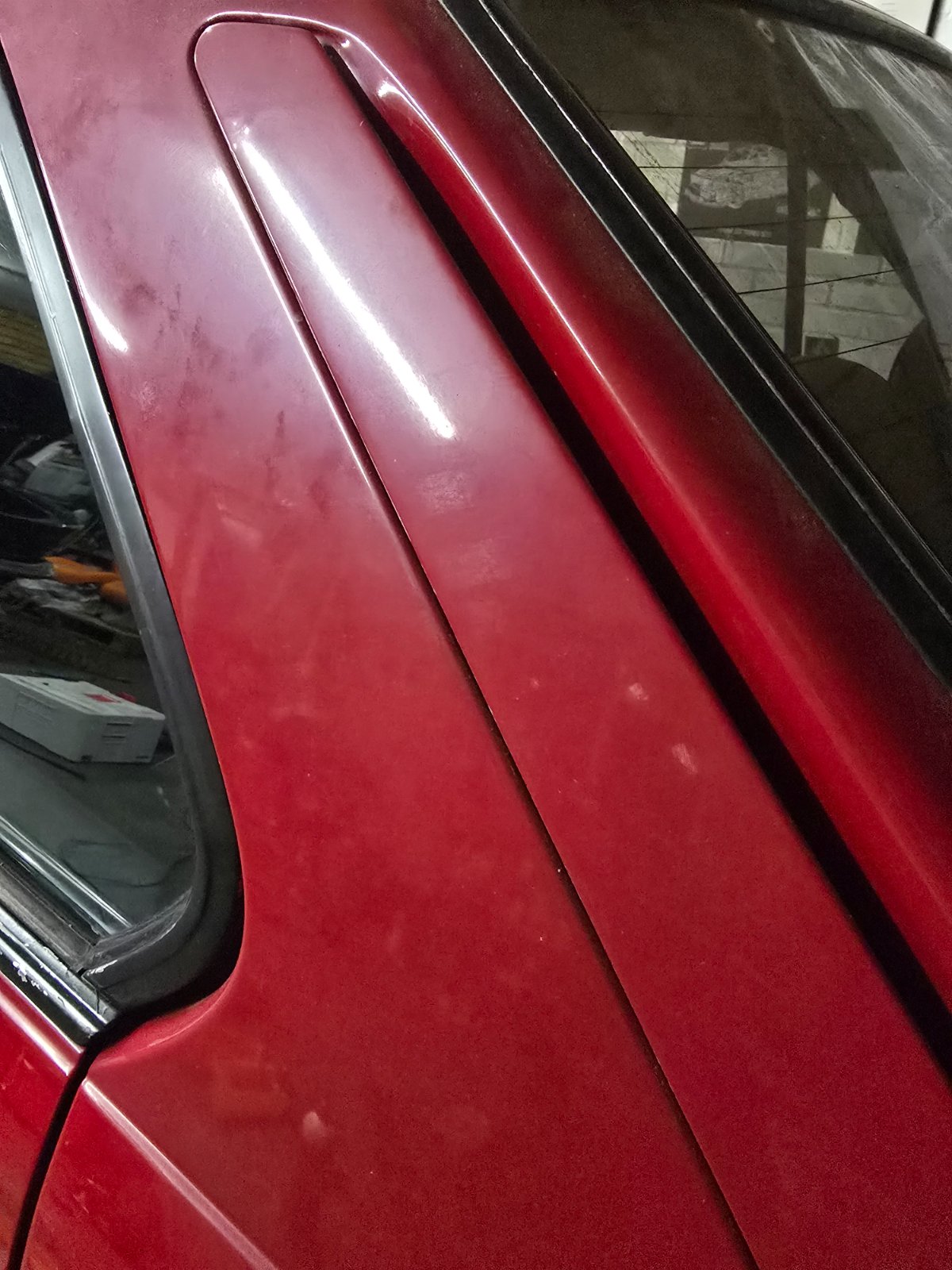

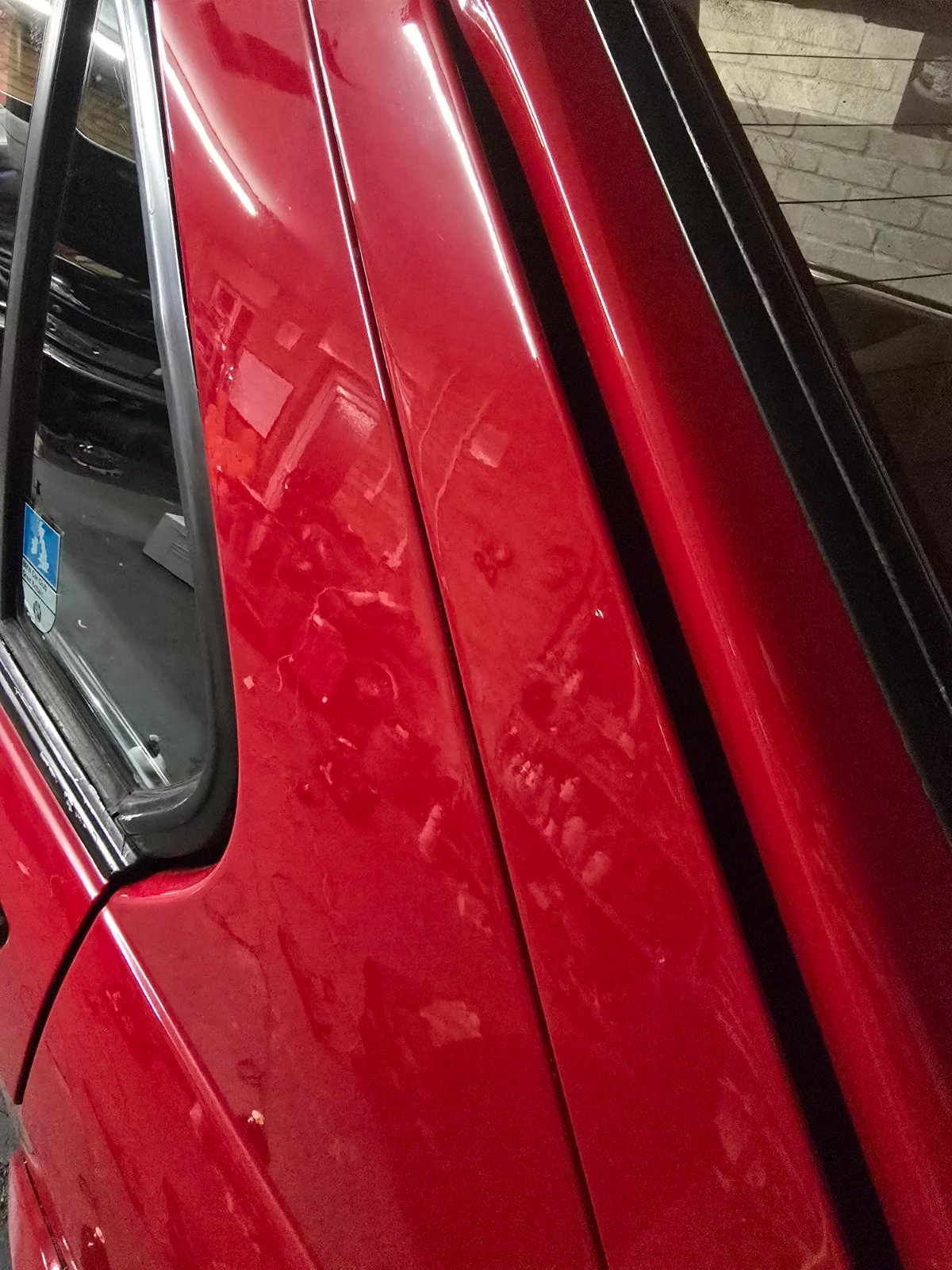

One turd polished for the most part, side window trims need to be repainted, although if anything like e24 trims best to just leave it in place. Will also need to get some screen inserts

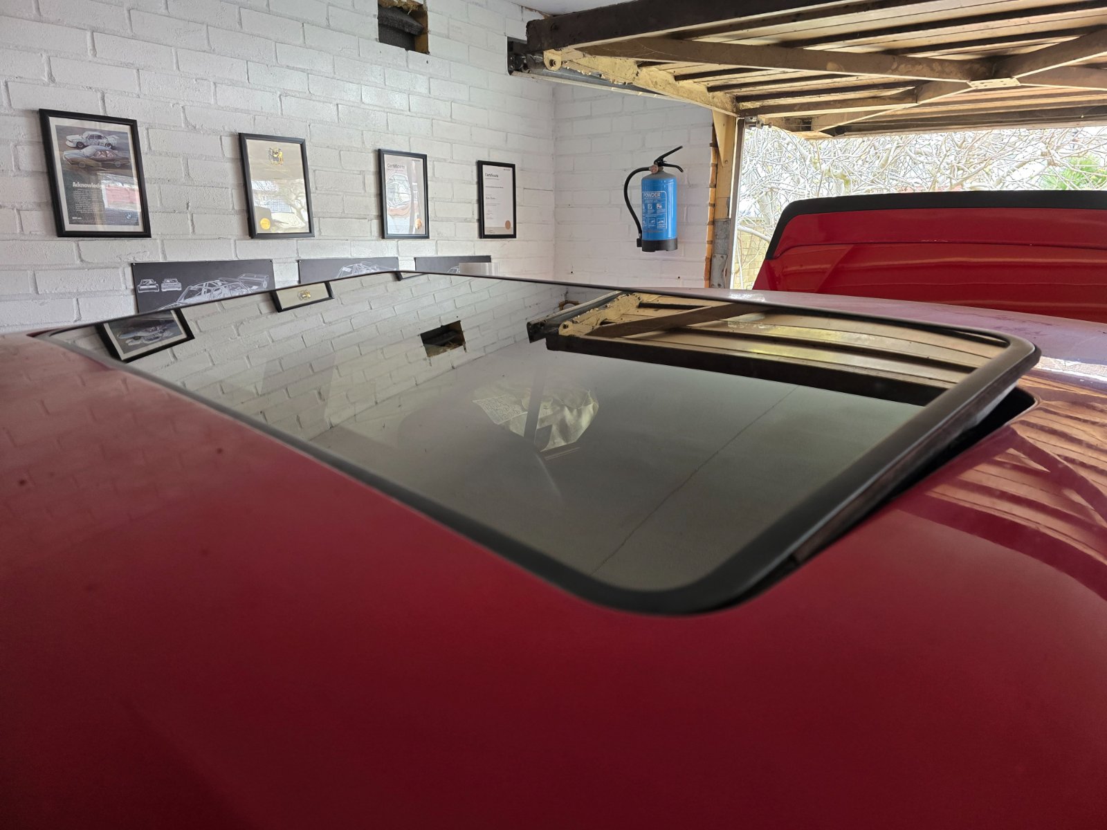

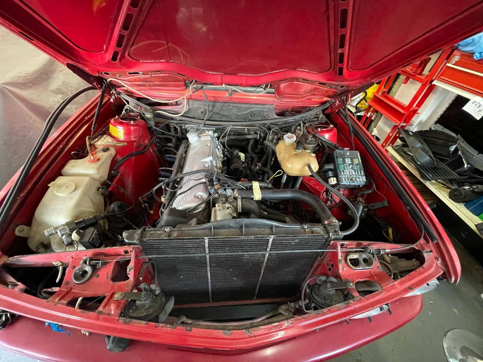

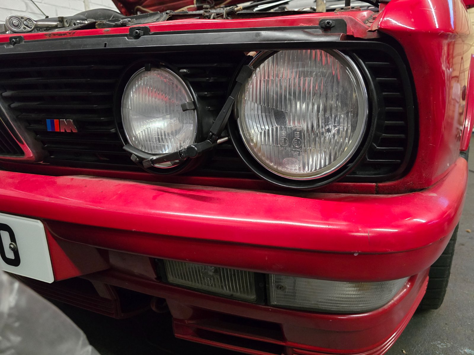

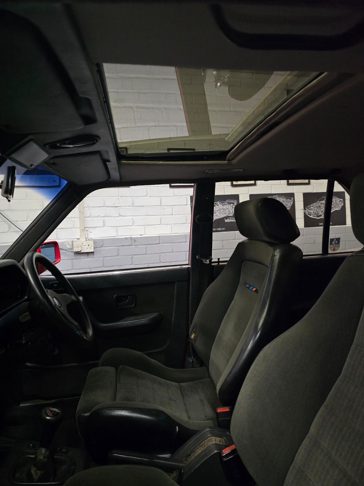

Friend of mine offered me a moonroof and couldn't say no! Changed most of the coolant hoses just waiting on a few that weren't in stock at bmw. Also changed all the fuel hoses in the engine bay and cleaned and refurbed the injectors. 5 were dead and one was dribbling. After a few runs on the ultrasonic injector cleaner got 5 working. Luckily found a NOS injector, so got the intake back on.

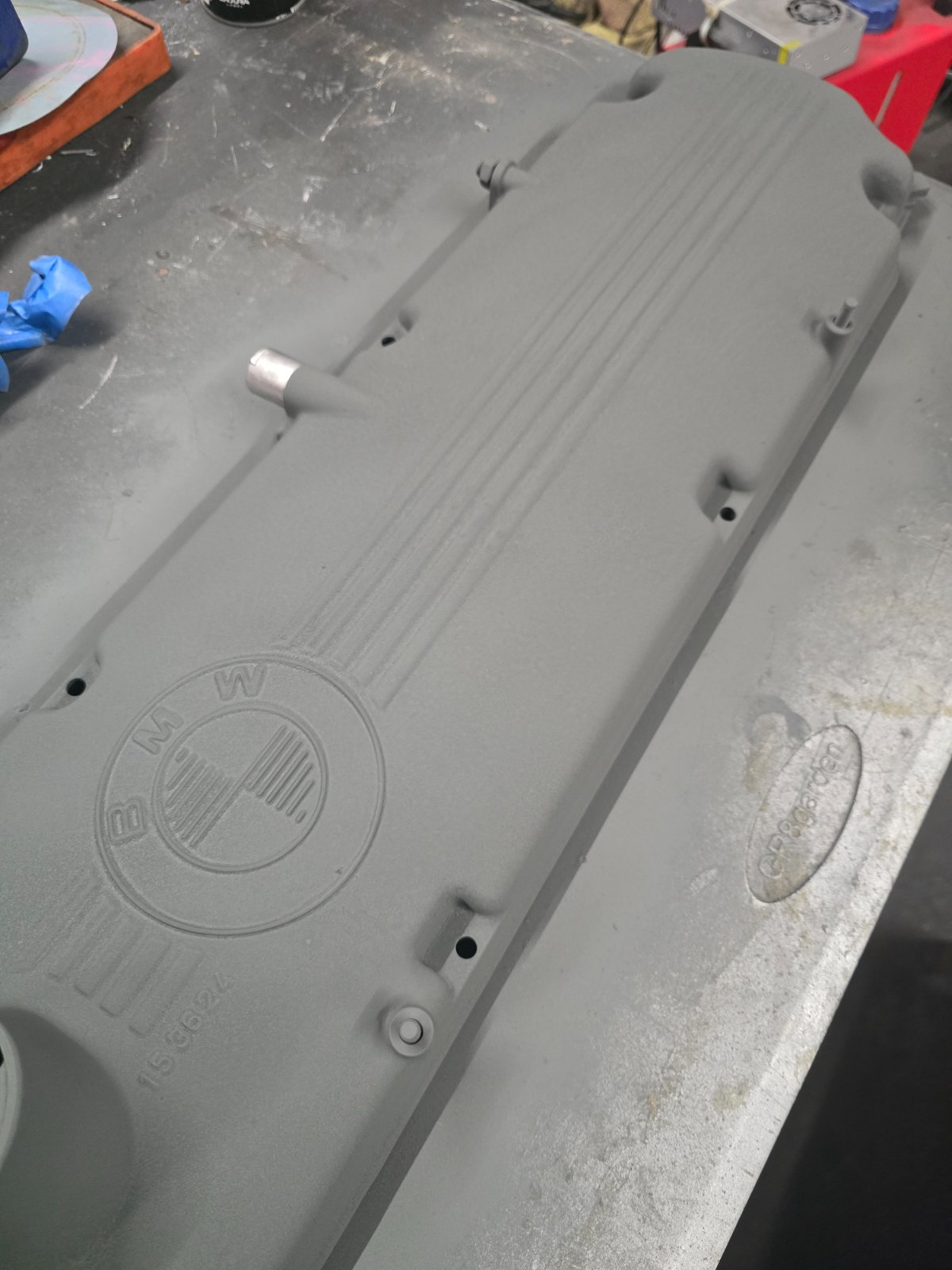

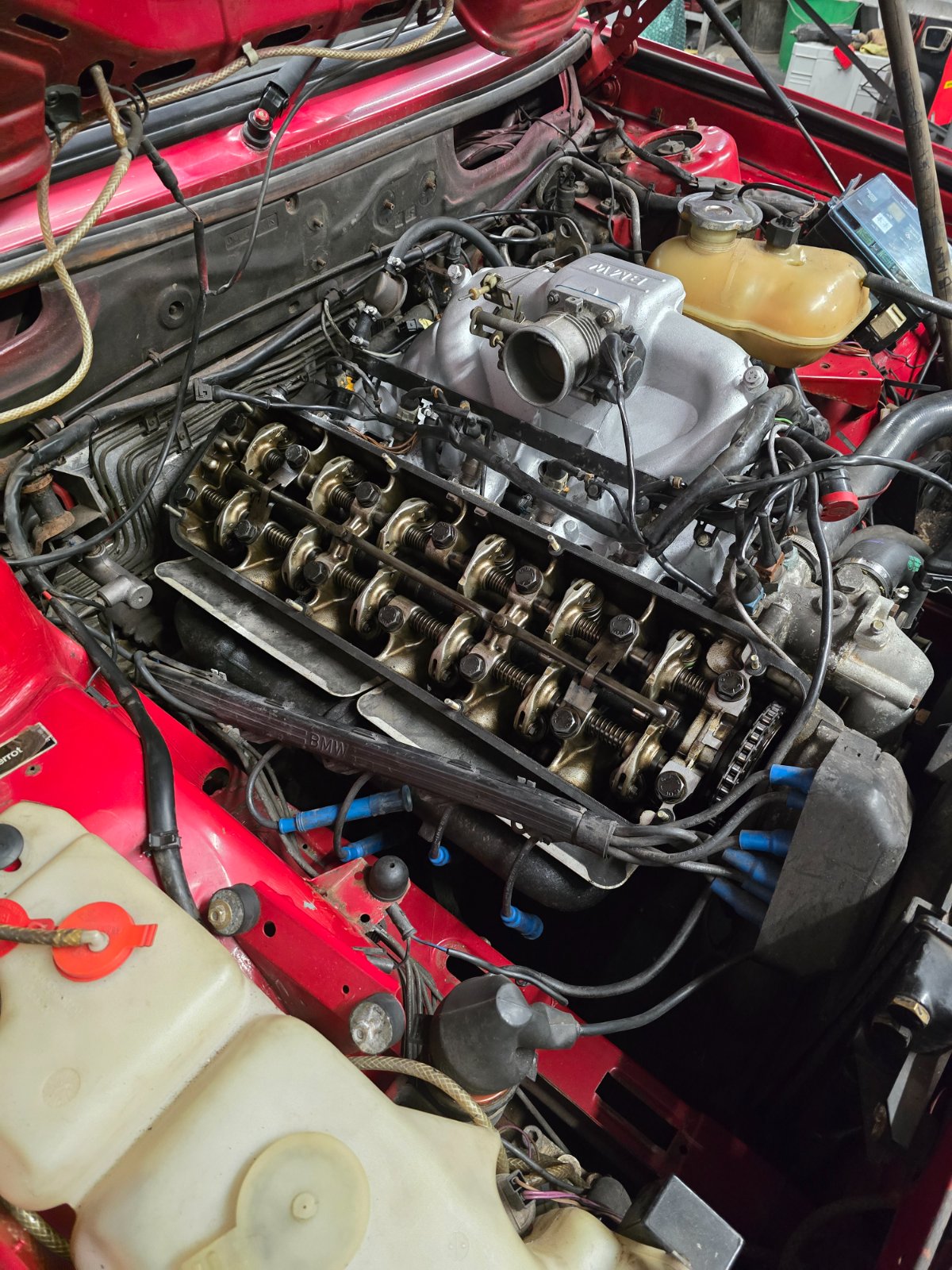

Rocker cover off to check valves which for the most part were in spec. Also replaced banjo bolts and gave the cover a lick of paint. Sandblasted and painted the wiper arms and headlight wipers and got them on.

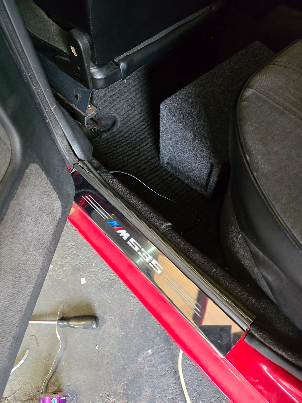

Was also given these back-lit stainless sill covers. Unsure if I will have them on or not.

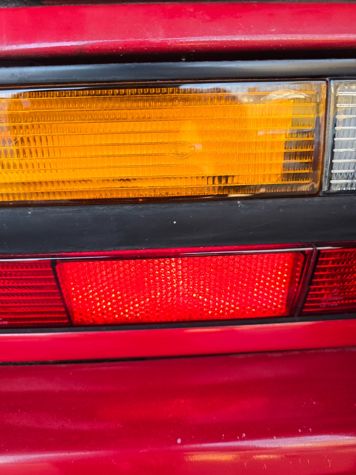

P.S the clear turn signals will be going and Ambers back on!

Nice work! All great maintenance items to check off, plus some cosmetics. Glass moonroof is nice - is it a SAAB piece? They are a direct fit for E28's.
Yes it's a SAAB one. I had a genuine bmw one saved for years to one side then sold it as I wasn't planning on getting an e28! It came with a bmw sliding cover which I recovered in the cloth removed for the original headlining panel

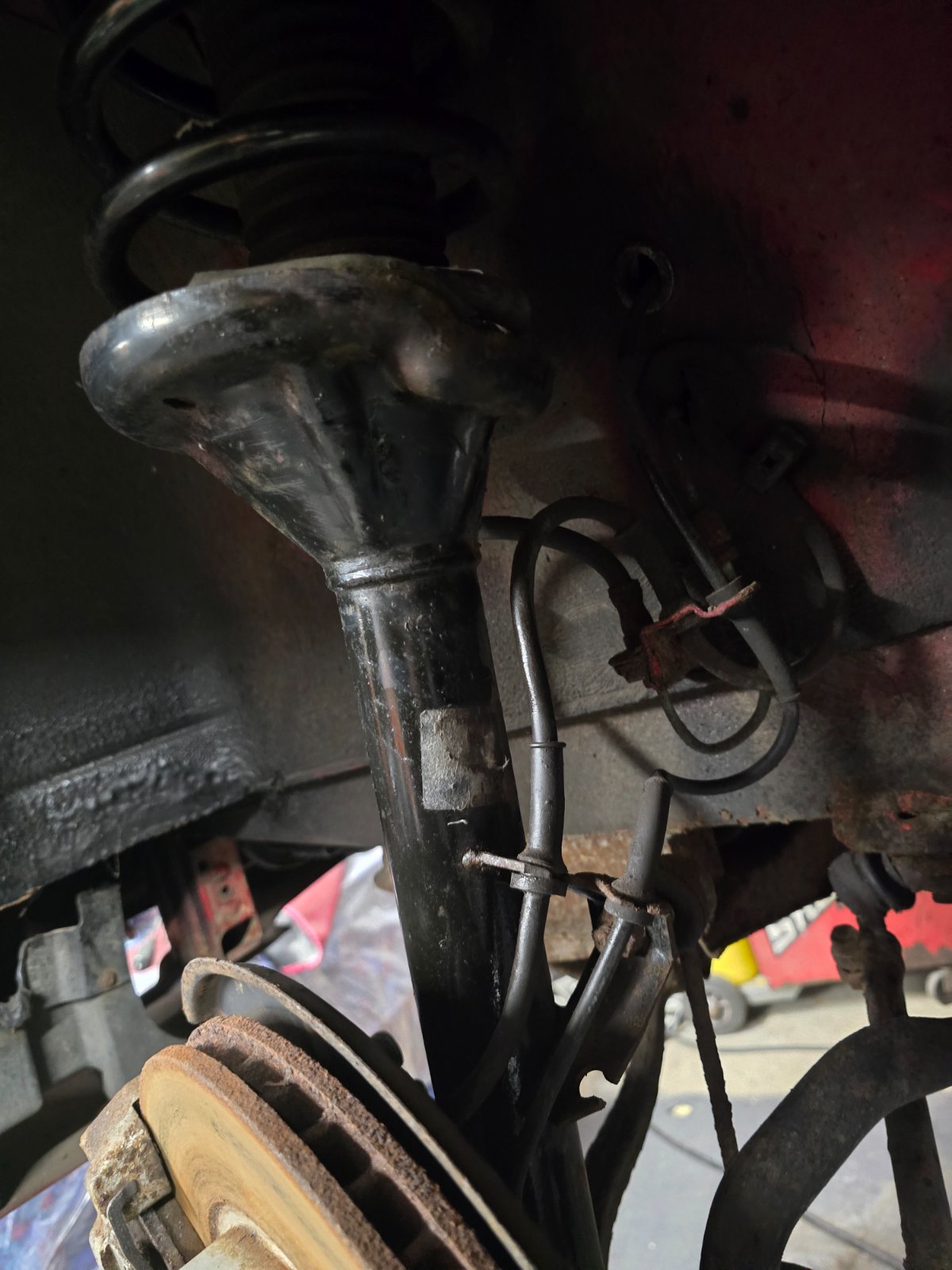

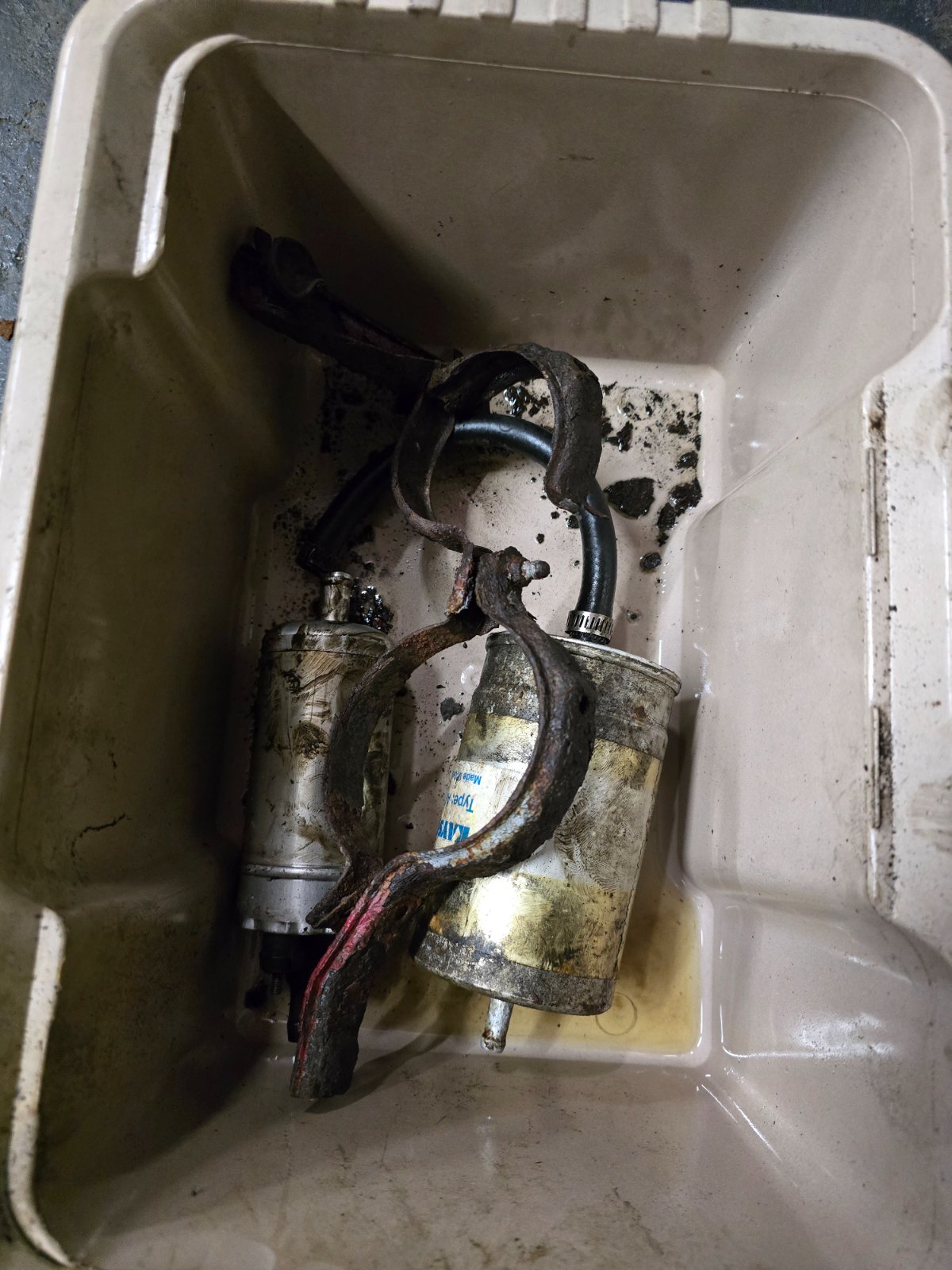

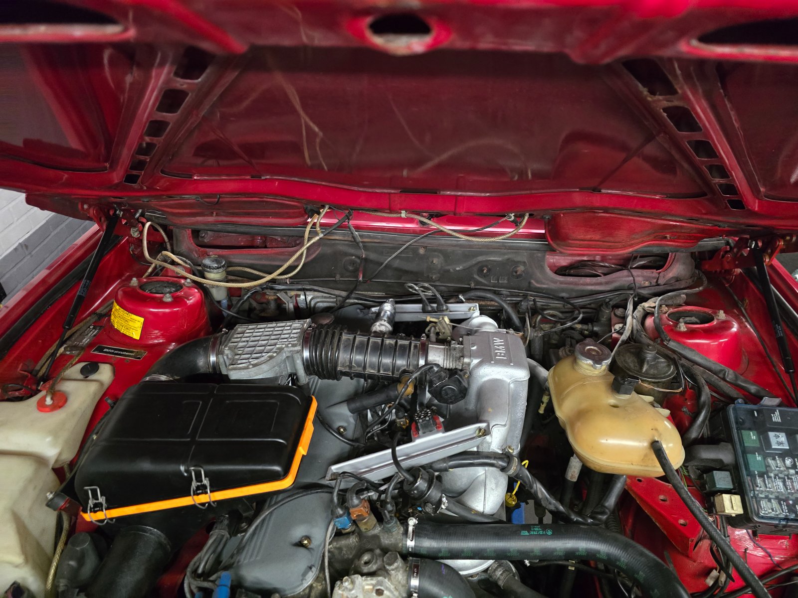

Engine bay is all put together now. Painted up the airbox too. Got the car in the air to sort out the fuel pump, noticed that it has some brand new abs struts on which are a gold mine nowadays! Original pump in the bin although at least the filter doesn't say made in West Germany! 35l of stale fuel drained out the tank but luckily it looked in great shape on the borescope. New bosch pump and filter and new brackets/hoses from BMW. Just waiting on rubber mounts then can fit it all up, throw in some fresh 99 octane and fire it up!

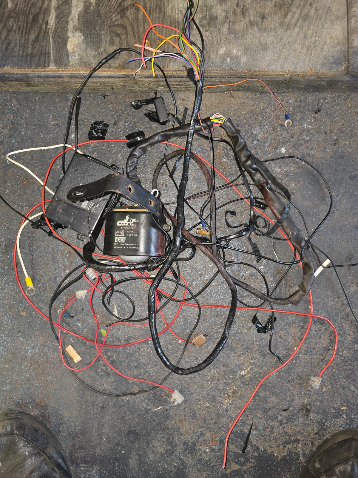

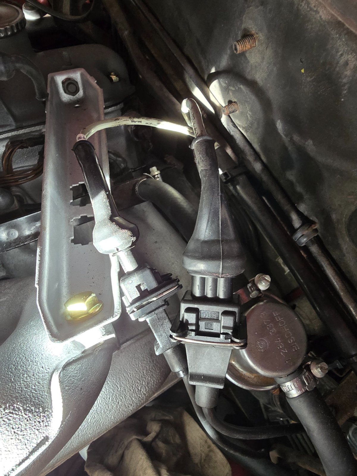

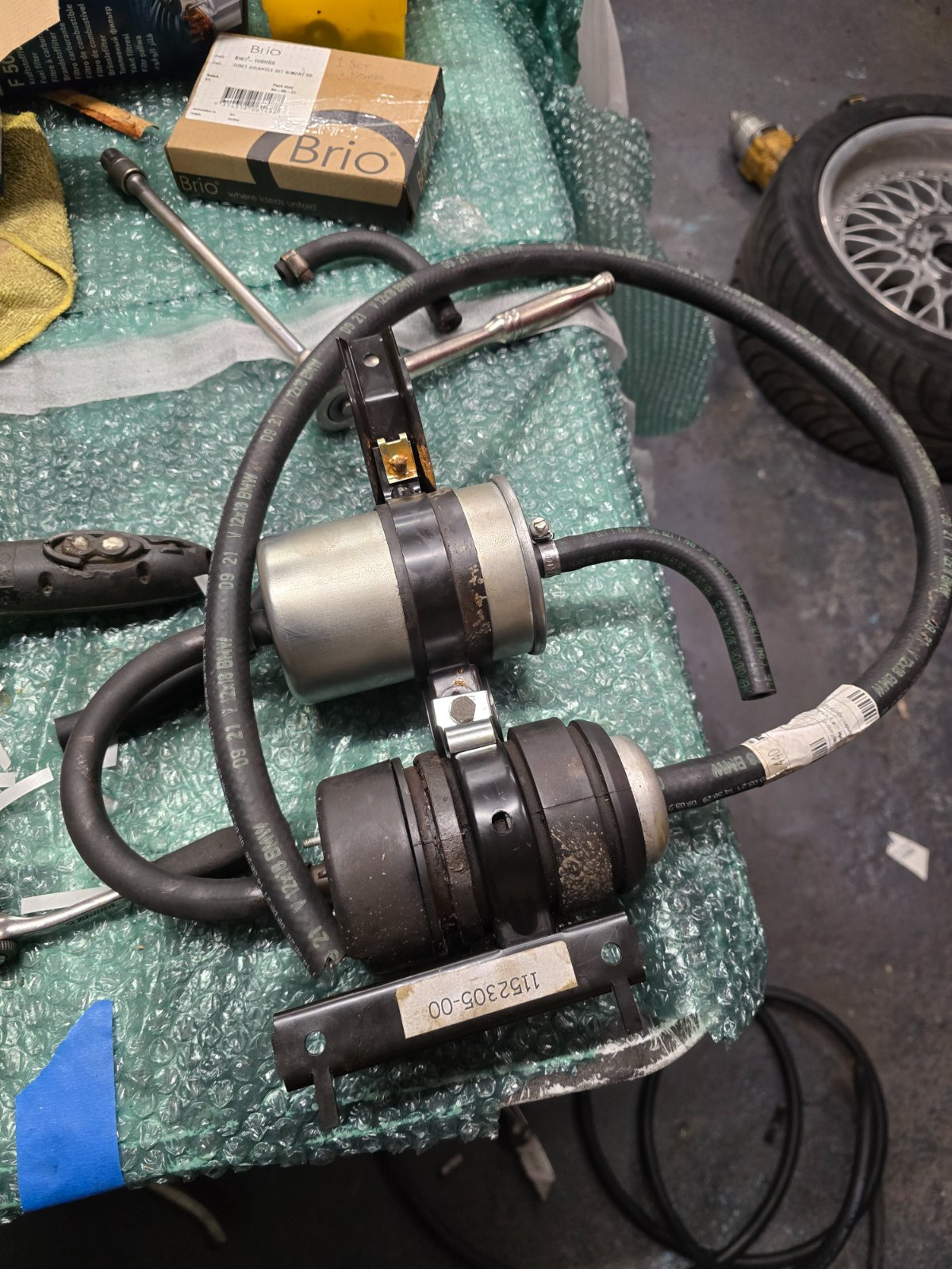

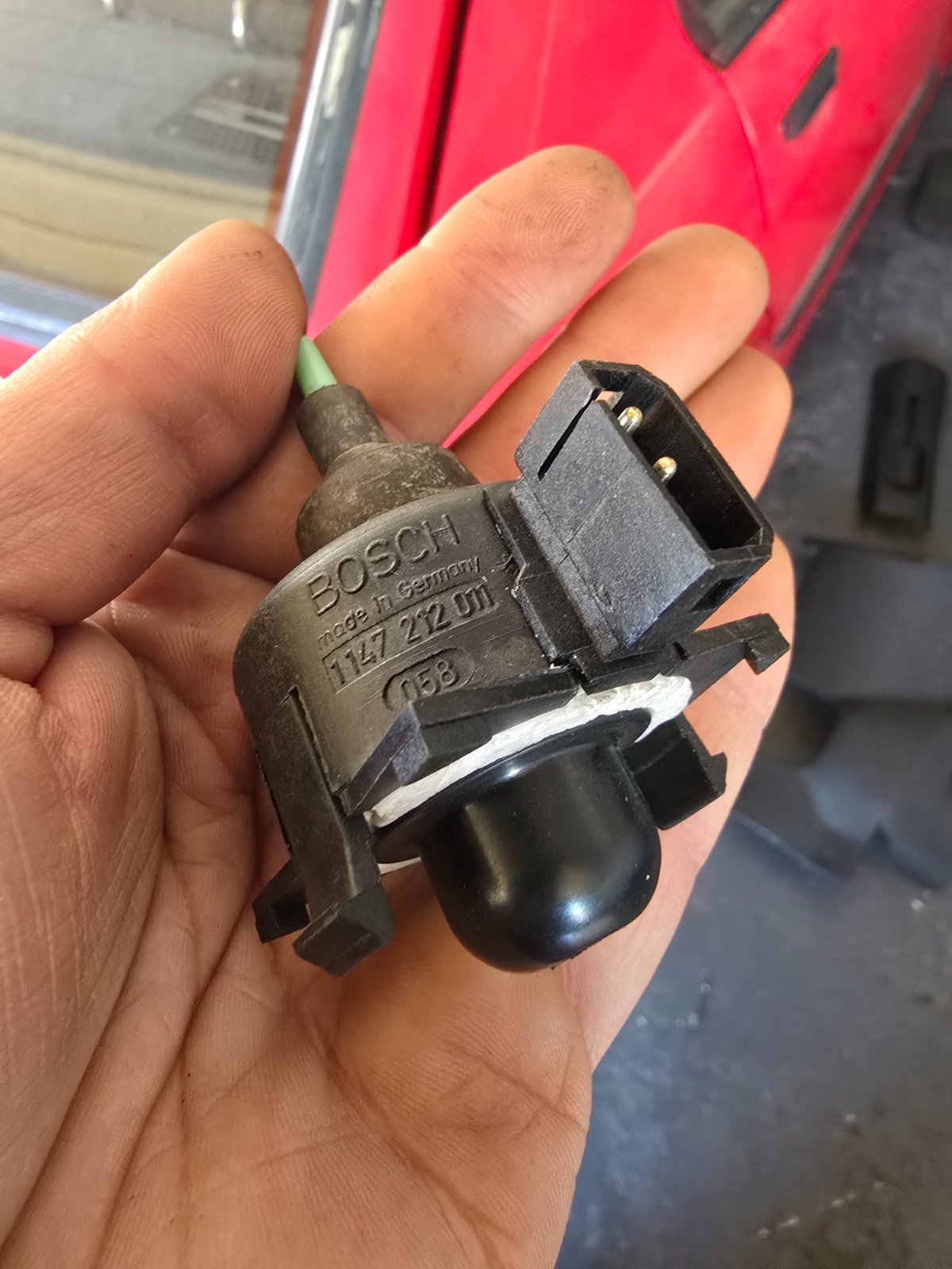

Quite a lot done but unfortunately not many photos! Fitted up the pump and car wasnt cranking or priming the pump. Removed the 90s alarm and connected everything back to stock. Still nothing. Pulled the ignition switch and managed to get it started. For some reason the switch doesnt travel all the way whilst fitted in the car.
Eventually got the car running albeit very rough. Lift pump was also toast so jerry rigged a spare facet carb pump to act as a lift pump but still no joy and especially once warm car was running on 2/3 cylinders. Hooked up a fuel pressure regulator and was only getting about 20psi at the rail.
Removed and cleaned the regulator in the ultrasonic cleaner, fitted back up and running around 40psi and sounds much healthier. Once the new lift pump arrives will box her all back up.

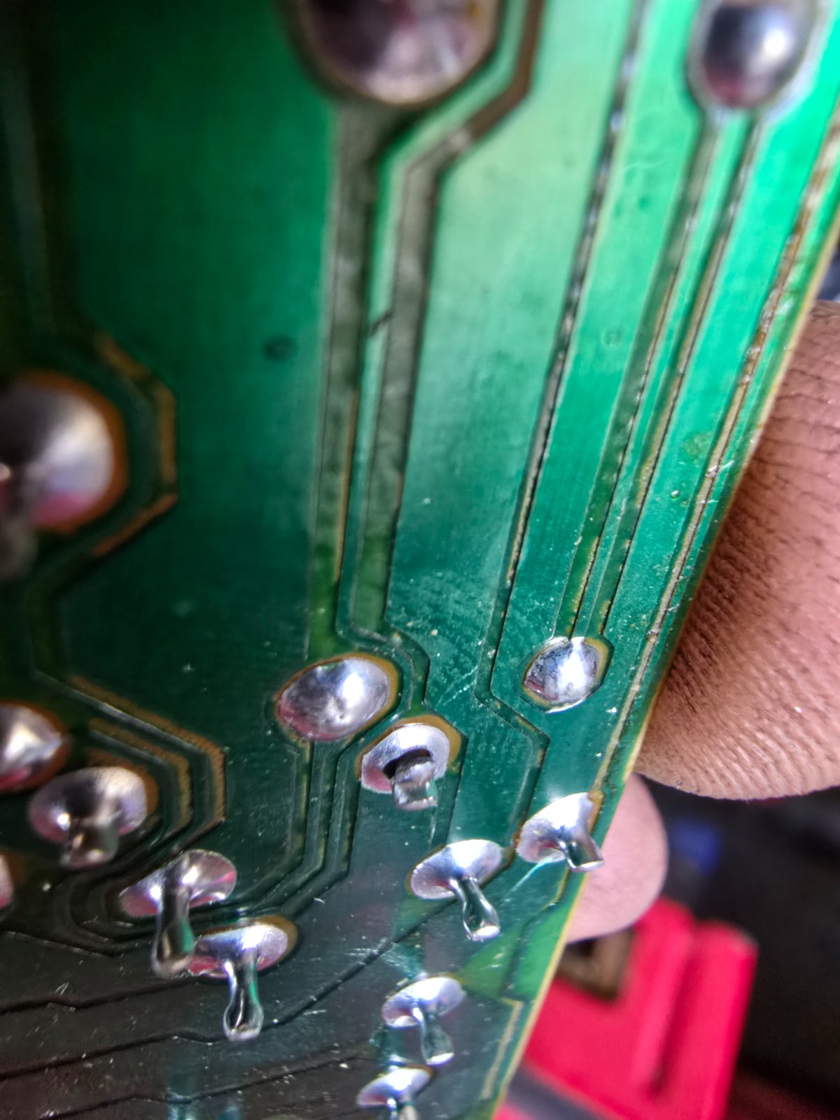

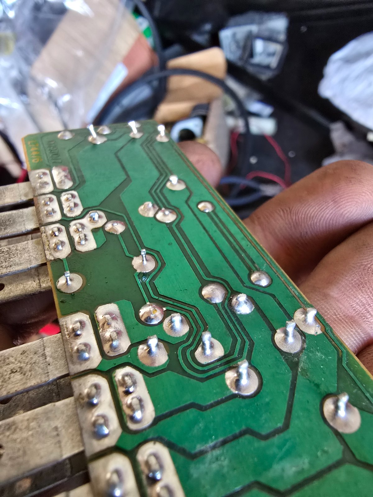

Started to tackle a few smaller bits. Rear sidelight wasn't working, removed the control unit in the trunk to find a dry solder, repaired and all is good now!

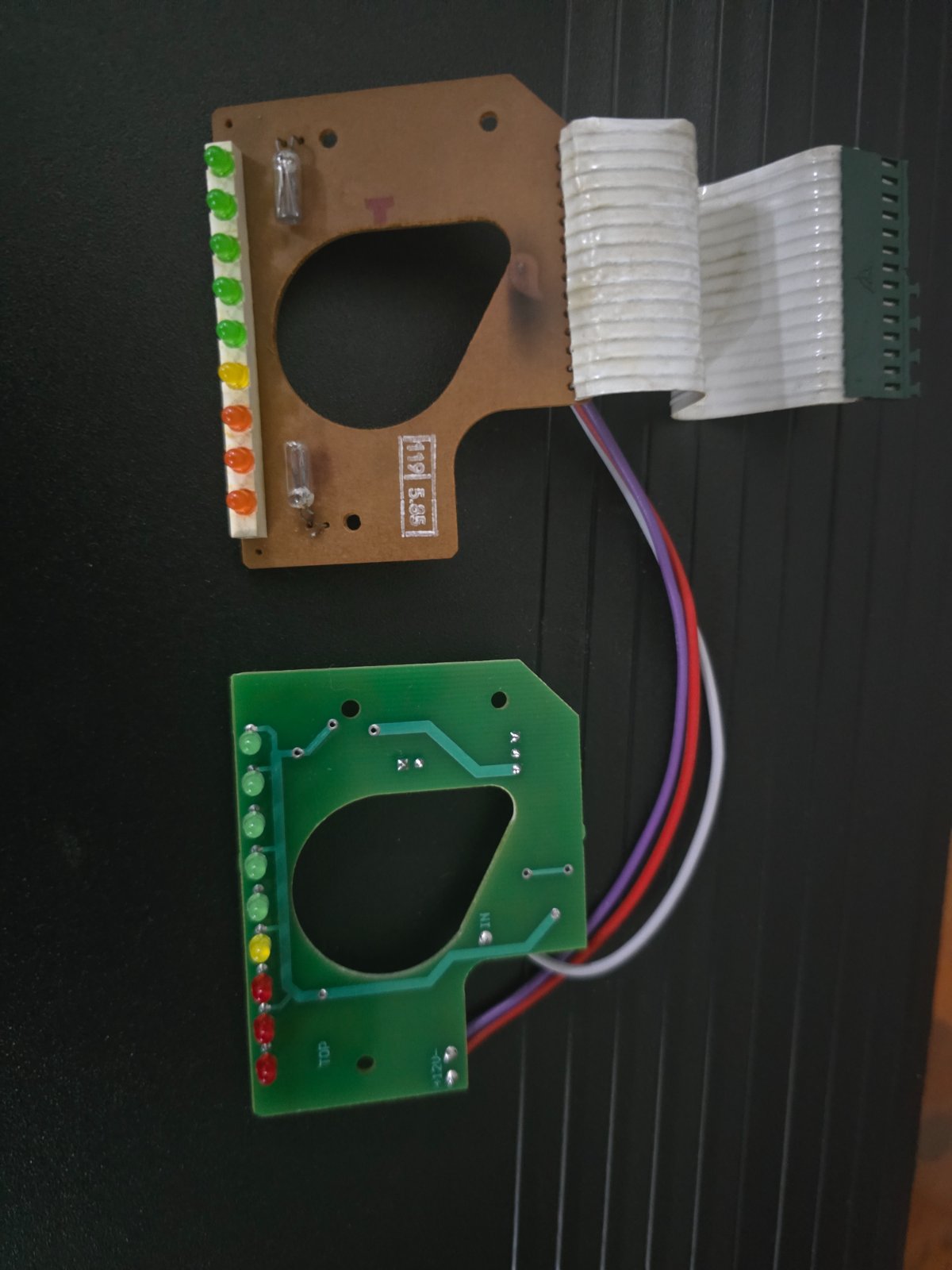

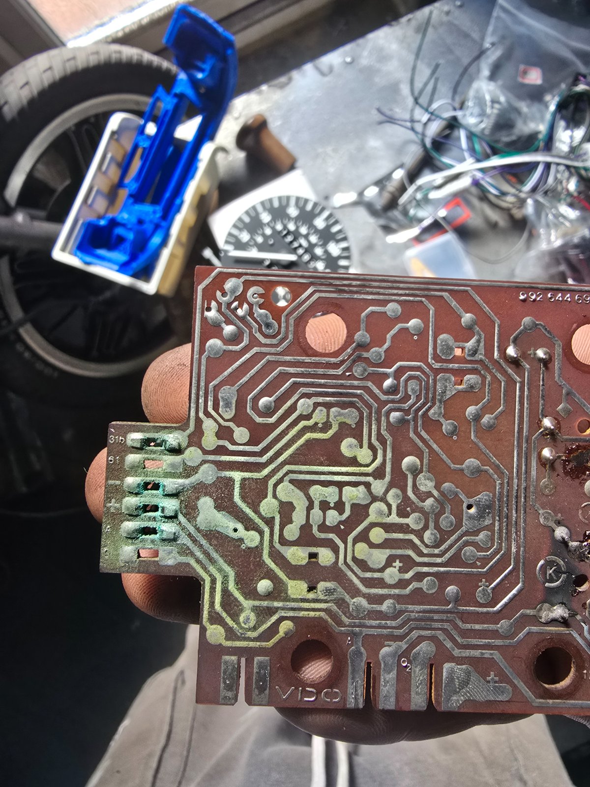

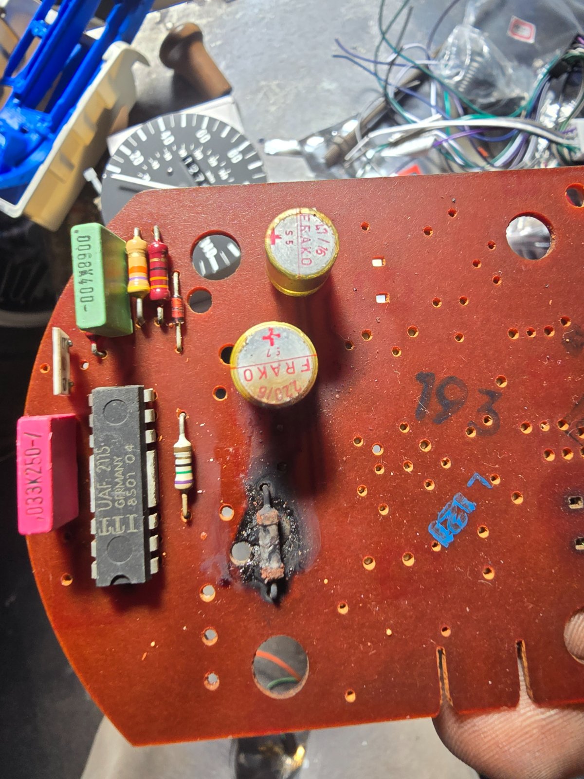

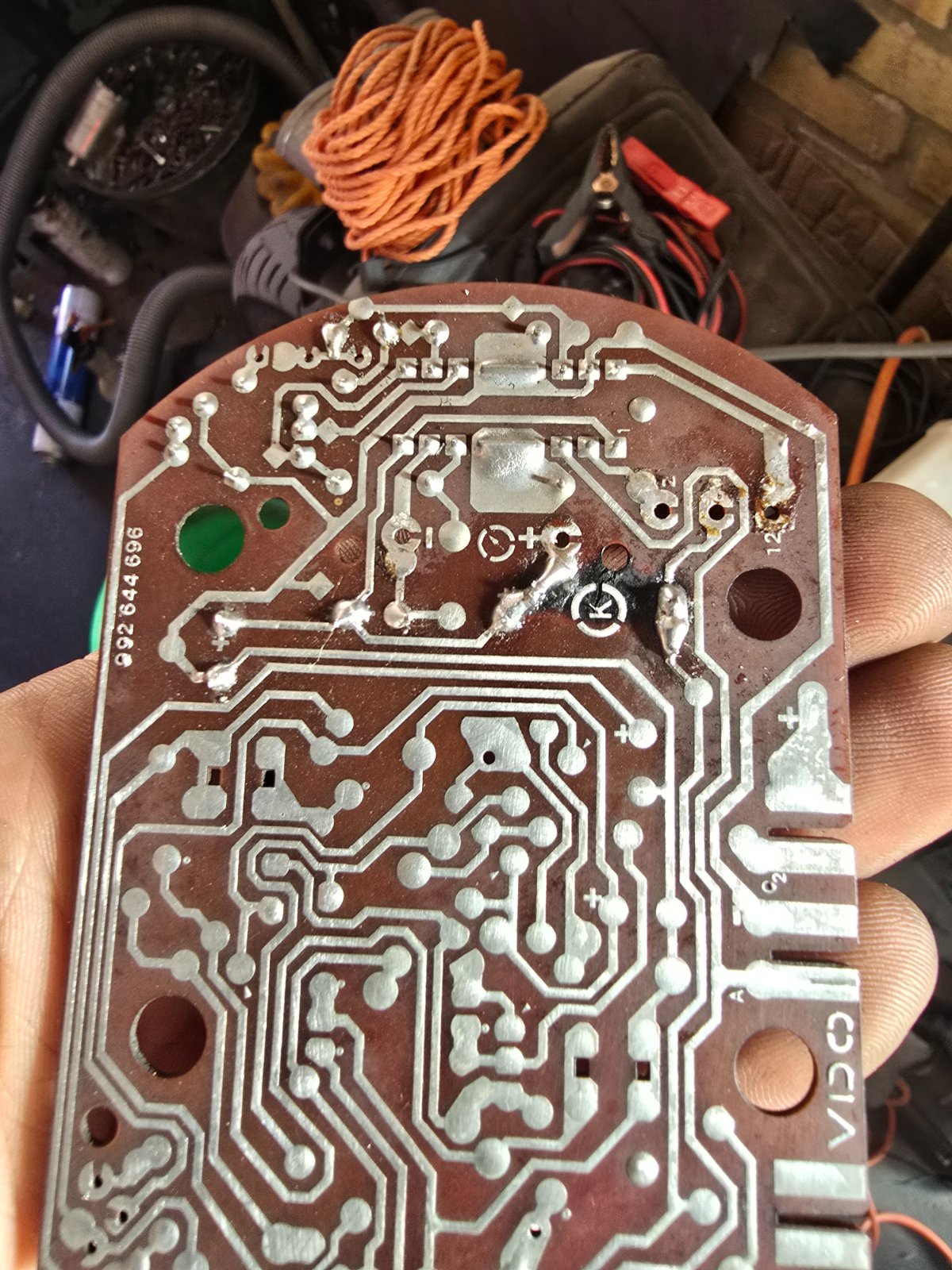

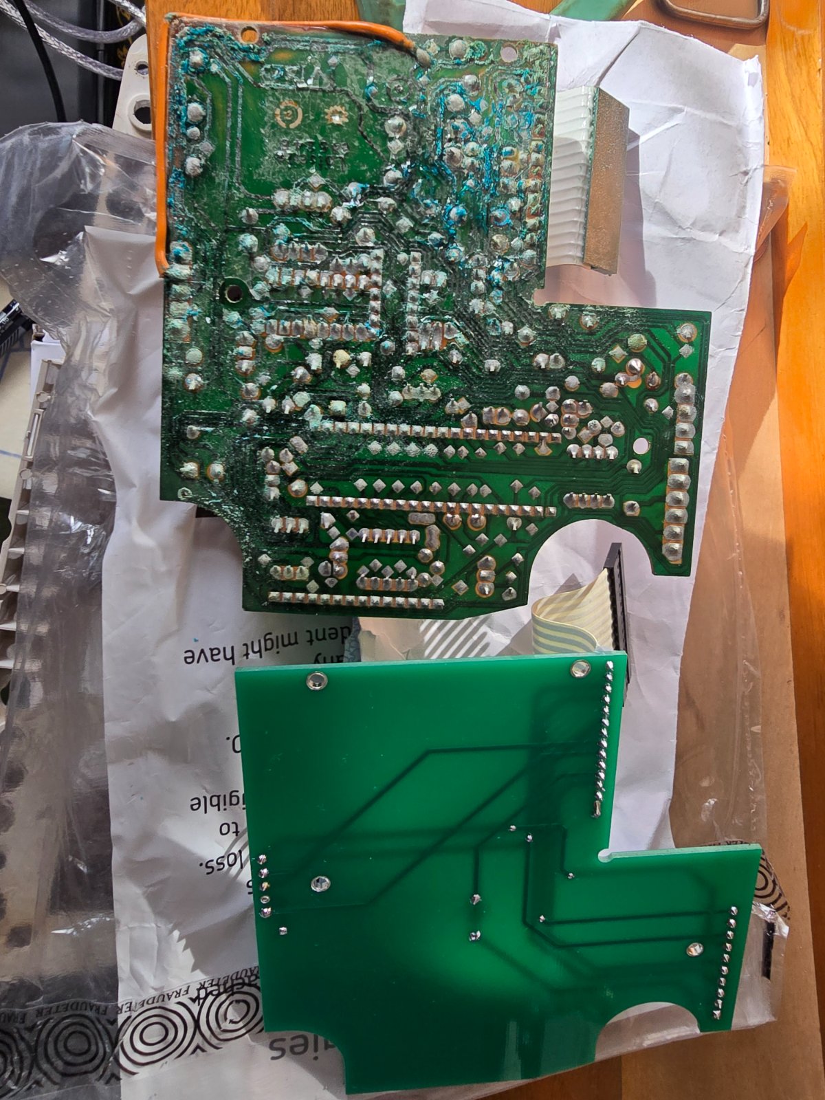

Dismantled the original cluster and the SI board is completely toast so waiting on a new board to arrive and will reassemble. SI indicators will now serve as shift lights.
Have also made a start on pulling remnants of old audio installations, plenty of wiring has been hacked about so will need to spend a good day or 2 cleaning it all up to a good standard.

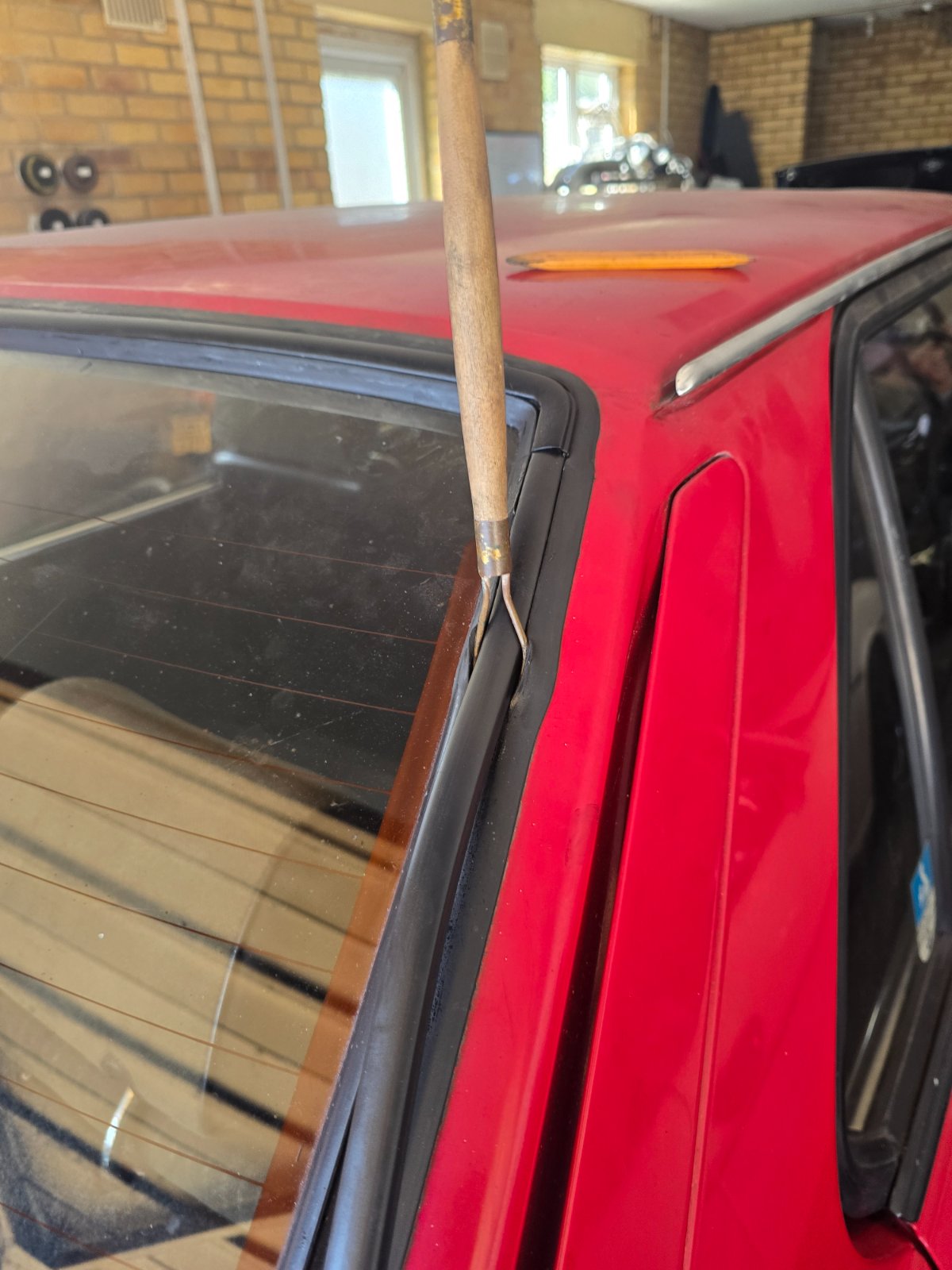

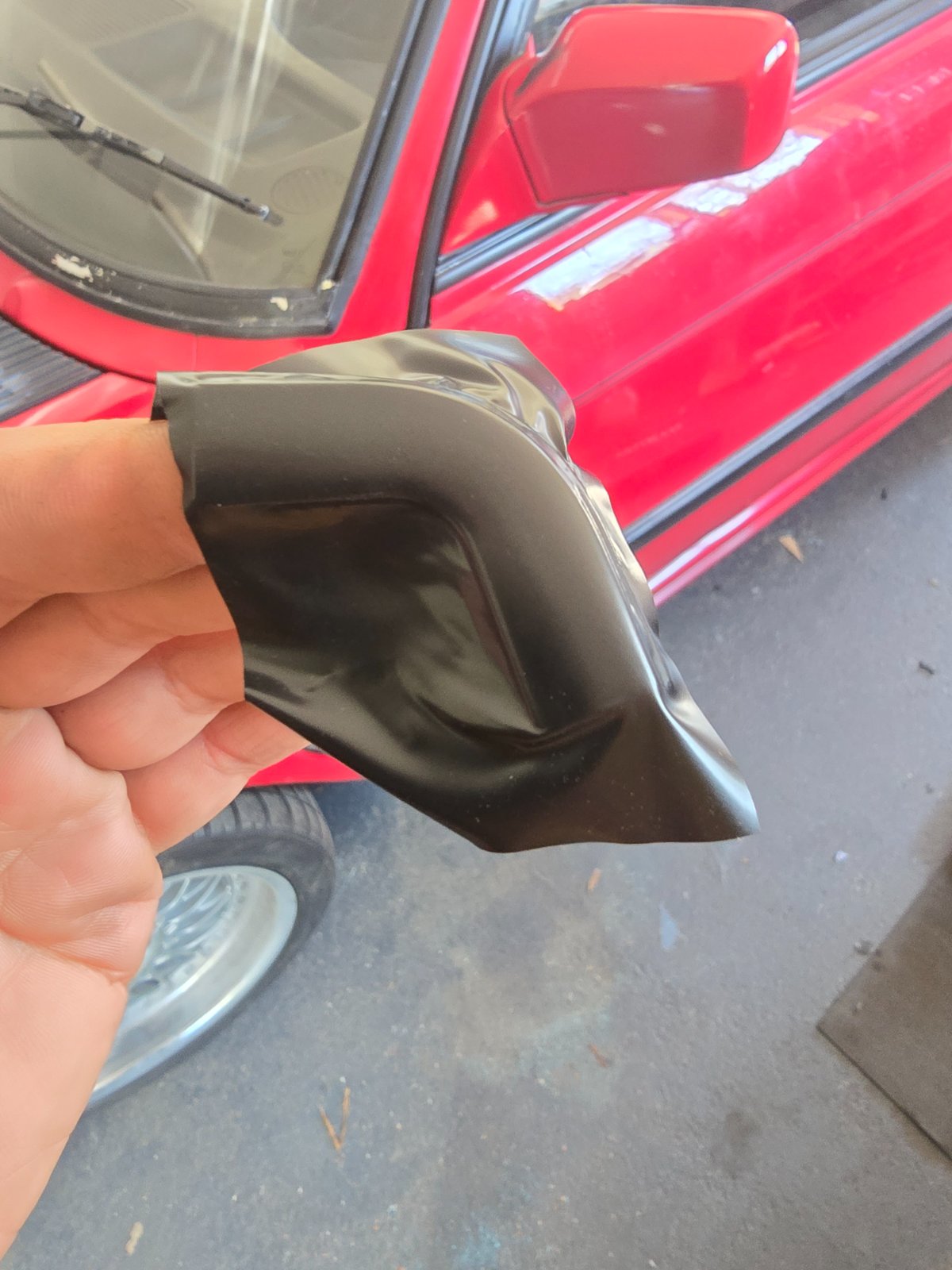

Continuing warmth the many small jobs, some new windscreen trims and wrapped the corner pieces. Still have the large bottom pieces to do front and rear.

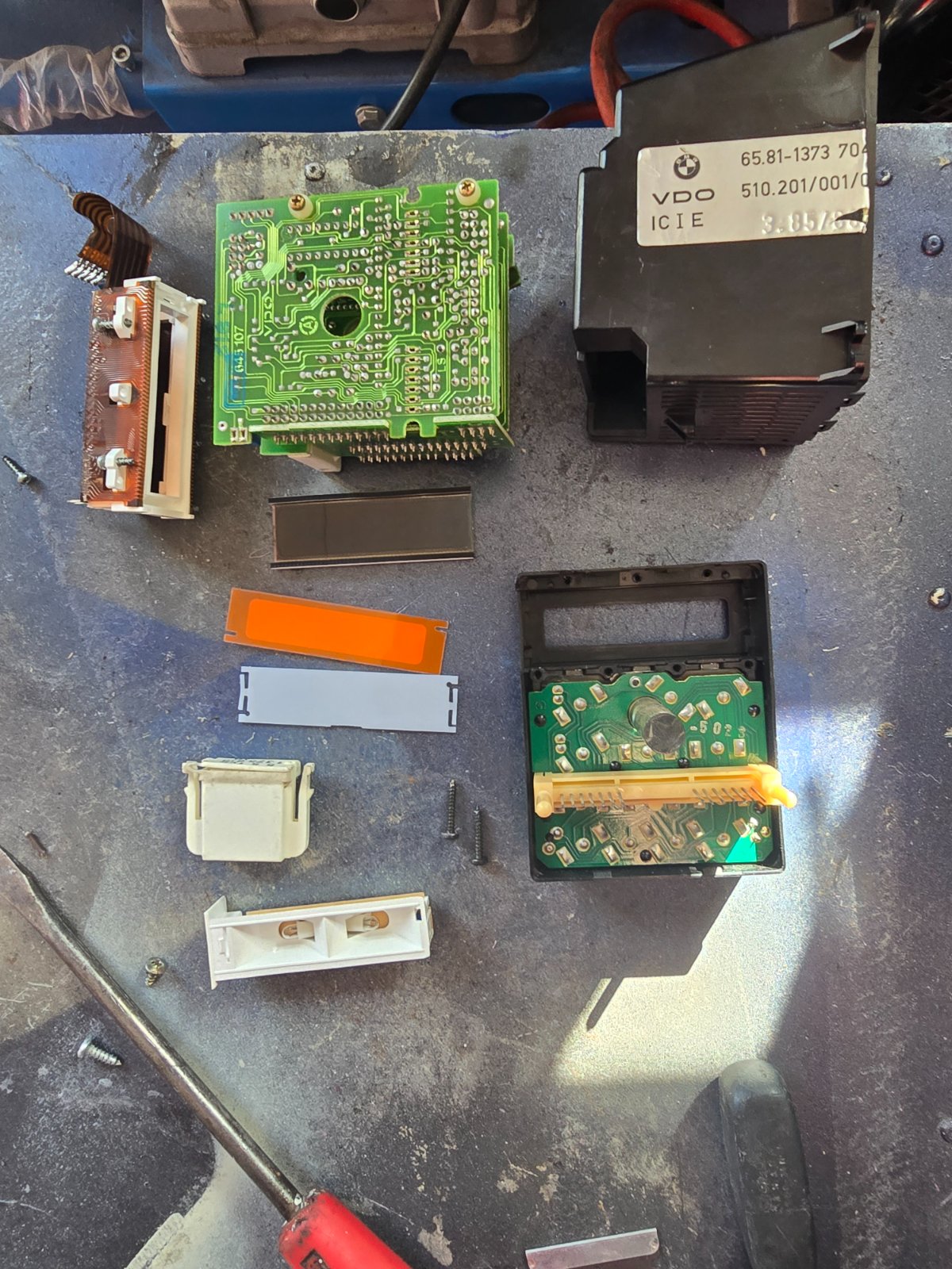

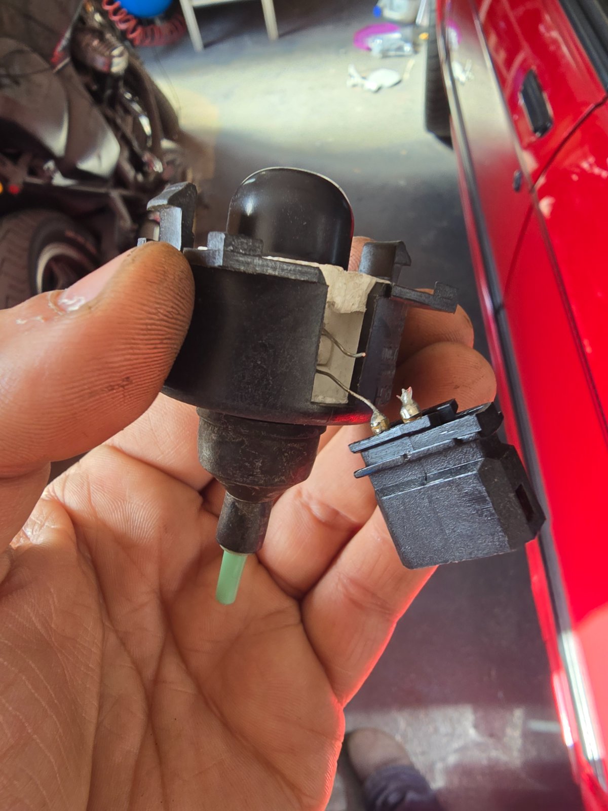

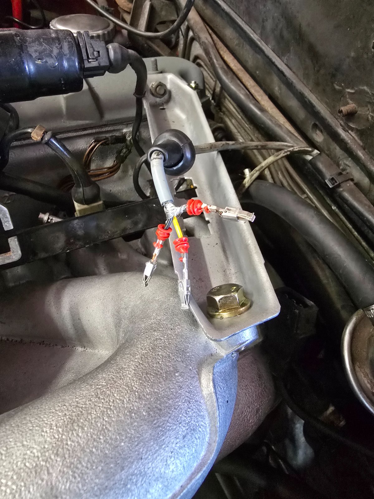

Fitted a new LCD and LED backlight into the OBC and repaired the damaged internal temp sender. Retaining clips had broken off the crank sensors so they weren't seating firmly. Fitted new AMP connectors but the factory holder does need to be massaged with some hammers to get them to fit in.

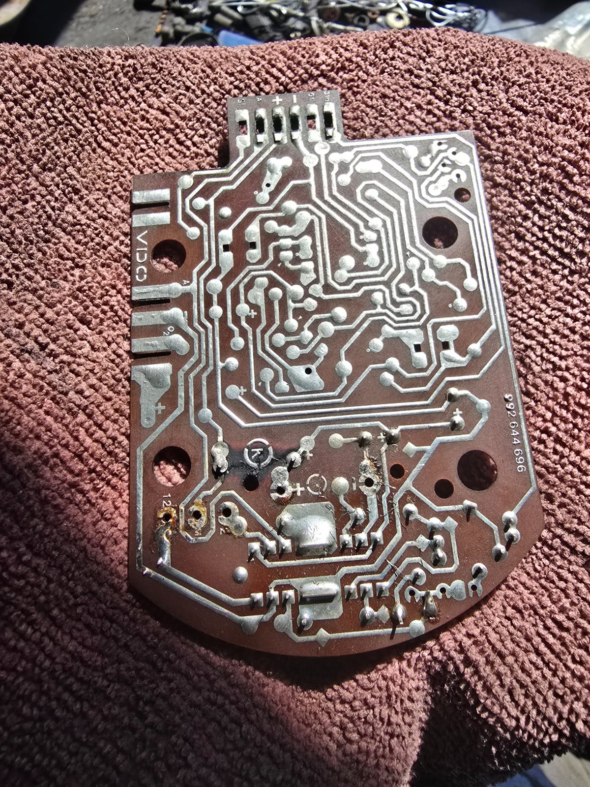

Next I thought I would tackle the faulty cluster. The replacement cluster had also leaked acid out of the SI batteries but being the later type are harder to fix. Started with disassembling the speedometer, cleaning the board and replacing both the capacitors and the blown 33 ohm resistor. Replacement SI board and also a new SI indicator unit that now functions as an adjustable shift light. Mileage amended on the original speedo to the new correct reading and the tach needle removed and refitted to the correct position. Tach still wasn't working after all this. Tried a few different units and still no dice. Wiring etc all checked out OK, after giving direct coil negative to the c103 connector it suddenly started working so not sure what's going on there but potentially an ECU issue.

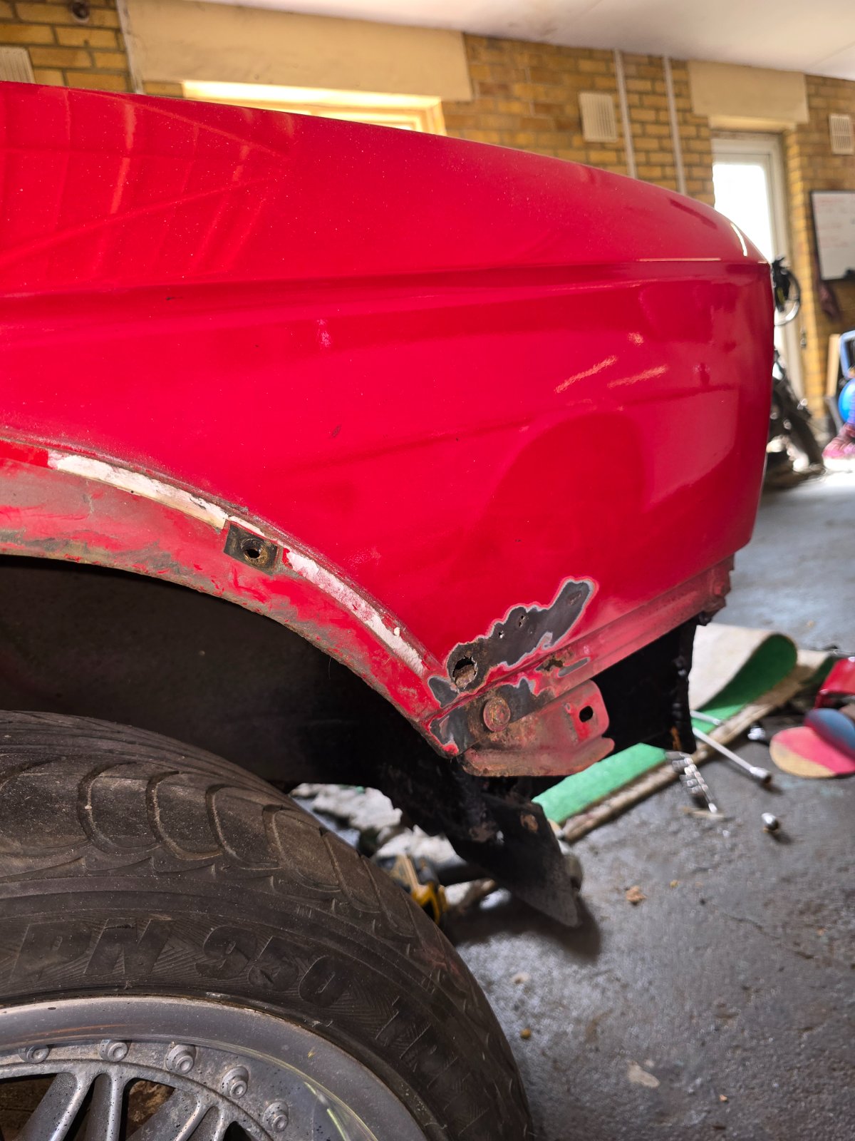

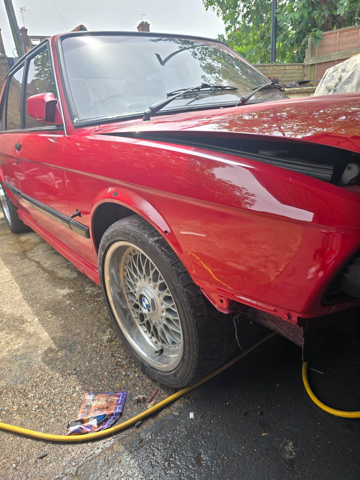

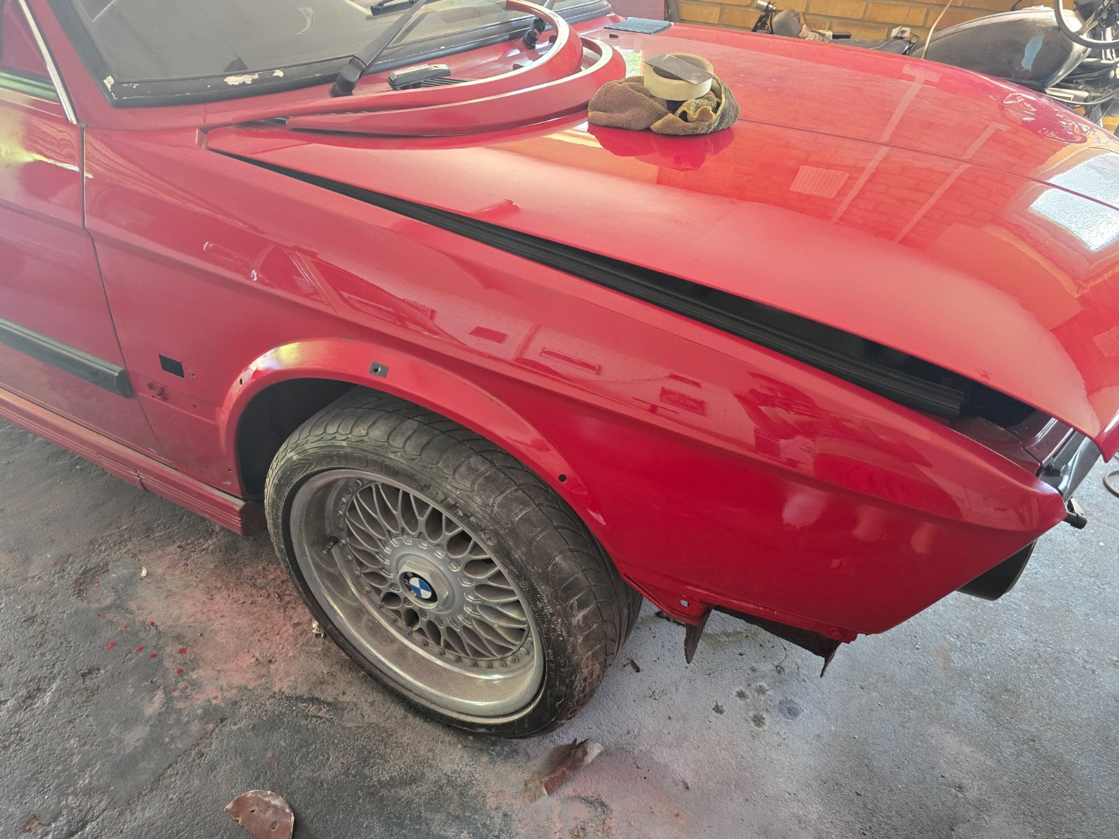

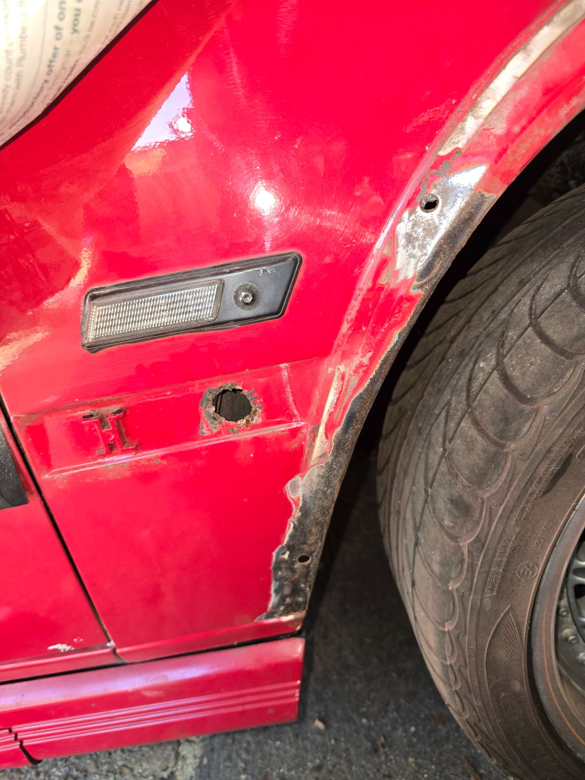

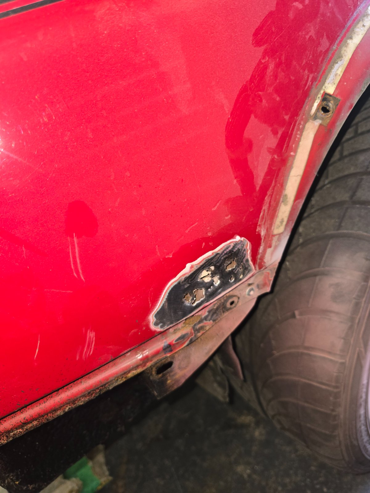

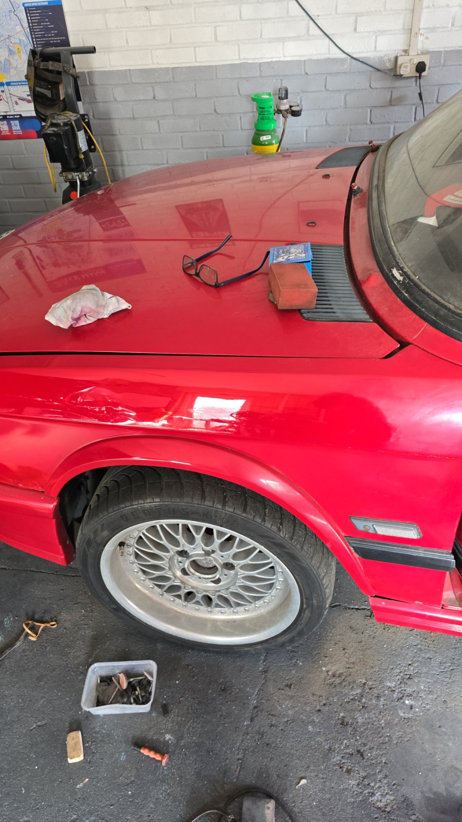

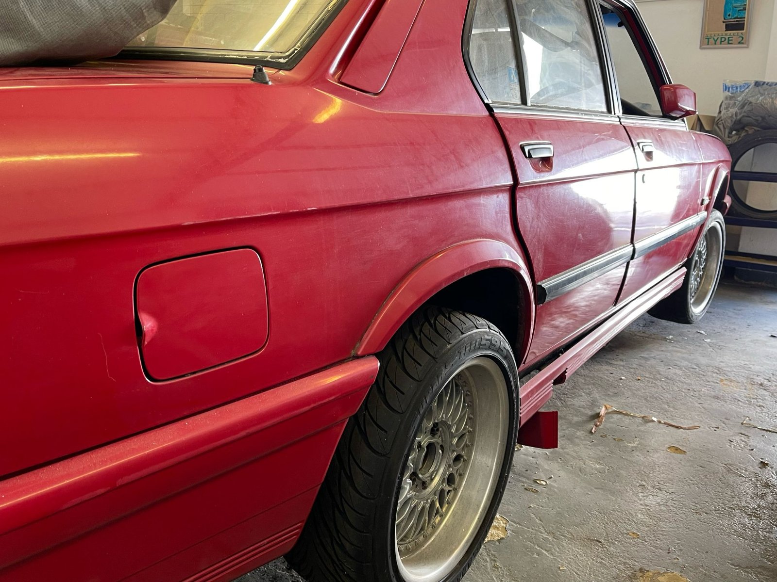

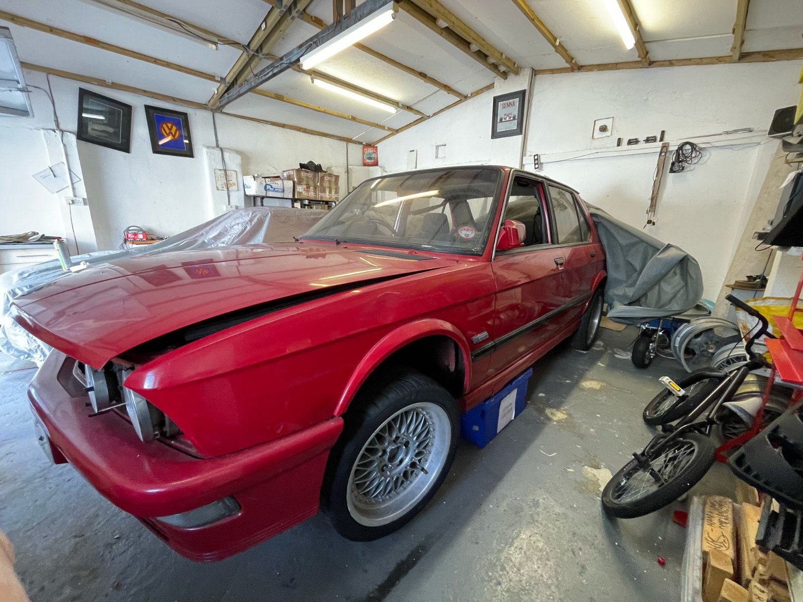

Pulled off the tupperware arches as I noticed a few scabs and also a few holes in the wings. Welded them up and had some zinno red left over from my e24 rebuild so got that taken care of. Also repaired the rear spoiler and repainted as it had cracked quite badly.
Econometer wasn't working but by sheer luck managed to snag an early M5 tach so got that fitted in place too.
Still need to fit the arches back on, also the radiator needs replacing. Once she is one the road early next year will put on the big lift, drop the rear beam and do all the bushes as whilst the front end is nice and tight the rear is really past its sell by date
