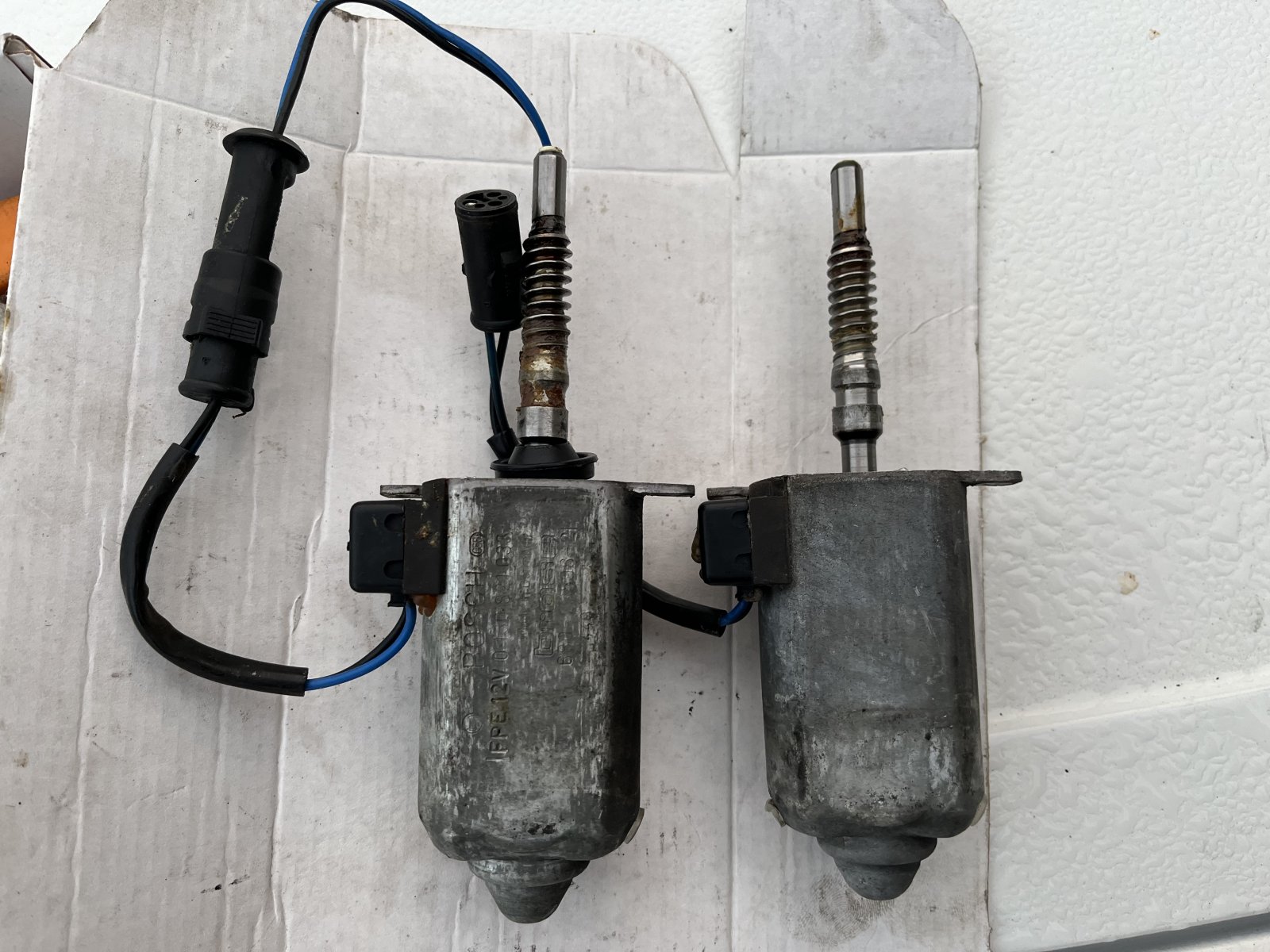

I acquired a couple of E28 rear window motors a while back and one of them wouldn't hit a lick. It's not an item you would return since you won't find an exchange in the 30 days they give you as it's a pretty rare part. So, I got the electric motors from the front windows, leaving the gearbox on the regulator. As it turns out, they are identical, and now I have another set of working window gearboxes.
Front motor on the right, rear motor on the left.

About half right there. Only the rear gearboxes work in the conversion, but the electric motors can be from the front as well, so the same number of gearboxes but more motors that will replace a motor that fails.
Note in my picture that there isn't a gearbox attached to the motor.

I've had two motors that didn't work after I got them home. The gearbox only fits one side, so you need two of them. They have a much lower failure rate than the motors. Having a spare motor would pretty much cover the bases.

The front gearboxes are very different. There might be other versions of gearboxes that may be more adaptable, but I haven't found one yet. I do poke around in the local junkyards quite a bit, so if I find something that looks promising, I'll write it up.
This isn't going to make any more E28 motors, but it will lessen the pain of finding a pair in the boneyard, spending the time to remove them then getting them home only to find that one or both don't work. This happened to me and this is why I wrote this up. You want the unicorn you just found to work.
