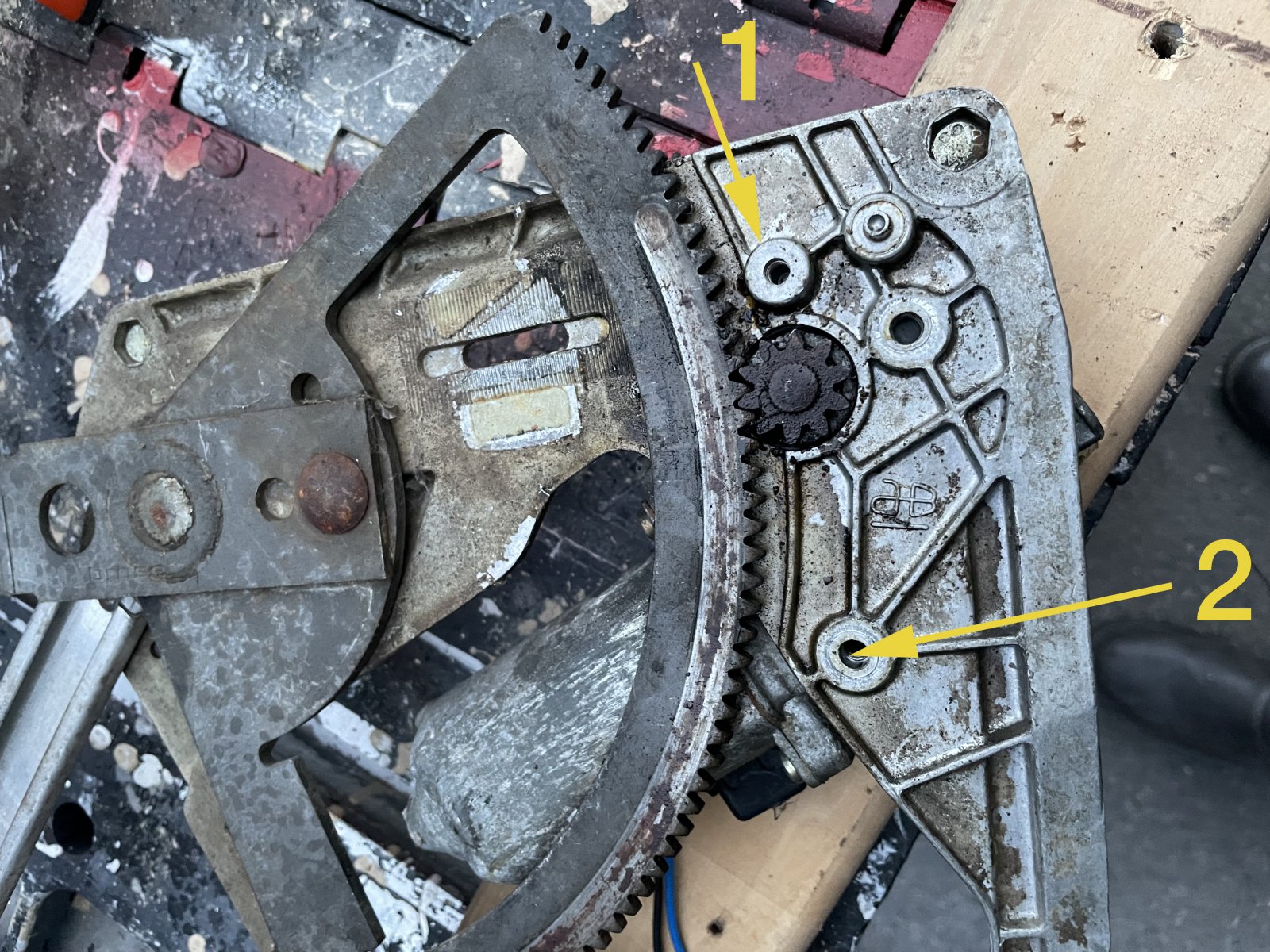

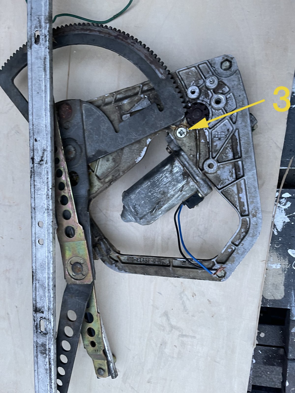

I'm having trouble separating my newly acquired e28 window motor from it's regulator.
True there's plenty of information about installing the e28 motor, but I can't seem to find any info on removing the motor from it's e28 regulator.
Can anyone offer up some info on how to separate the 2?
Thanks in advance.

There’s three screws that hold the motor to the regulator. Undo the screws and then it has to lift off of the regulator. Depending on the position the window was in when the regulator was separated from it, one of the screws might be obscured by the arm.
Thank you. This was it. The 3rd screw was hidden behind the 1/2 round gear sprocket thing (see photos).
I had to wire it up to the car to rotate it, but I had to test the motor before installation anyway so....

Having put these on, there are two screws which are easily accessible. The third requires the large cog to be turned until thge small hole coicides with the third and final screw. If the E28 regulator is similar, there is your answer.
