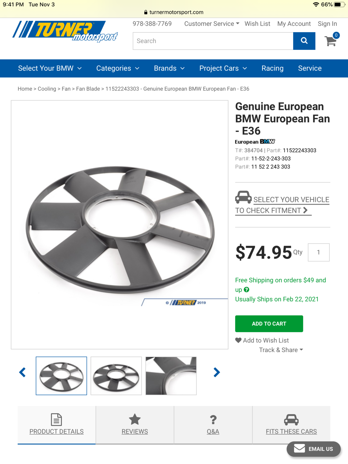

and all that said- when you give up dealing with your problems- just buy a Euro skinny fan and be done with it. 746224D8-CFFD-44E4-9F21-3609CF33FC6C.png
