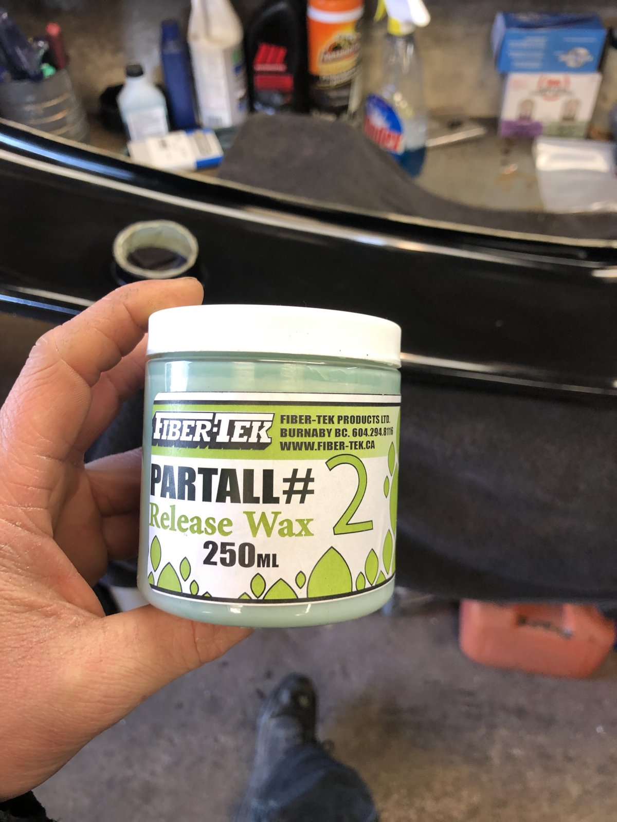

Step 1) release wax application. I’ll be doing at least three layers of partall #2 wax. They call for 2 hours cure time between layers of wax.

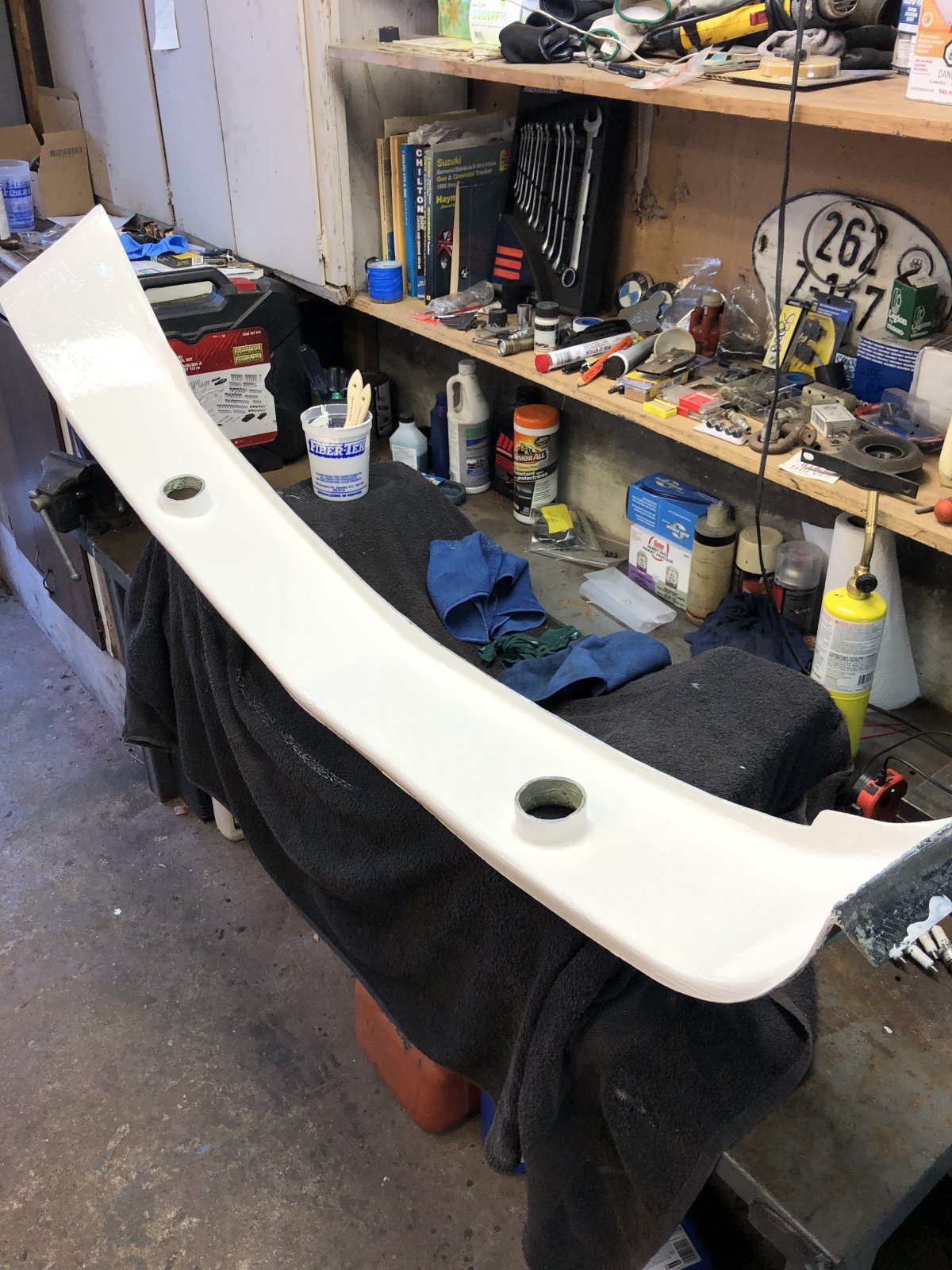

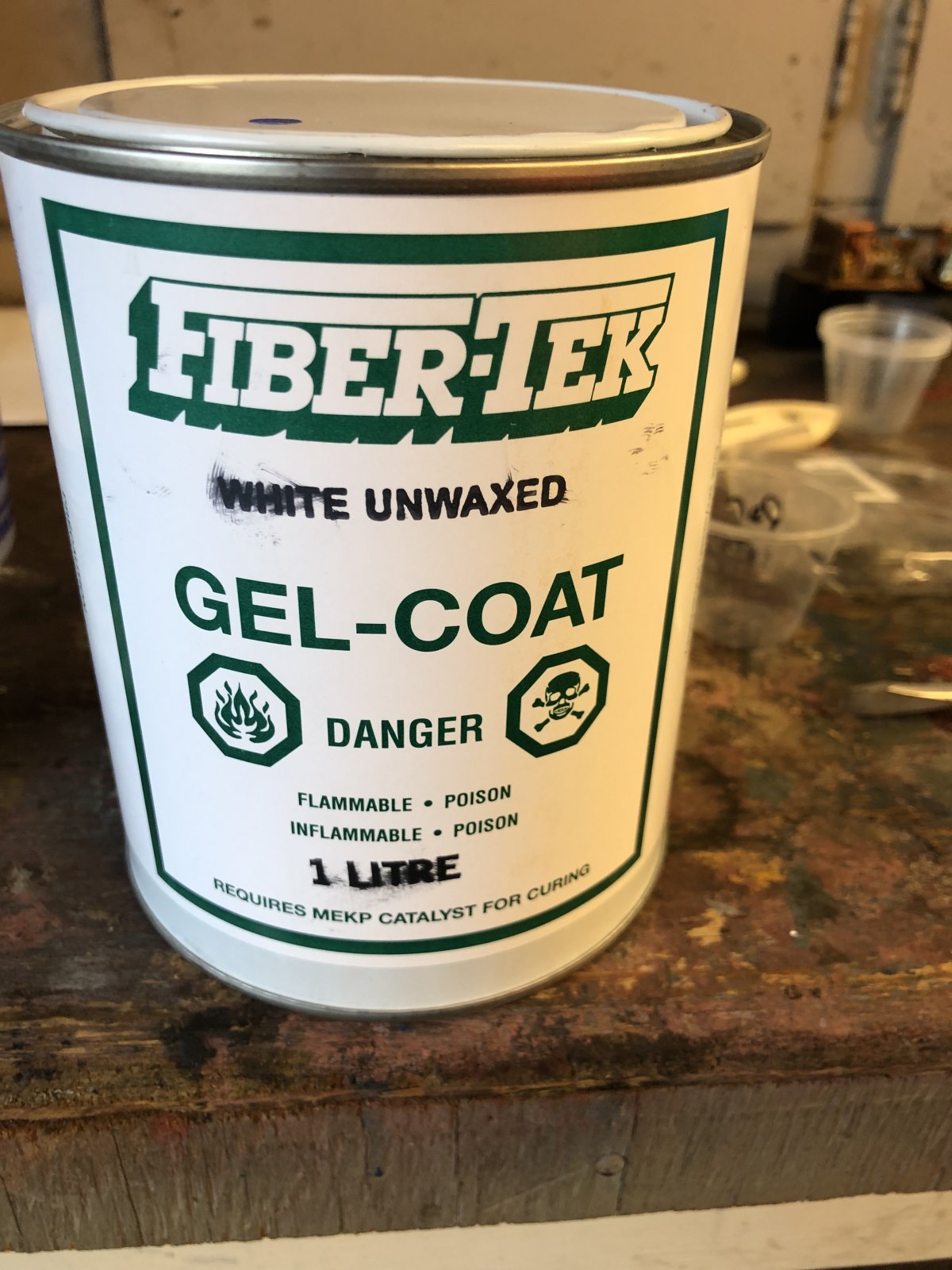

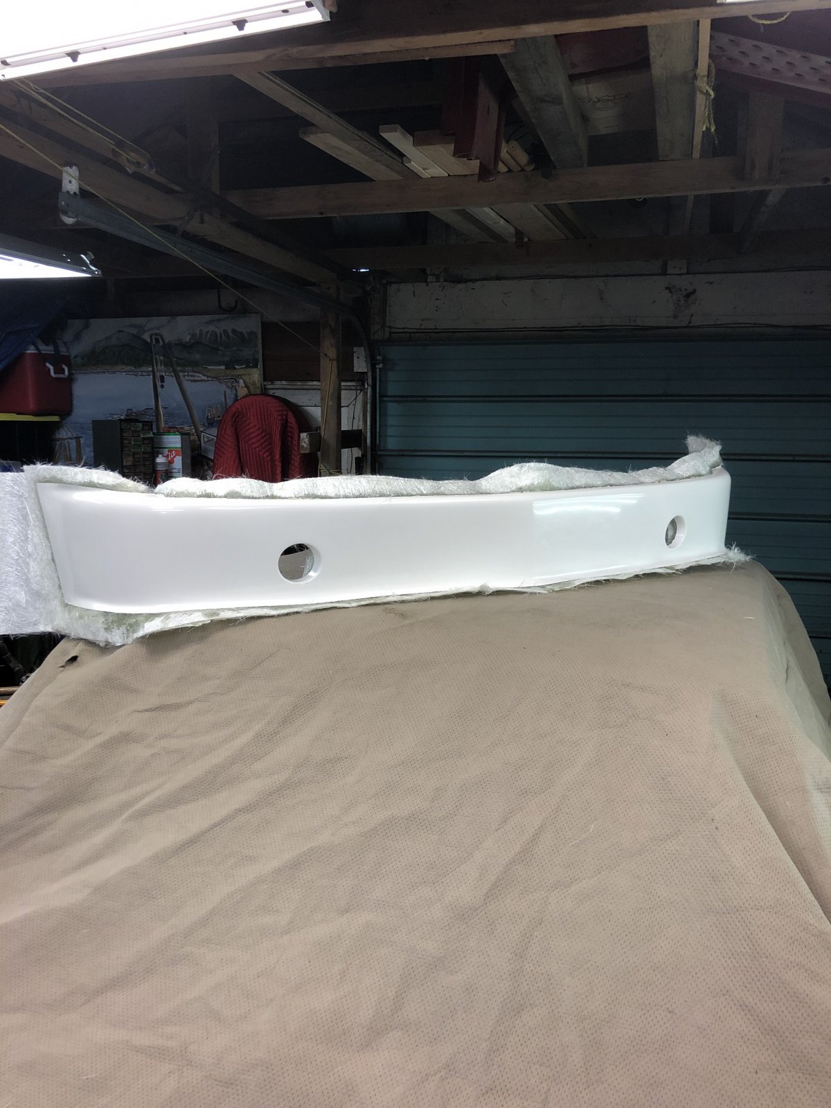

Just finished the first of either two or three coats of the white unwaxed gel coat. Again call for a cure time of 6-8 hours between coats.

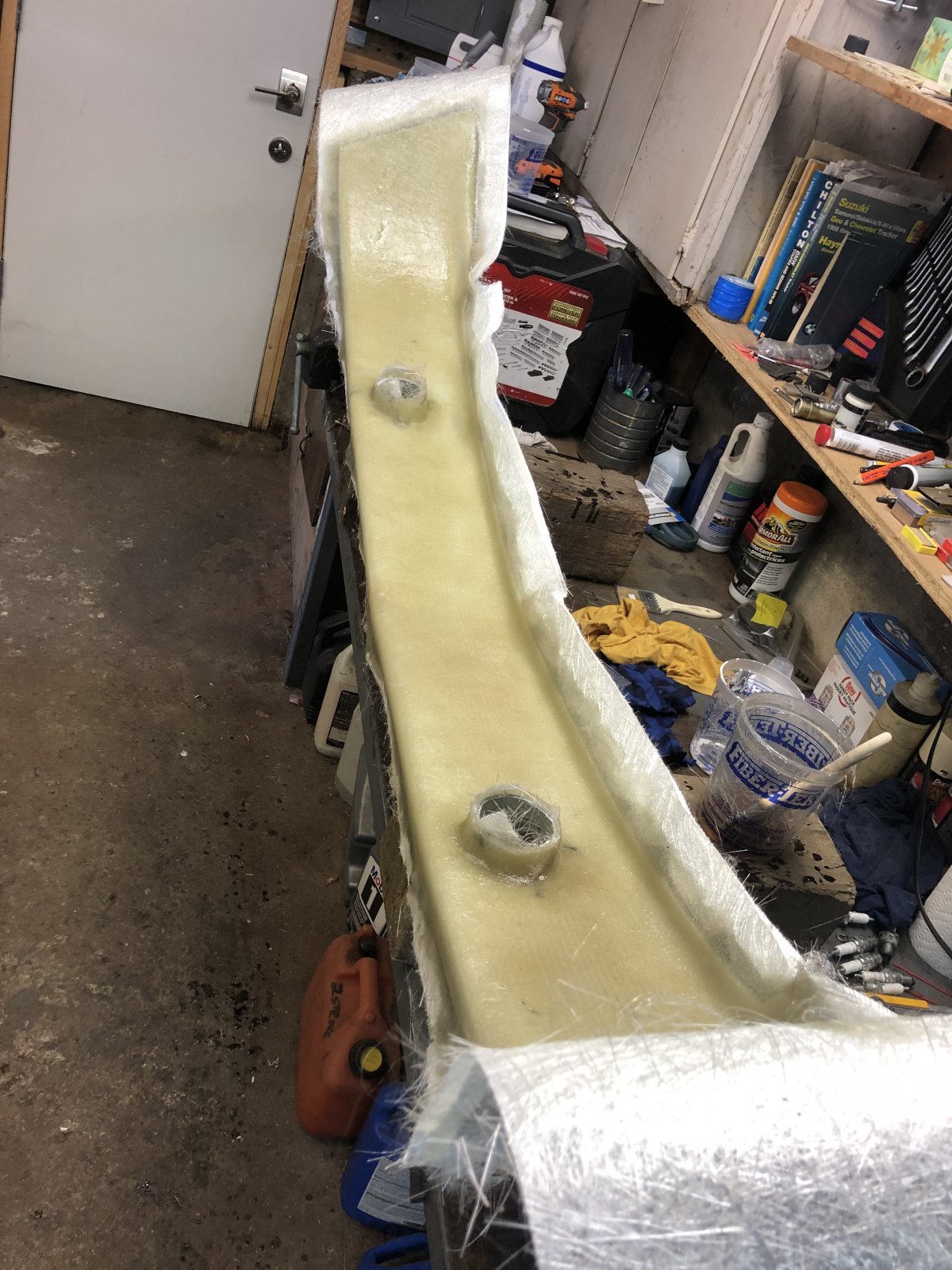

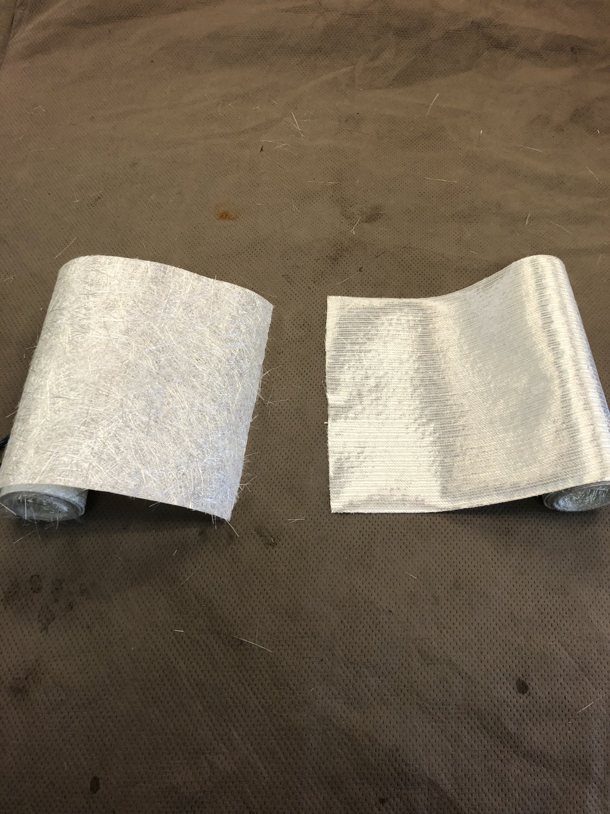

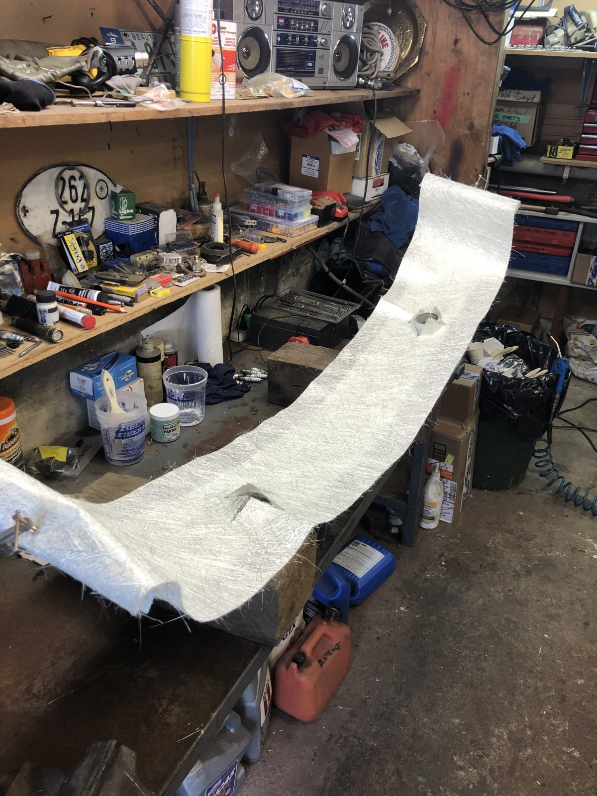

Ready to cut the fiberglass to size. I’ll be putting in three layers. First and third layer will be chopped strand. The middle layer will be woven roving to help keep the plug rigid.

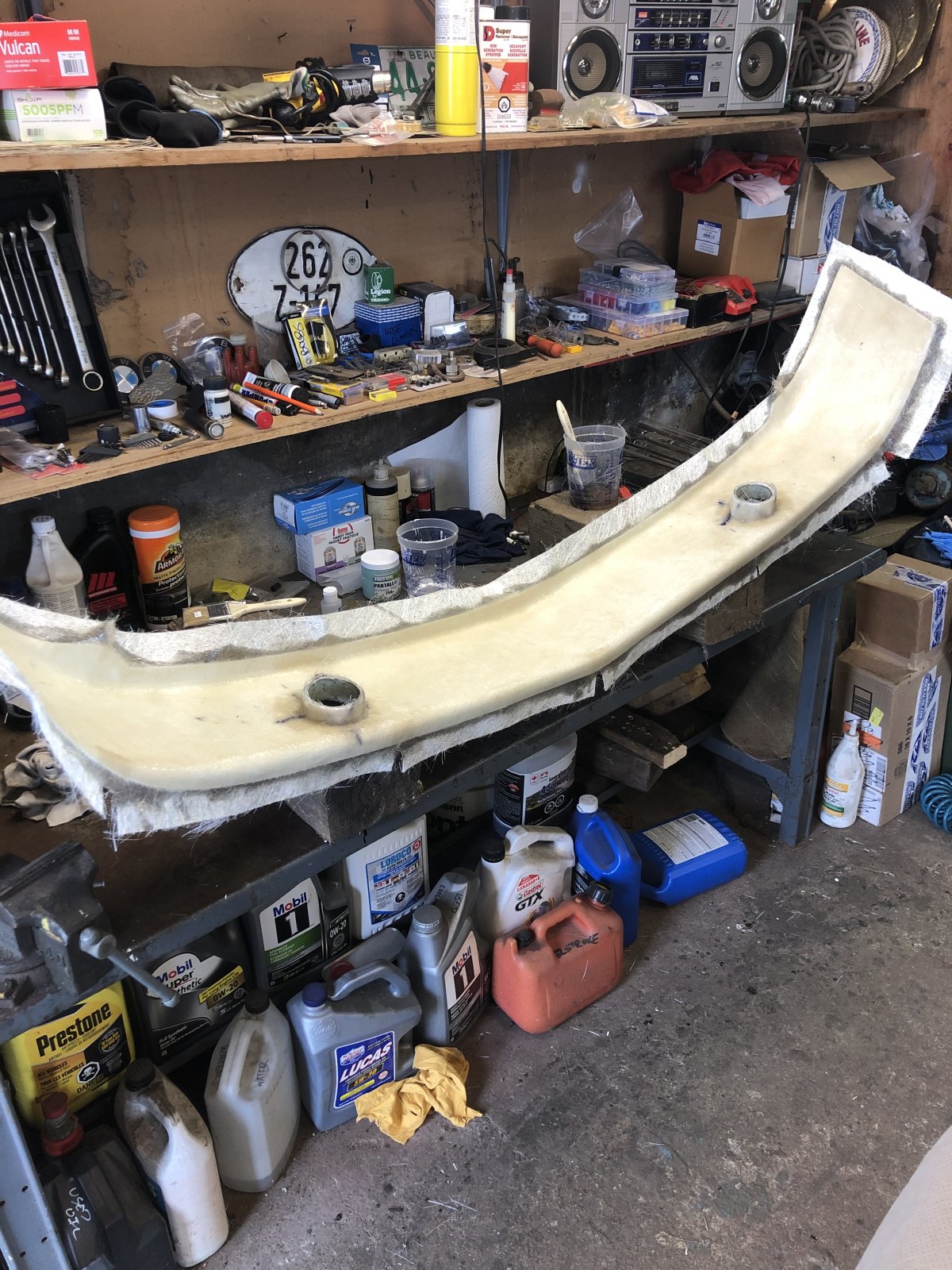

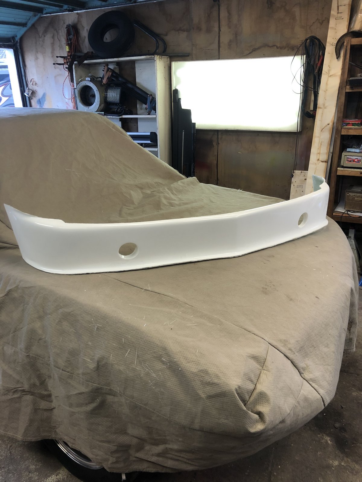

Final two layers done. Should be able to pull the plug out tomorrow morning.

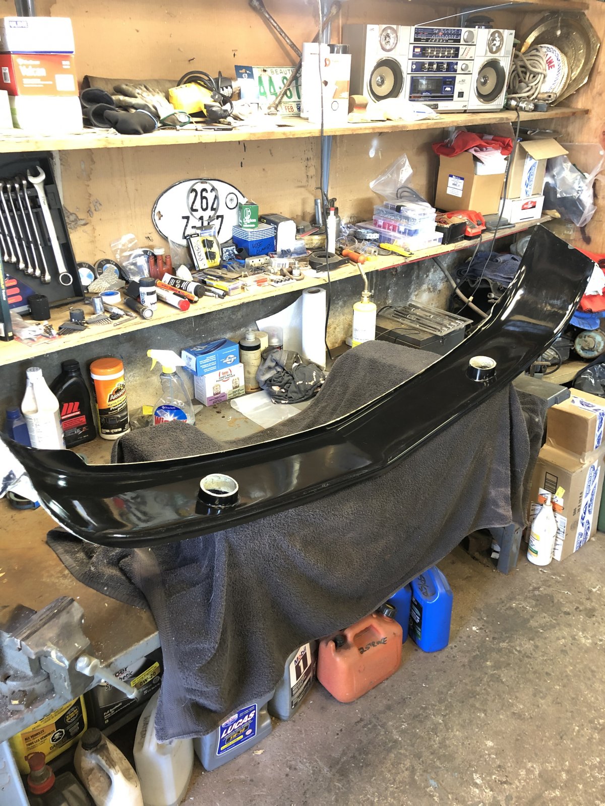

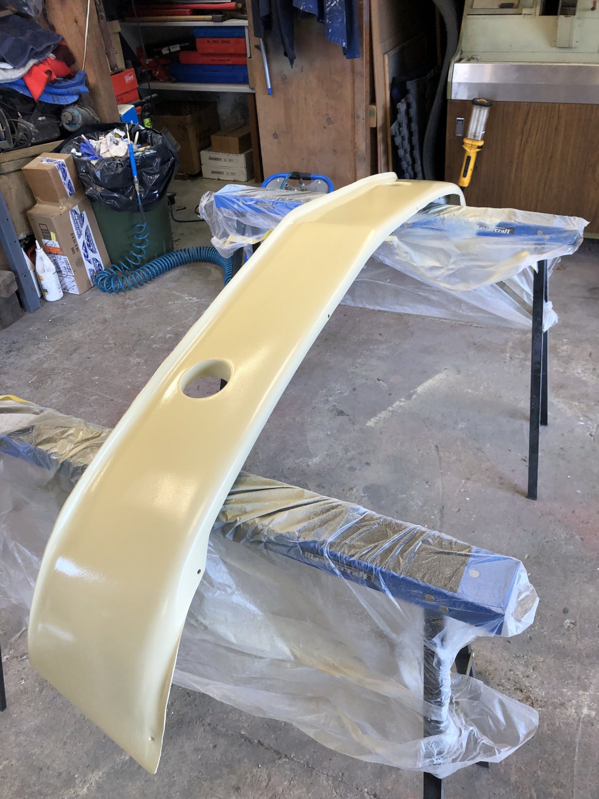

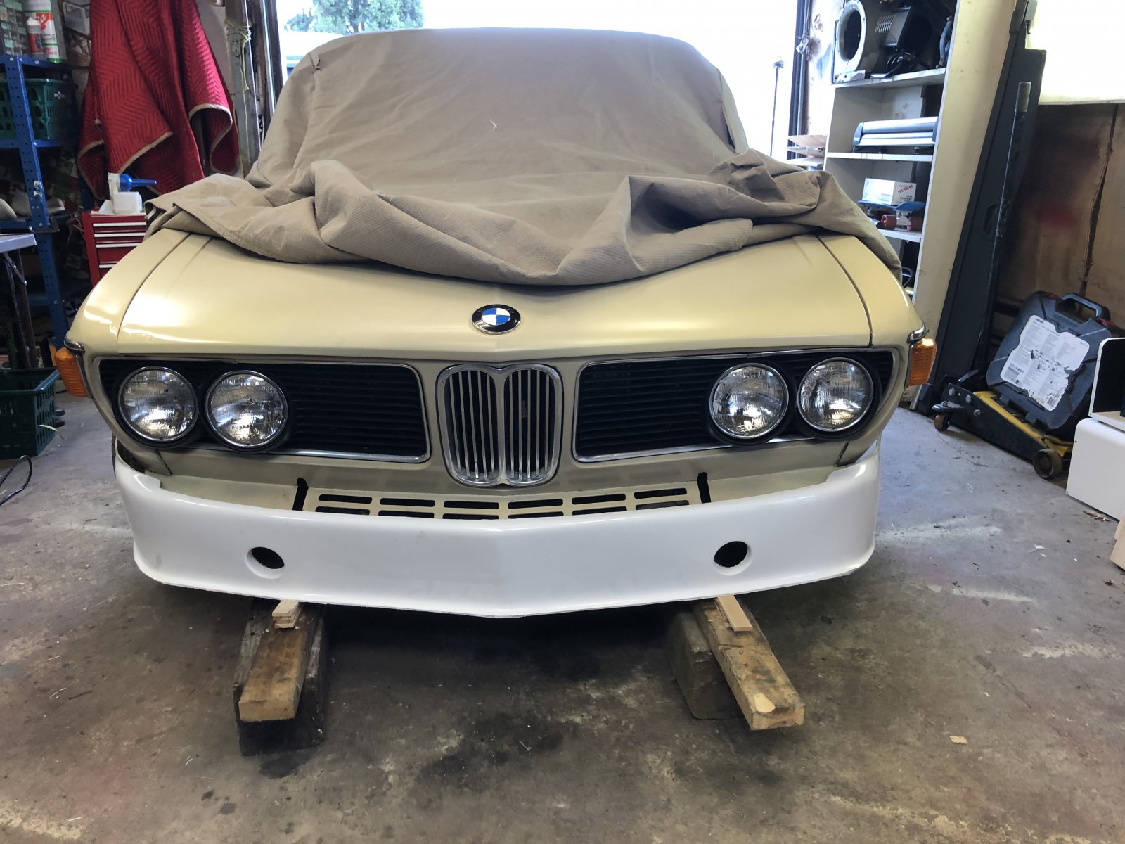

Primer and first layer of paint down. One more layer and a clear coat and I should be good for perminant install tomorrow
