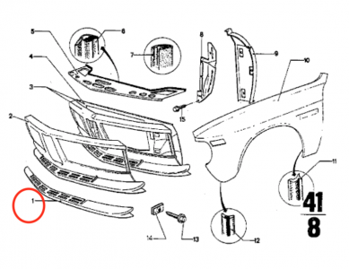

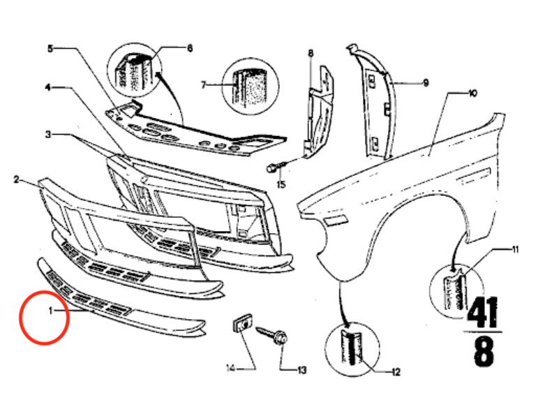

This one:

Out of curiosity I had a quick look at Realoem - this suggests that the front chassis rails are the same. I do wonder though if some other parts might be adapted - figuring that BMW may well have thought there was little point in completely re-inventing the wheel and where possible may have based parts for one shell on the other? Conceivably that may mean parts such as the transmission tunnel, elements of bulkheads and of the front inner wings might be capable of being adapted - that said, if you need to cannibalise an E3 to repair those parts of another car, is it worth saving?
A thousand thanks. Please leave the remaining E3 alone, so many good cars have been butchered to save other models far worse.

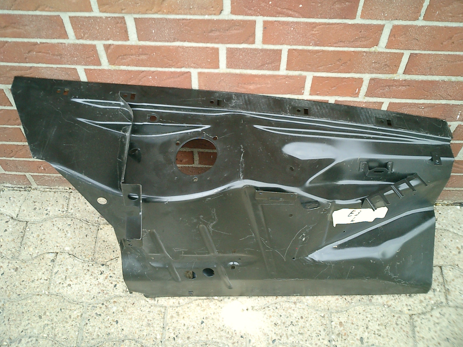

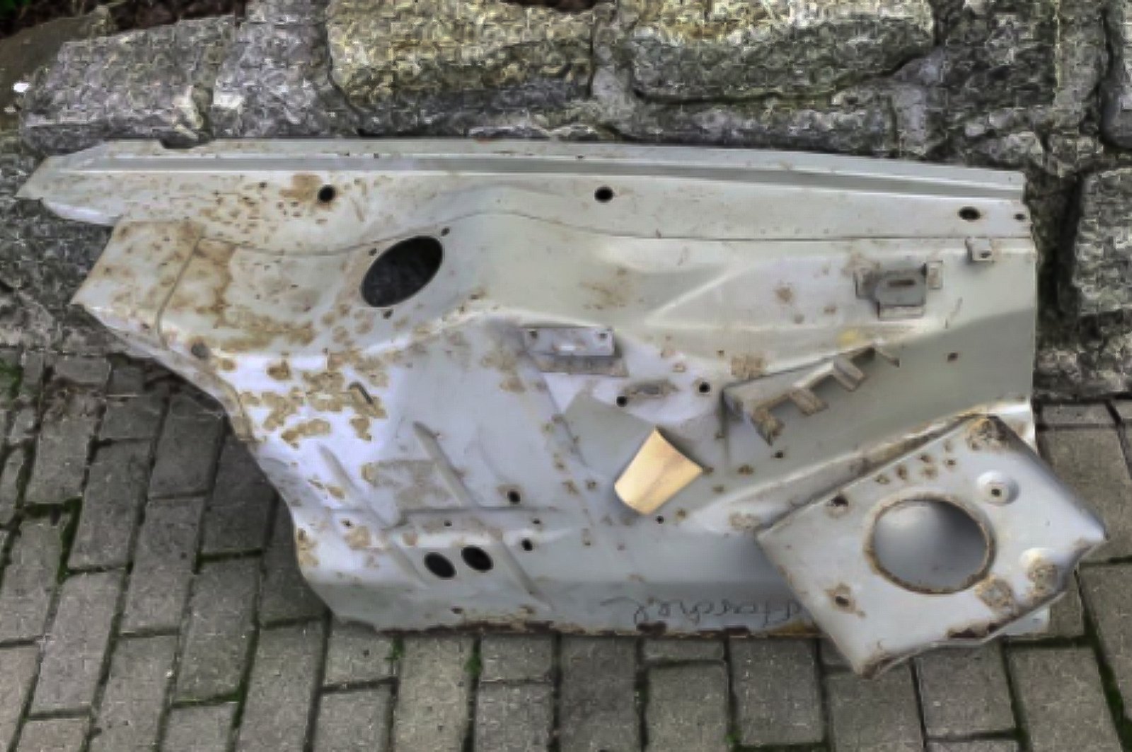

Front inner fender is mostly identical. I used this NOS e3 fender in my e9, of course some modification required and bracket positions are wrong.
E3 NOS
E9 NOS
