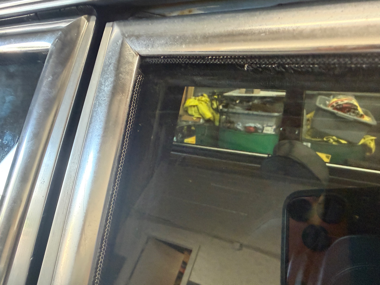

Howdy. I have a customer’s E3 in the shop and he would like to get the felt window guides replaced among other trim.
First question. I assume the guide material is sold by the meter. How many meters should I order to do all four windows?

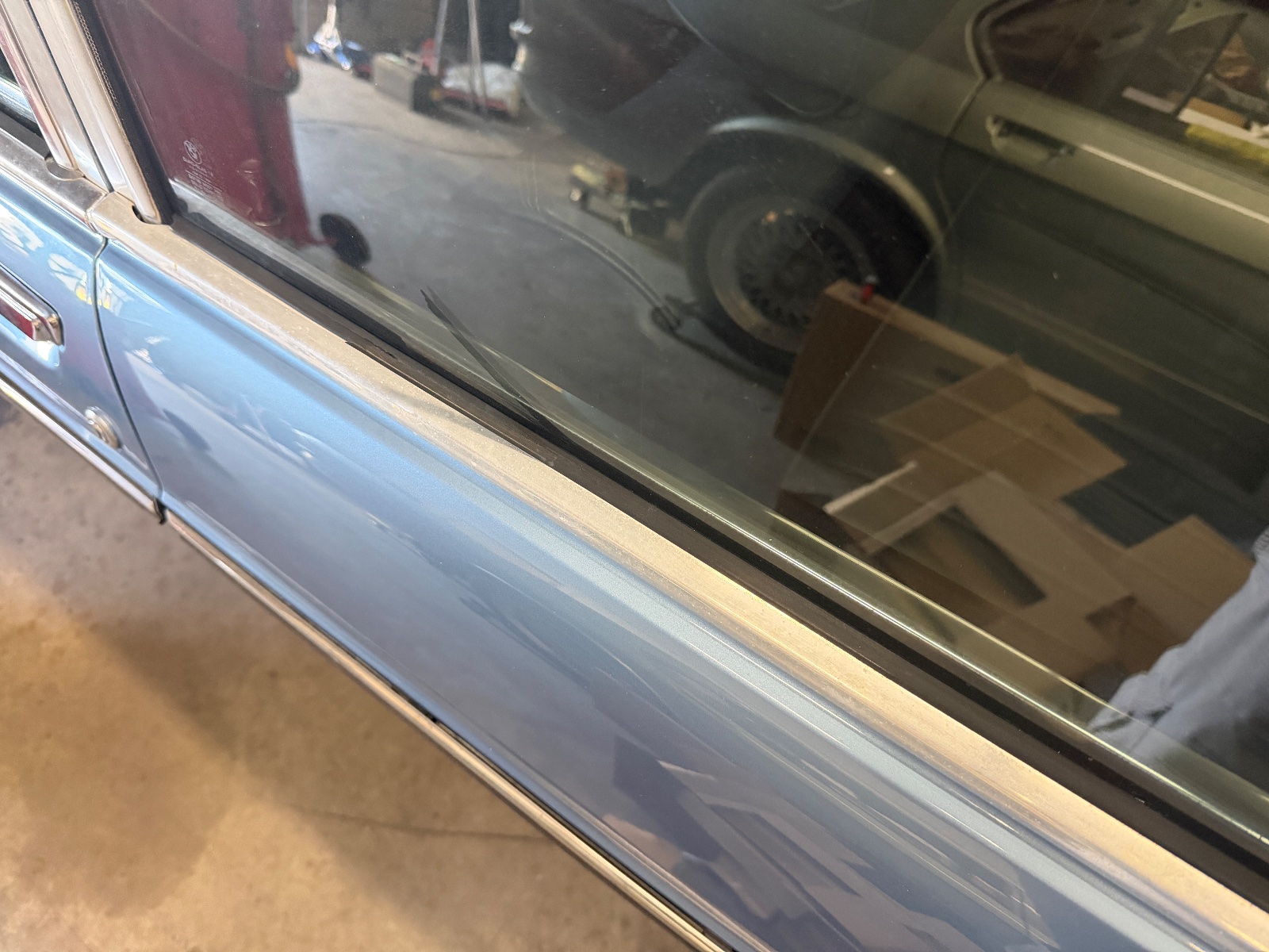

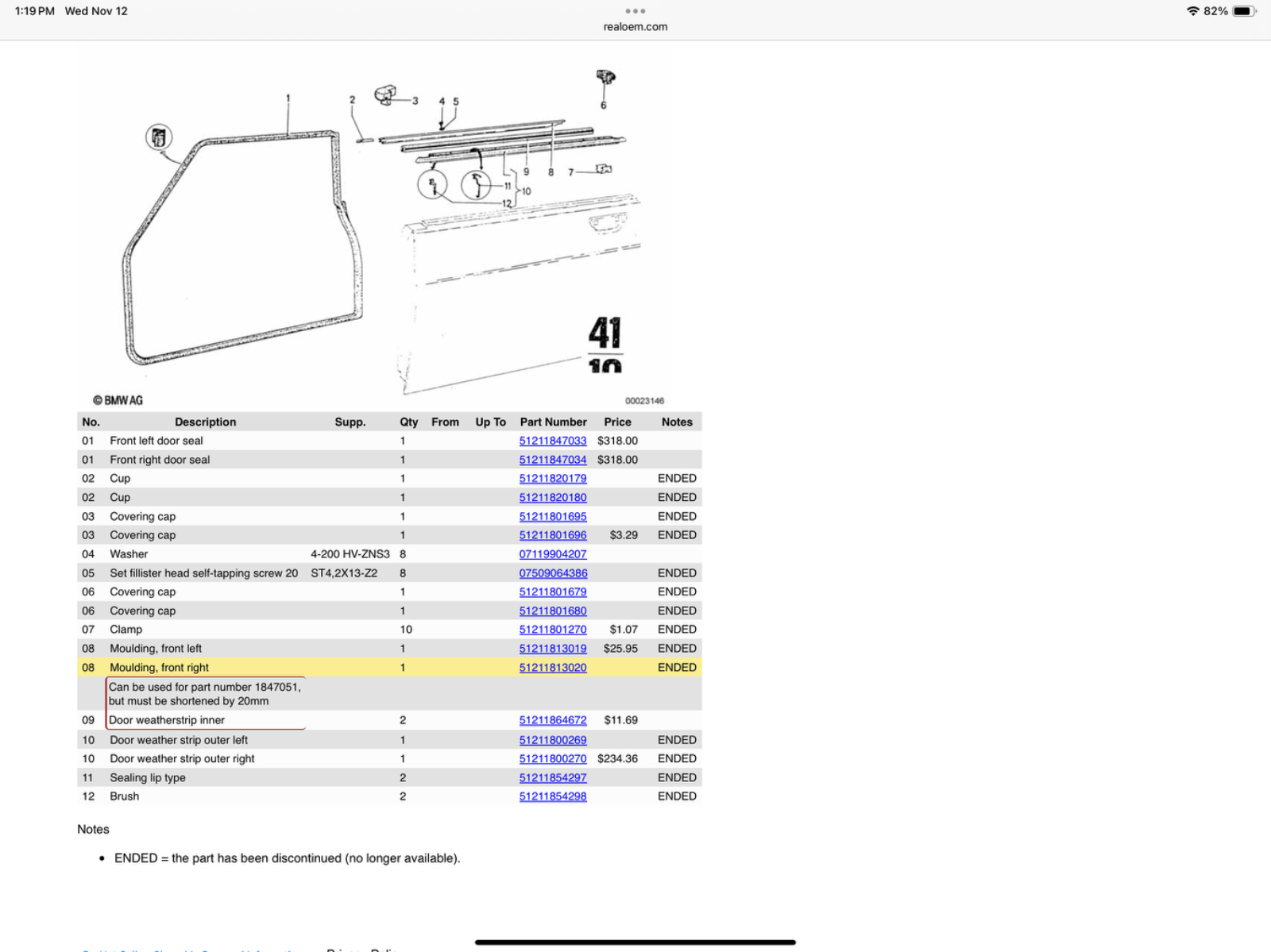

Secondly, the window scraper pieces are pretty rough as well. I cannot find these in the diagrams on RealOEM or Walloth (I don’t have E3 parts books). Are these available? Anyone have an idea of which diagram I should be looking at? I can’t seem to find this outer lower trim piece, but can find the crescent bits that go against the window guide rails.
Thanks for the help!
Chris, The guide (1/2 x 9/16 as I recall, non-beaded) only needs to go down 18” below the window sill. The wipe is probably same as e12 but I will look.
Section 41/23 Rear Door, 51 22 1 819 322 Packing, and 51 21 1 819 323 for smaller piece. Front door 51 21 1 813 020 Section 41/19.
