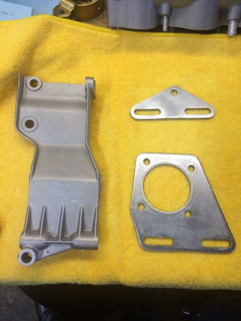

I have the front and rear bracket for a coupe power steering pump as well as the aluminum mount. The brackets have been plated.
I will take some pictures tonight and post.
Mike
Pm sent with my contact info
According to Realoem the part numbers cross reference between a LHD and RHD car. I am not 100% reliant on the accuracy of their info so you will need to confirm. These brackets go on the left side of the motor as shown. The long aluminum bracket mounts to the block and the other two suspend and allow adjustment of the pump.
I also have the alternator bracket if you need it.
