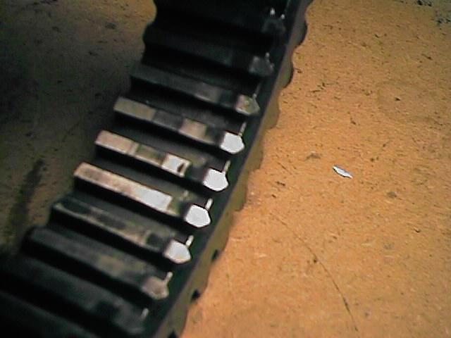

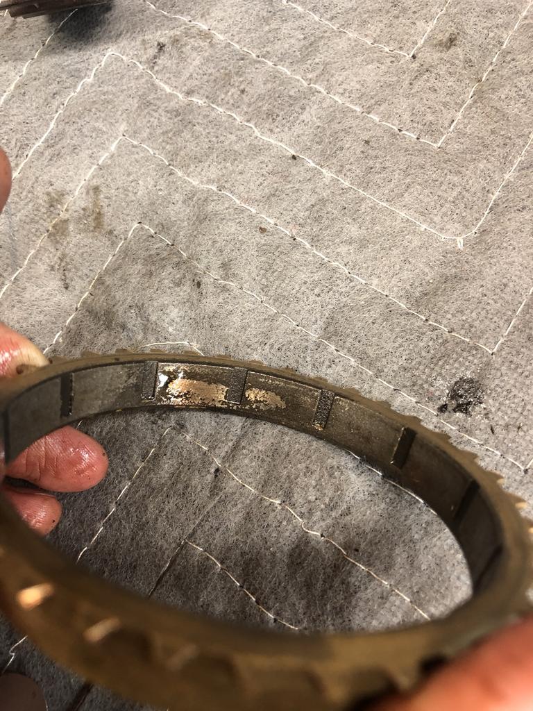

I think your second gear synchro or sleeve/slide is much weared (maybe from inside sliding area, maybe outside teeth are weared out), that's why you have such problem. So, if you are not planning to make any part replacing - you probably have to live with that.
After some driving, under the heat, the synchro ring or sleeve/slide expands, and probably slightly changes its angle in sliding area, and probably locks & sleeve can't go further to fully change the gear.
I’ve had three E3’s (old 4spd), three 2002’s and an e21 and Five of them had worn second gear synchros. They were always a bit balky in cold weather (below 32f).
Back then (35 years ago?) Redline MTL helped and I think because it didn’t thicken as much when cold as conventional gearbox oil. This meant worn synchros had less resistance to overcome. Once warm I recall relatively little diff between MTL and the conventional stuff.
I agree with Wladek that the best solution it to drop the box and have the synchronizer rings replaced.
