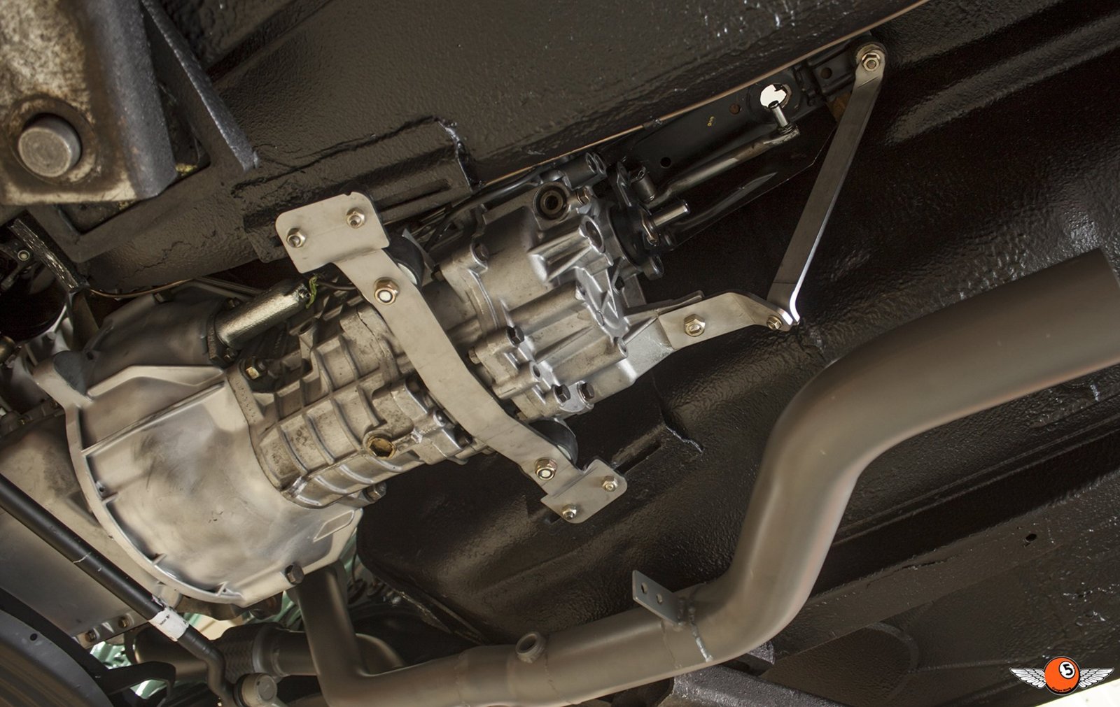

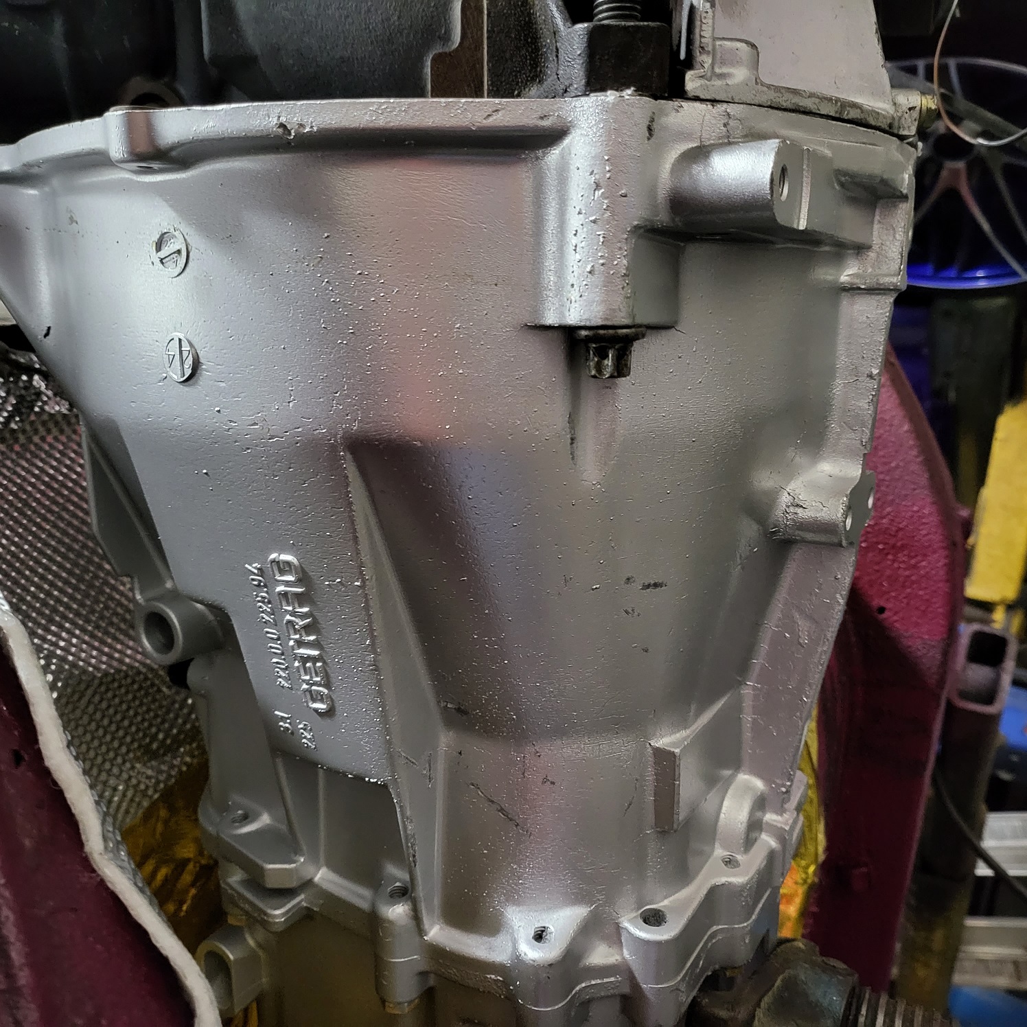

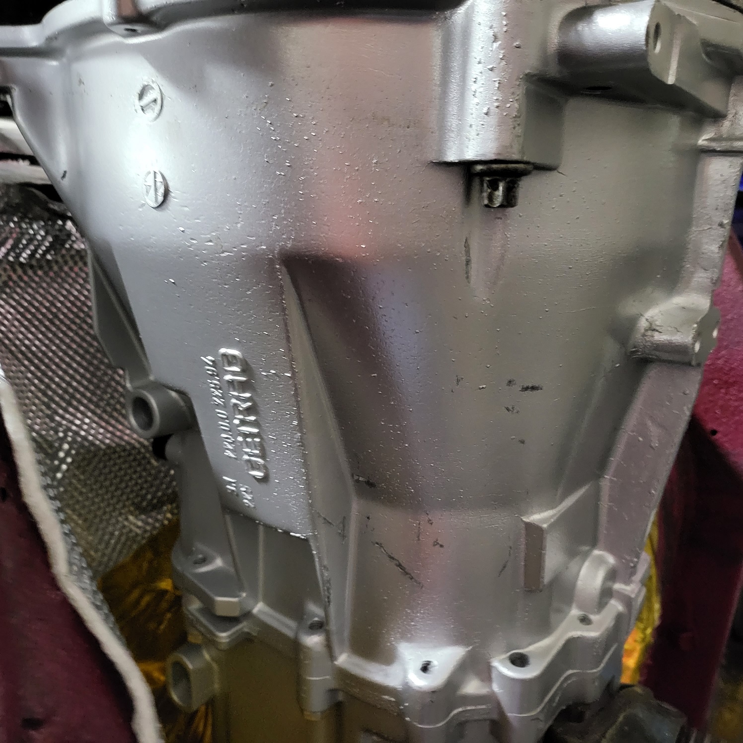

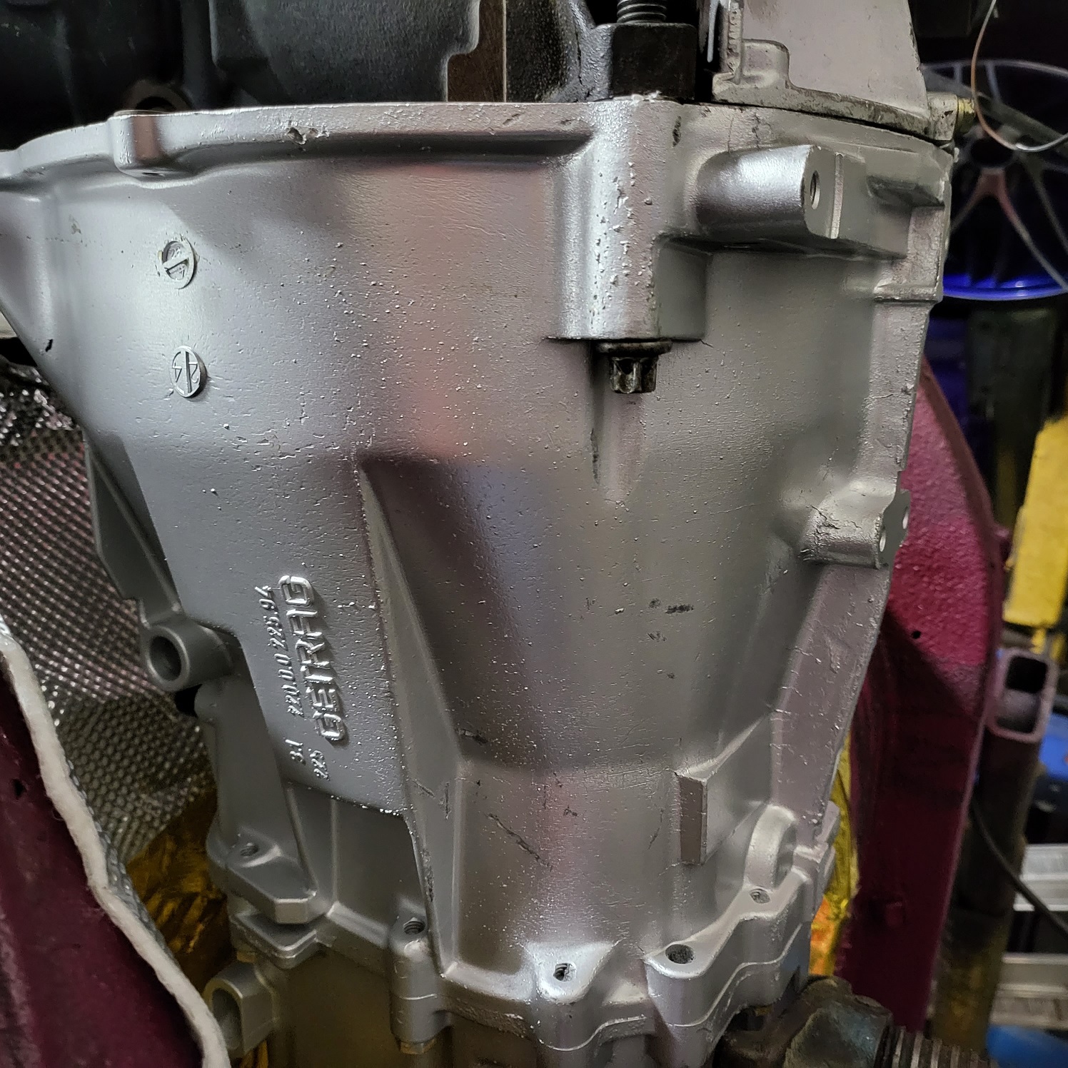

Your transmission looks to be either a zf 310 ( from an early s50) or a later zf320. Both are excellent 5 speed transmissions to fit the m/s 50 line of engines. If you have the zf 320, make sure that you replace the shift detent springs and balls before you install it. There are kits online
