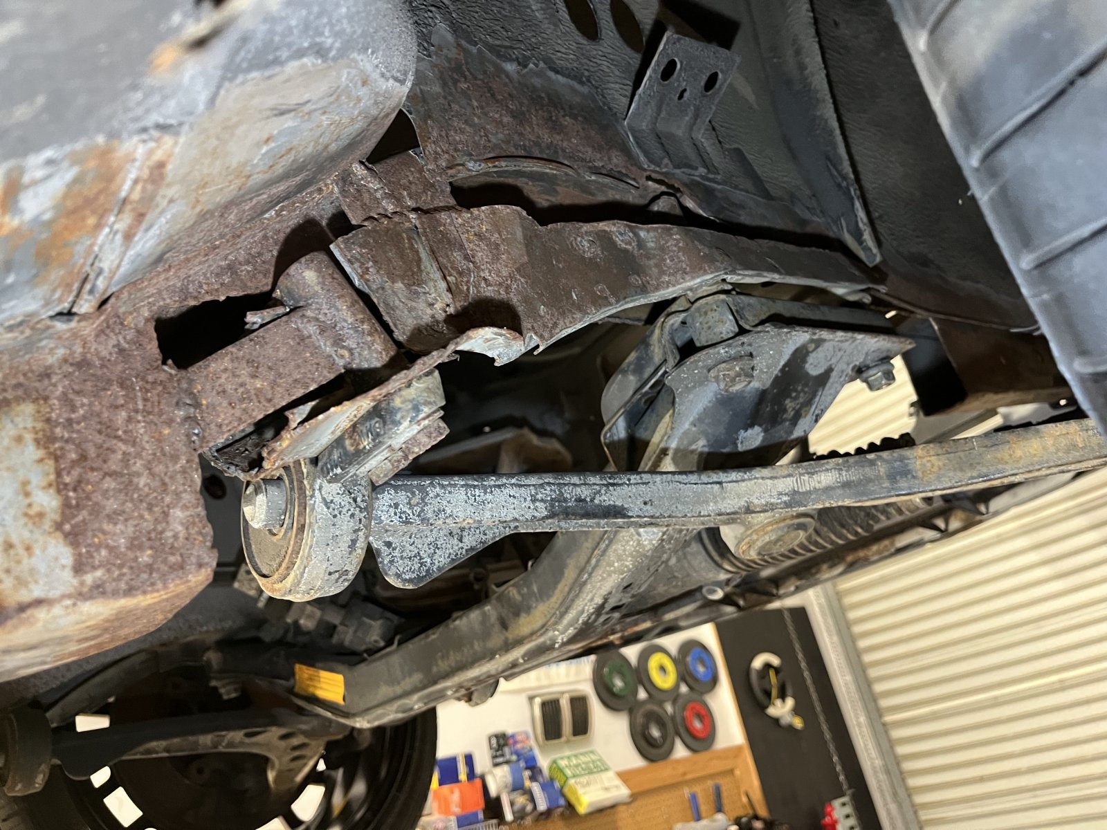

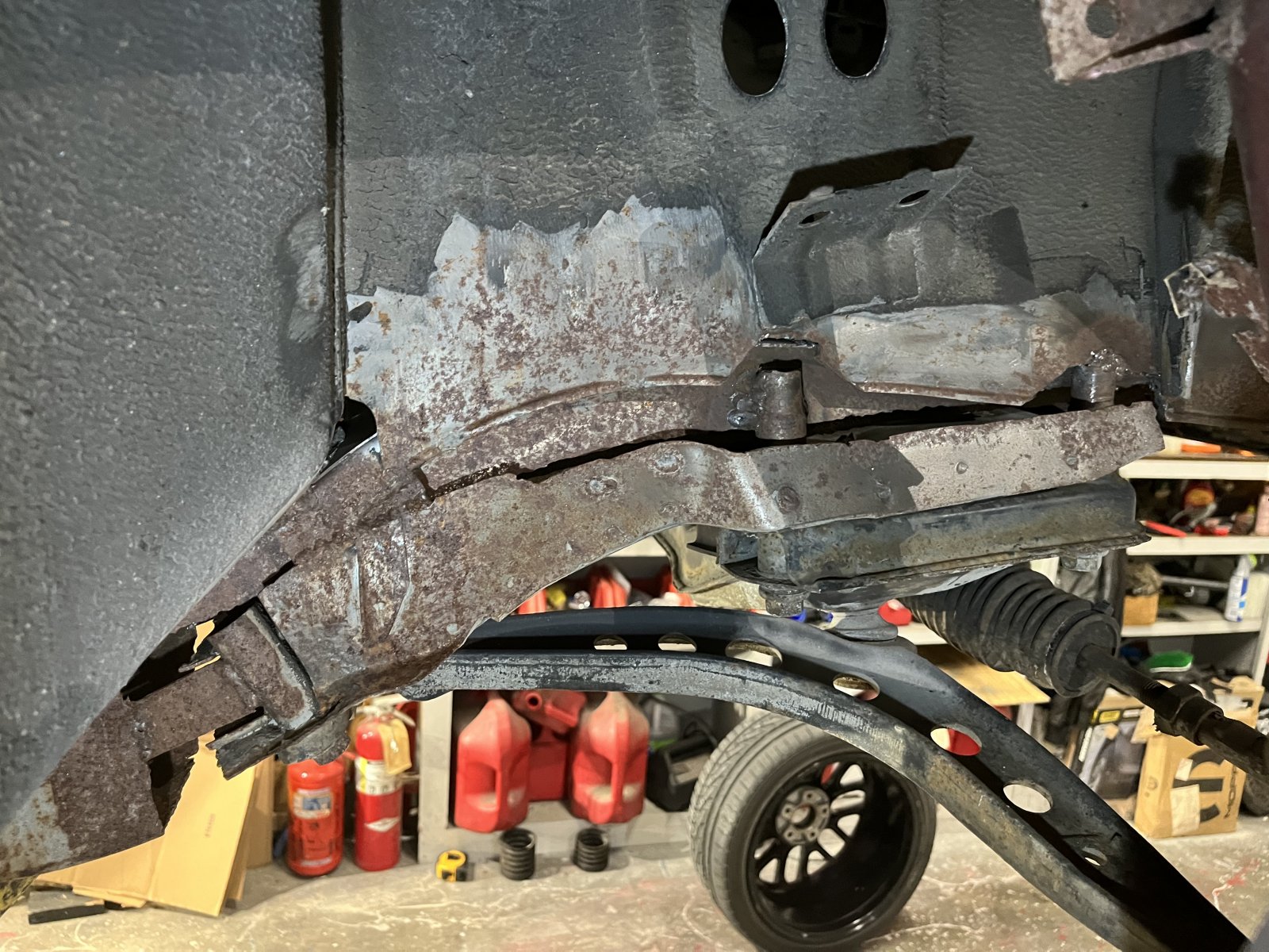

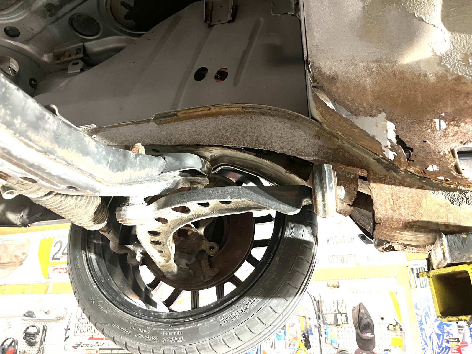

I'll post pictures of the boogered-up E9 front frame rails tonight. Original subframe is missing. Original owner wanted to be cool and welded-in an e36 subframe and rack.
Goober.
I'm a bigger goober, I purchased it.
It is a mess. This car will be a tribute race car. (If I proceed with the project.) So, who cares about perfection.
To the point: Do the E9 and E3 share the same front frame rail and subframe dimensions?
I have access to an E3 front end, a torch, the ability to reweld, a frame alignment rig and some fantastic/talented friends.
Any ideas on dimensions?
