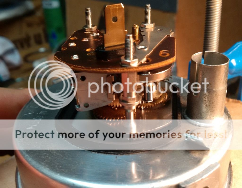

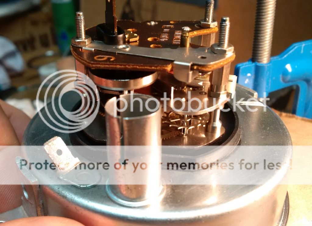

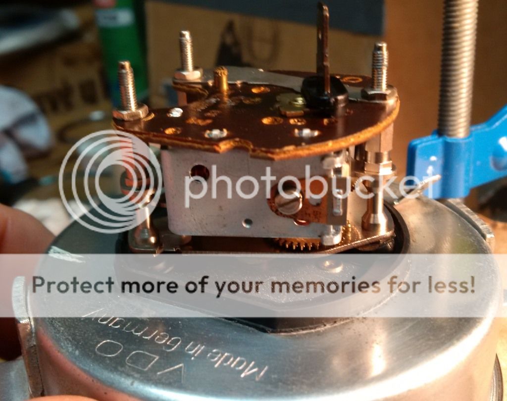

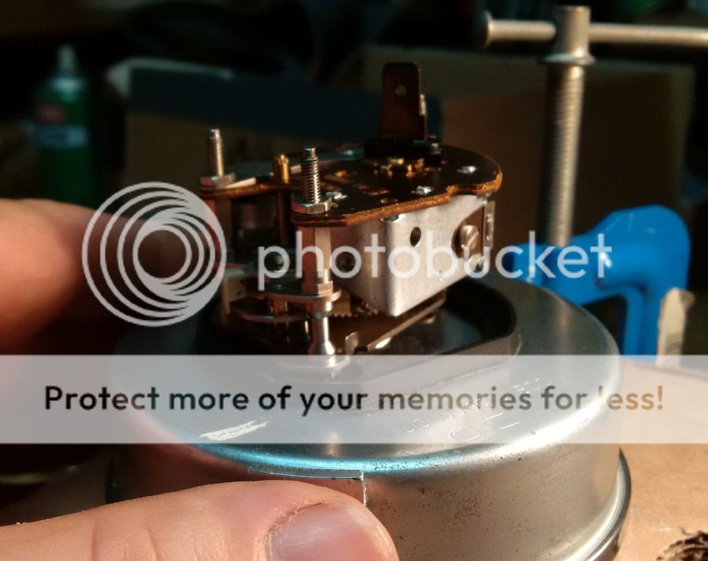

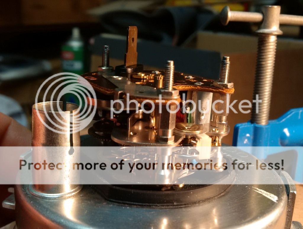

i wanted to understand how the clock Works, this is the mechanical versión as found in older cars, as every two minutes you can hear an odd "clack" noise, so i checked it while connected to the batt,
previously cleaned contacts and a tiny drop of oil in the shafts

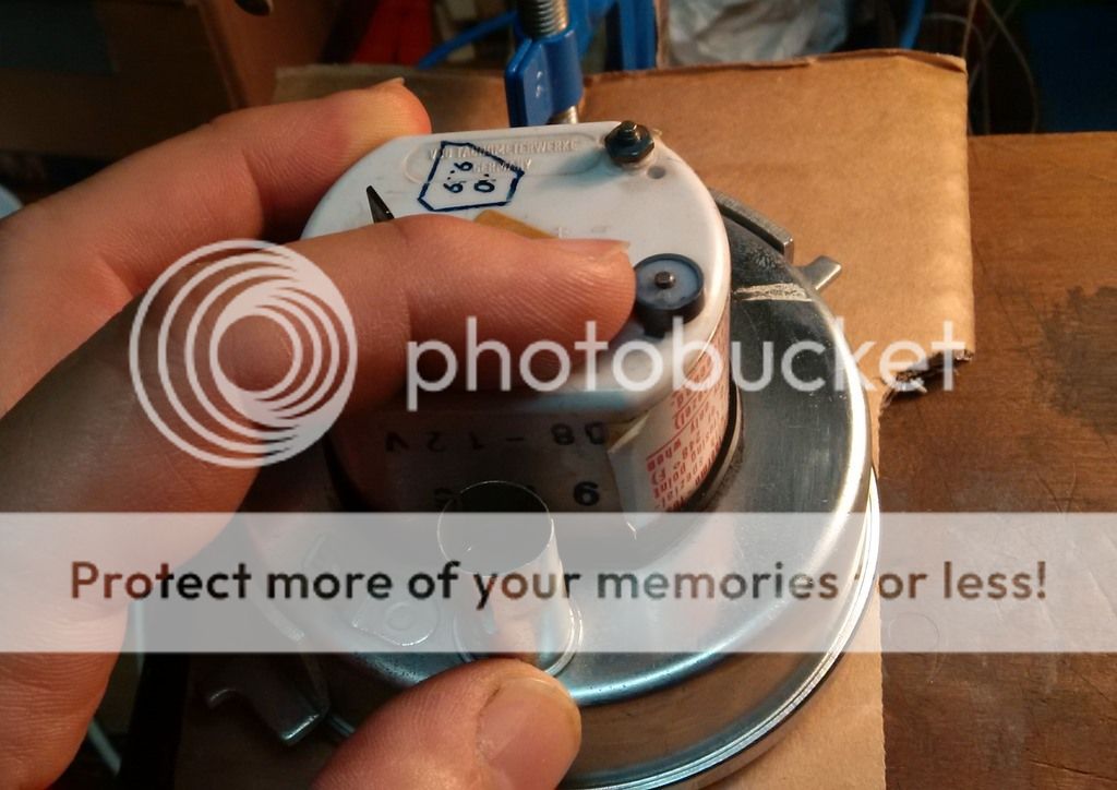

to open first remove sealed nut:

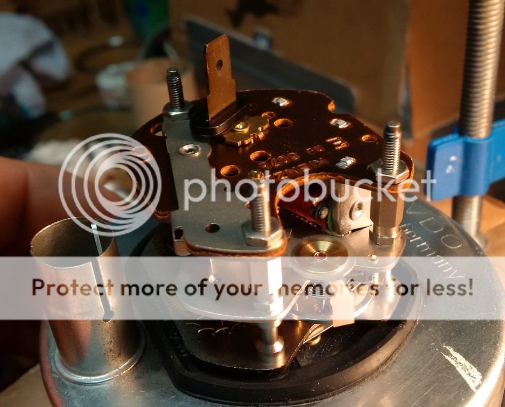

inside views:

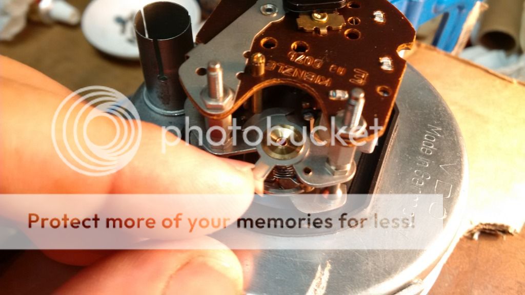

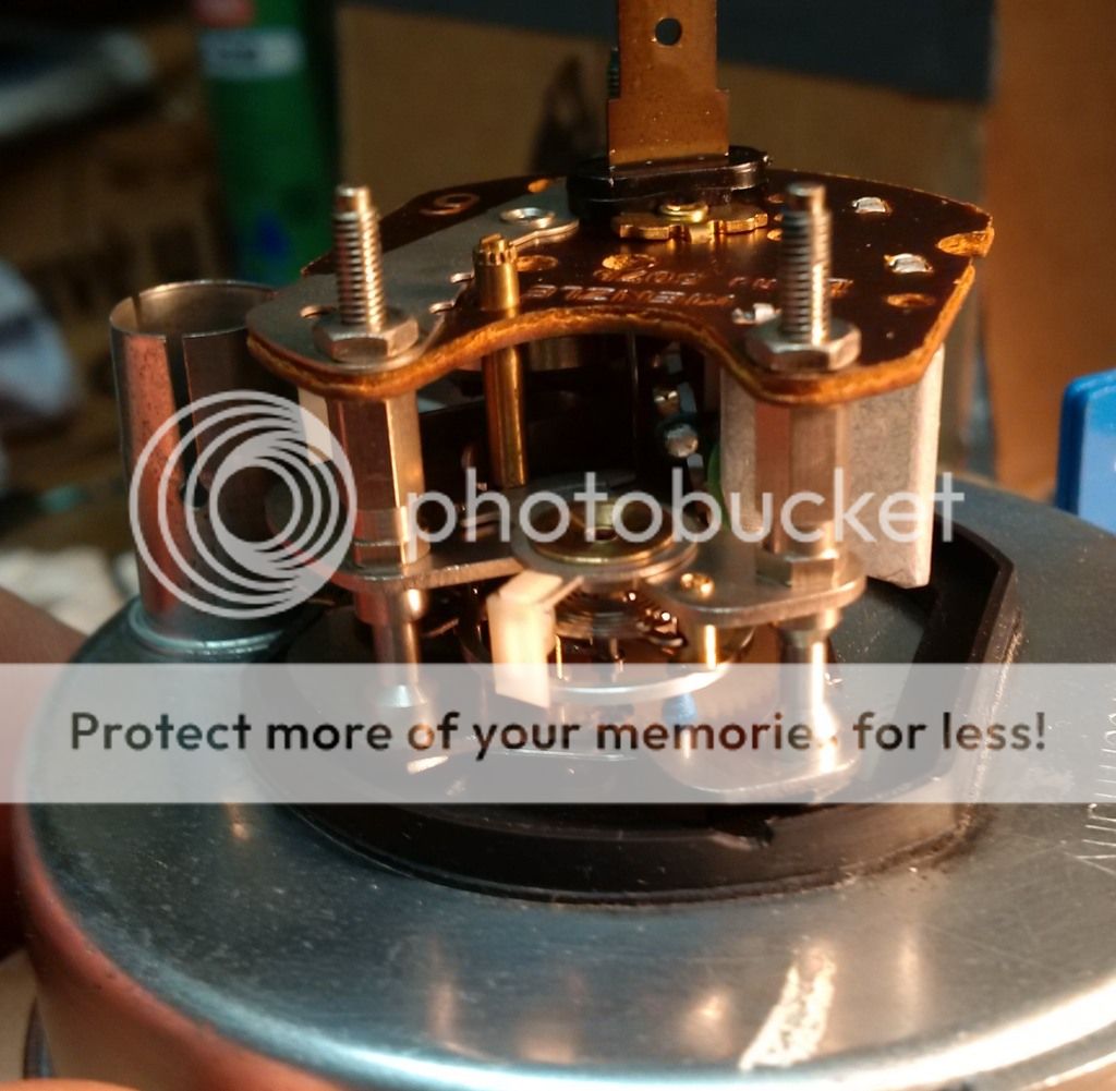

here is the lever that adjusts the clock to set it faster or slower
see how it works
