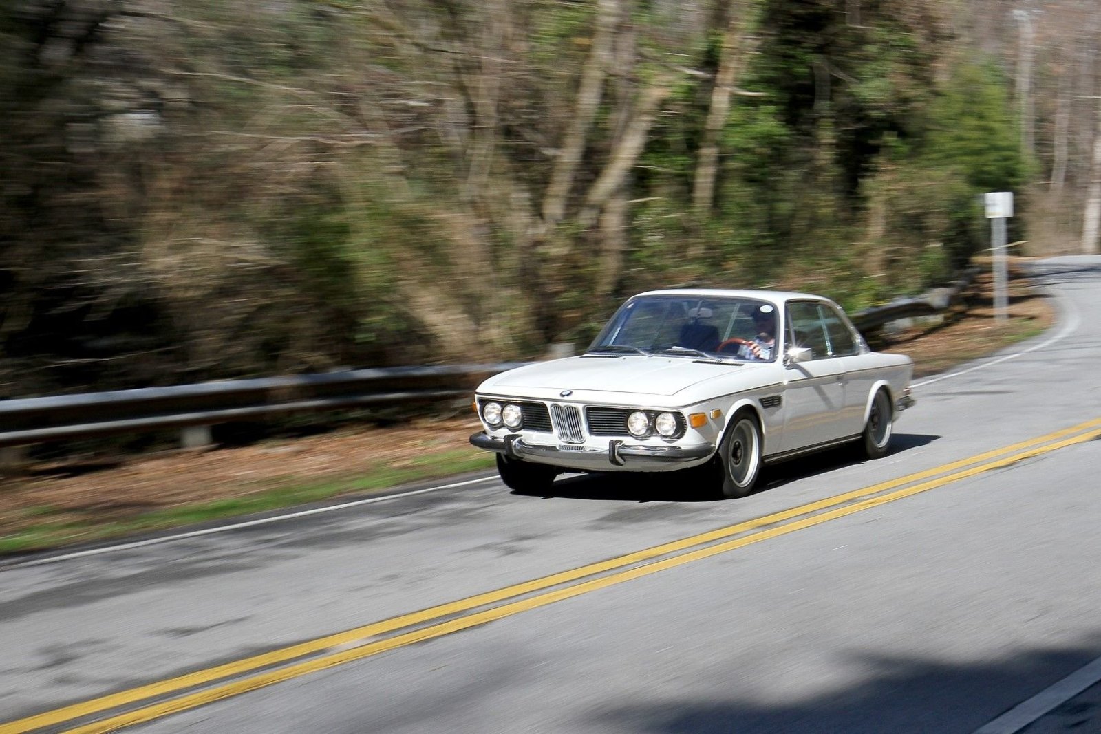

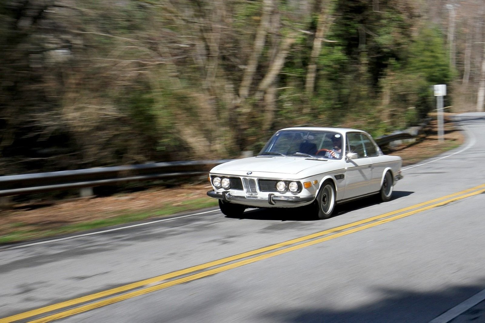

Does anyone have one complete. I miss being able to see and would like to install one.

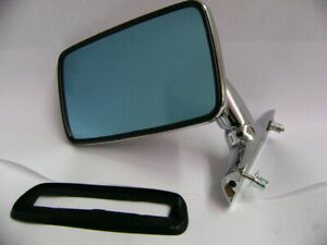

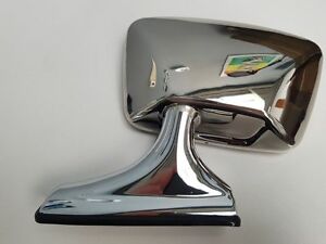

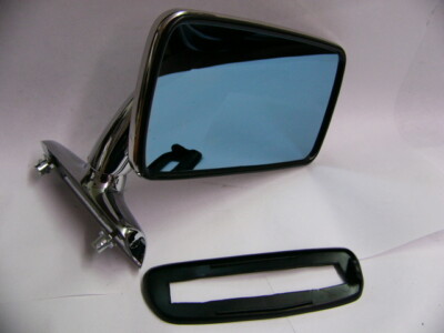

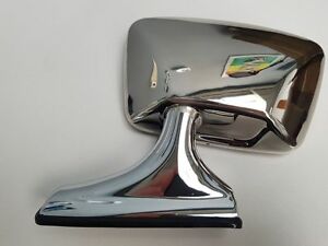

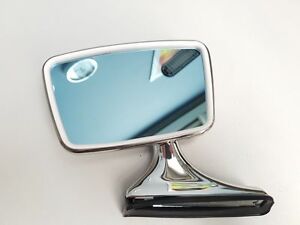

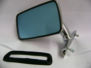

Which type do you have? Flag or trapezoid. Judging by your pic, it ‘looks’ like the flag typ.
1st pic is Flag. Has black plastic around mirror
2/3 pic is trap. Has white plastic around mirror
yes, same as 2002

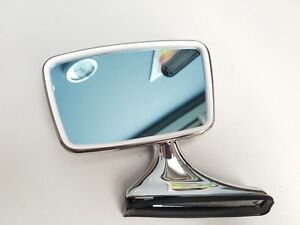

'74s, somewhat common to find motorized DRIVERS (LEFT) mirror only. RIGHT SIDE motorized mirrors, w/the changeover switch, etc. are very hard to find now. Especially the wiring.
Right side mirror ($$$): https://www.ebay.com/itm/265930162326?hash=item3deaac4096:g:qtwAAOSwSXtjRKIY&amdata=enc:AQAHAAABMAHhgSB+TMbpGuIvSZsYnLx51oXWyu+B7a2/mp6a1EEE84CyWjrB7i4KyT5SAzZgngf2WuFdc3d9QI1NRzwbkUzQ6G1SagoBOrqy7GFziQe0wK2XBpgudZGsX4gXEM+8nJNsvkKh4d2iWBhboFz/L9jffJLWdlojtQBCF+xFRAPRX72Xbg4N/9dxOSqi1u6z0gmhpw8T4Xi6KBF7uSvD/C02s/rKYeJrpBr5L3PfjHy6Q7CKfHh6mgX3CKgzPR2lXfkp3P+8HuqygsuA4fMvtctjQVRzVNOF3qV0LdEUxqNWDJzEQwT6DMT2++jkXqkfVYLFs6HfTsCsUCAWUfSbohUzbcbXBnhyts576+M32eFTRPbIzhi9waD8Umr1R7nv5pnYTvMVCUnz0qxZRZ4Z9zc=|tkp:Bk9SR87bmMm8YQ&LH_ItemCondition=4|3
If not going to find a matching motorized mirror, best to just get two flags or two traps to match.

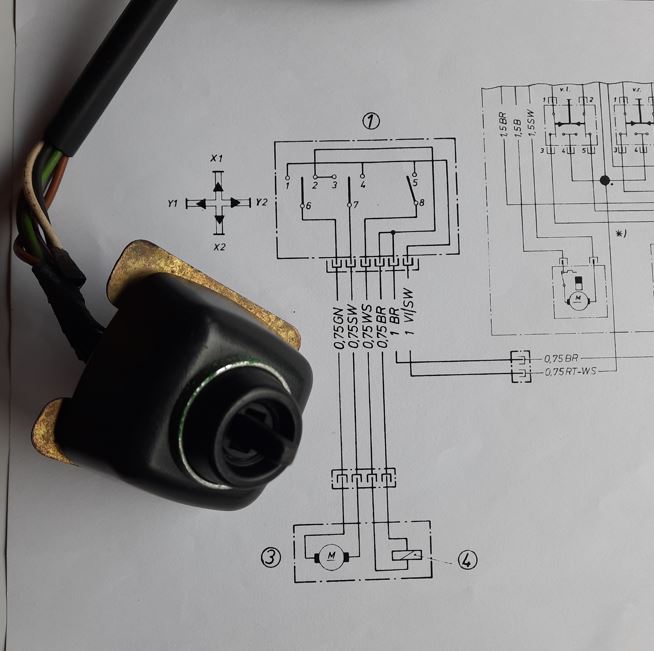

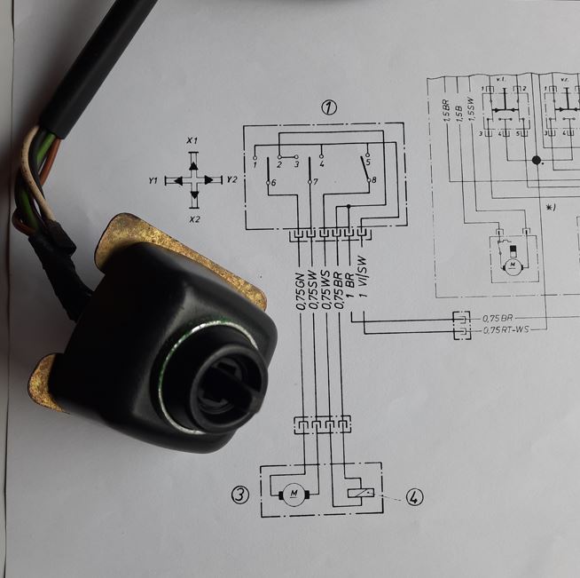

I guess this controller comes from E3.
It´s for the left mirror only. If you want to control the right mirror with the same device an additional 4line-switch needs to be installed!
Remark: sorry, the controller is no longer available, sold only some weeks ago.
So you have the right motorized mirror but you do not have the controller?
I would be interested in a right side motorizer mirror if there is also a controller.
If you find a right side power mirror you can gently push on the glass the set it even without power, I had to do this on my e12. If you find the controller with the left/right switch in it you would still need the four wire harness that goes to the passenger side, it isn’t currently in your coupe.
Sure, makes sense - but the solution is running 4 wires to the passenger side door ... not that difficult.
Finding the controller seems more difficult!!
