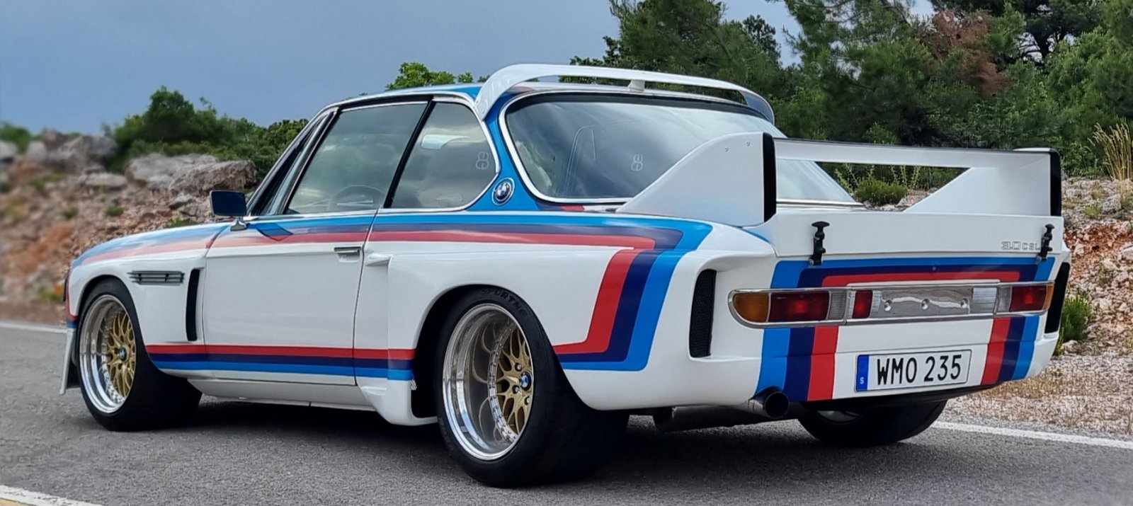

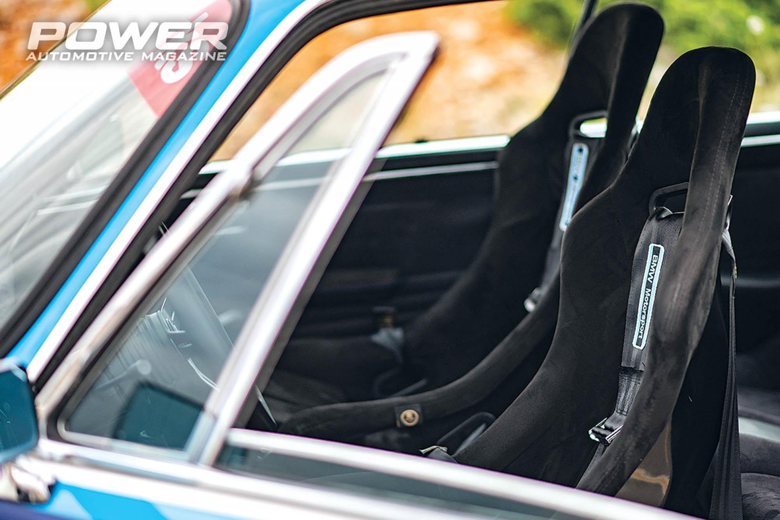

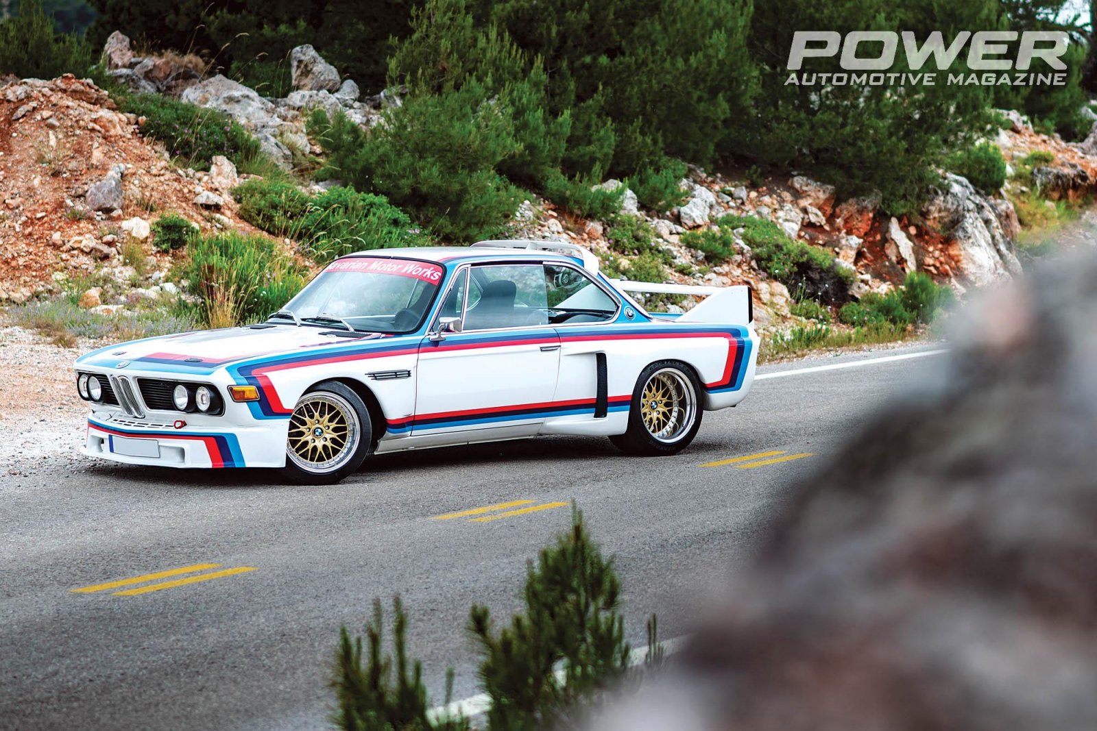

Hello.

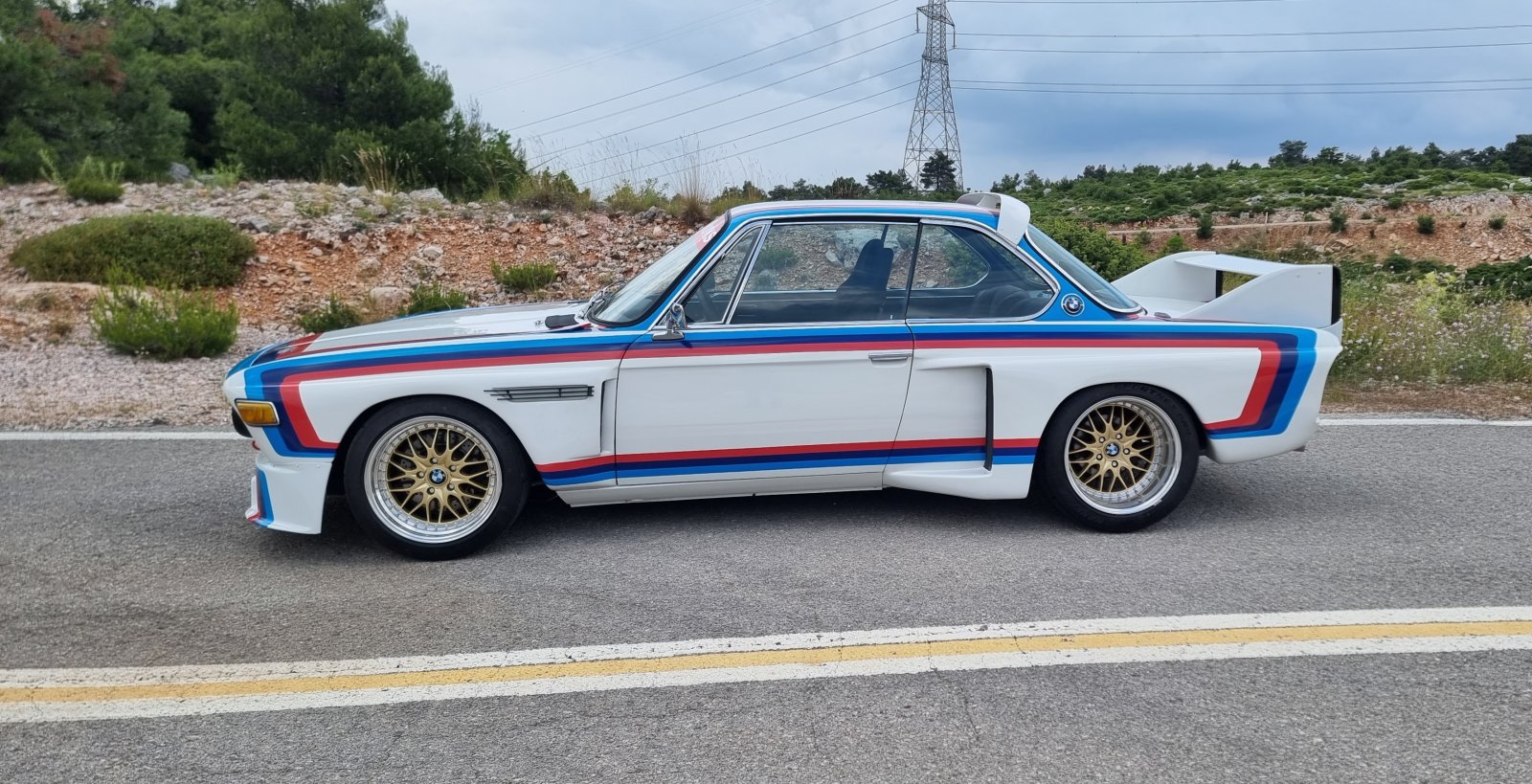

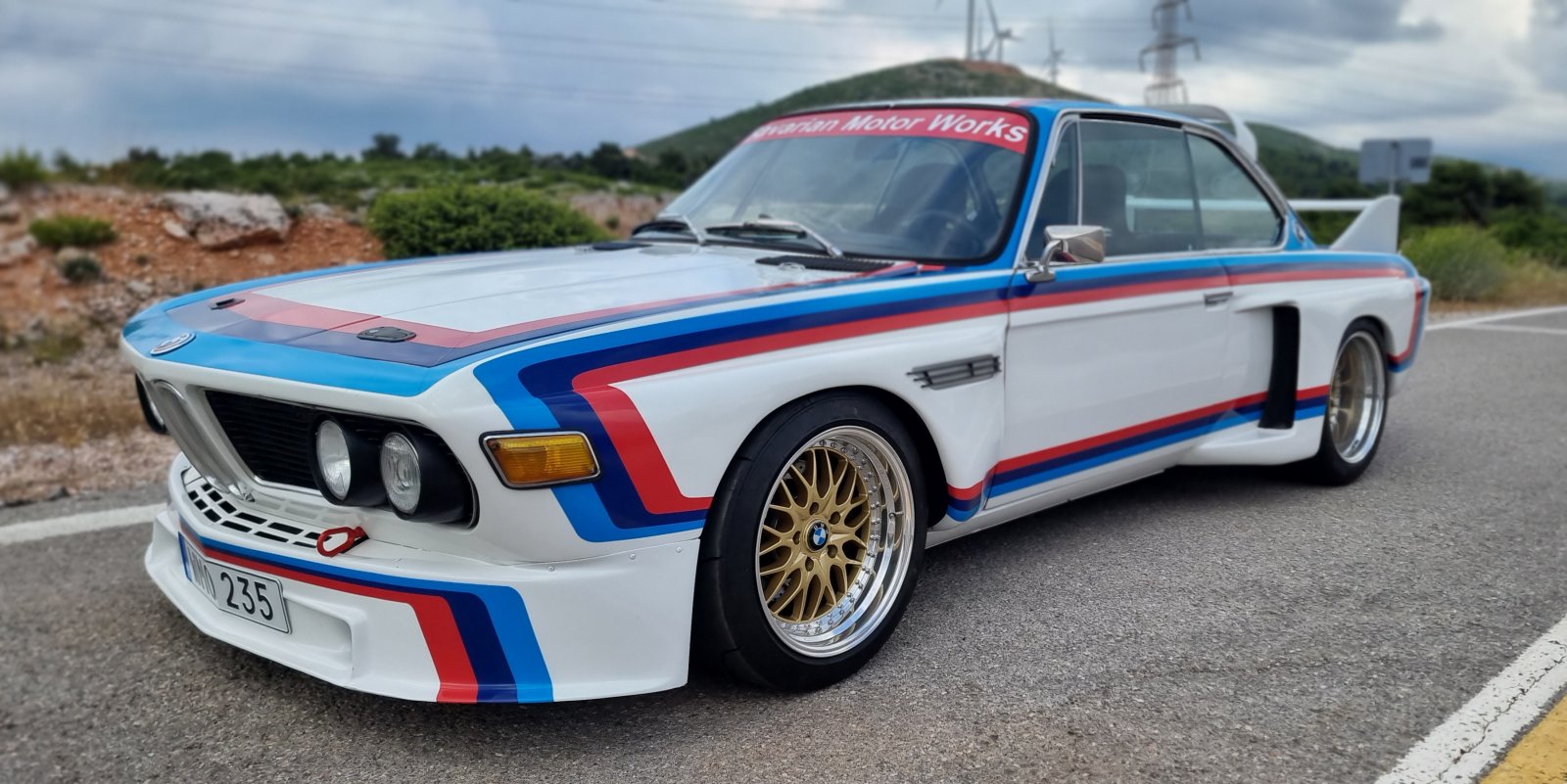

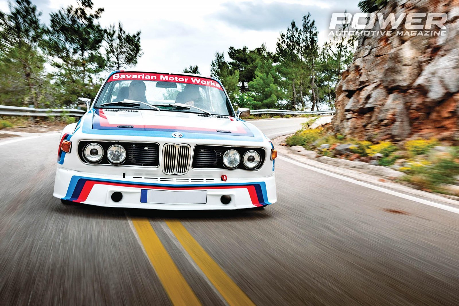

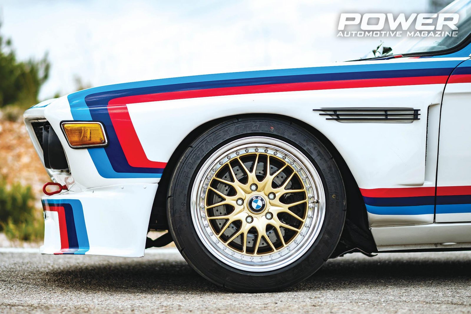

I just finished that beautiful e9.
My friend and customer needs a group 4 outside car but with more power and not roll cage inside as he wants to drive it on road.
Specs.

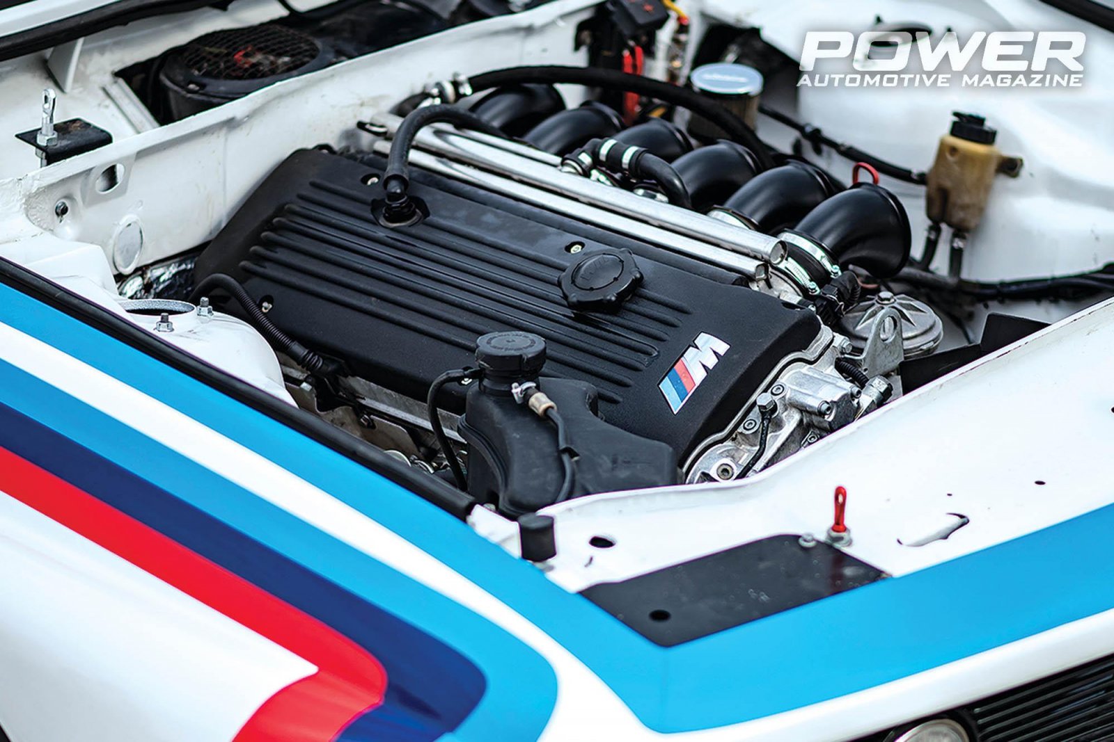

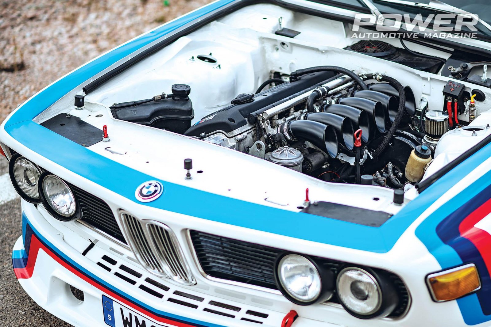

S54 with 6 speed gearbox.
Lsd diff new.
Full exhaust with electric valve for road or race use.
Complete front system from m3 e46 ,rack axles brakes .
Coilover suspension front and rear.

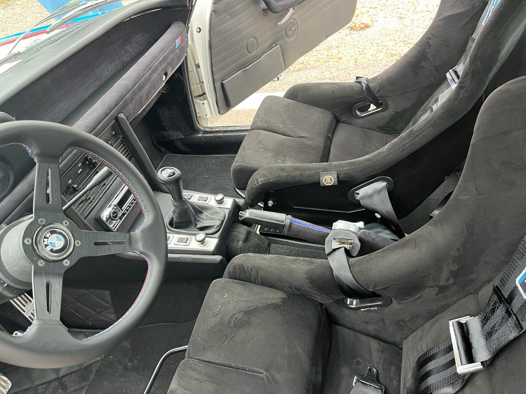

Complete interior Alcantara with leather and m3 e46 cluster.
Kerscher wheels 10.5j front 13j rear .
Car is very fun to drive on road or corners.

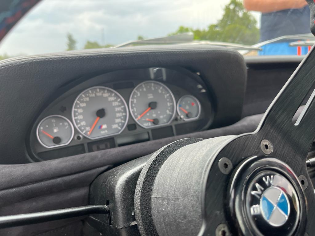

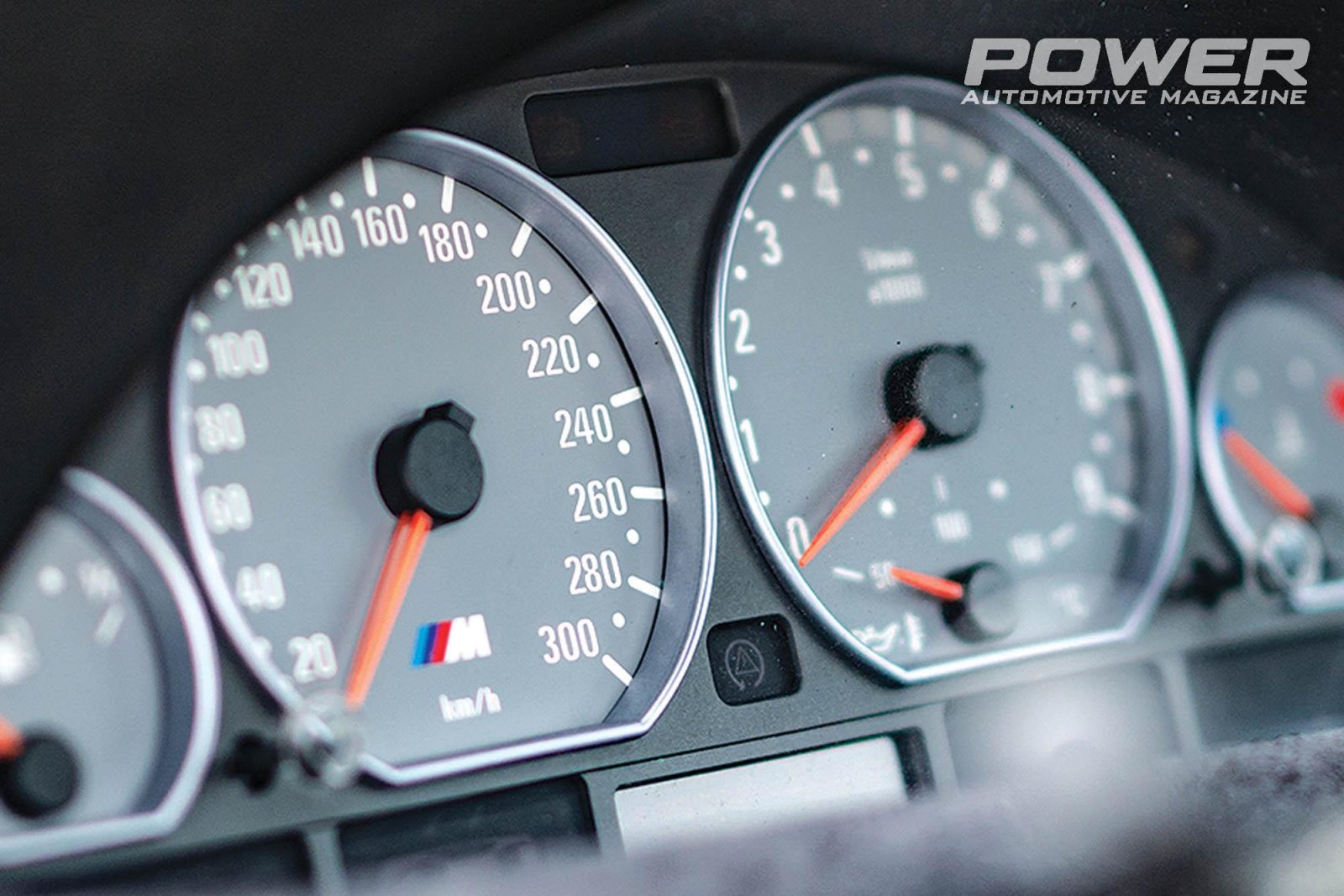

When you rev it high rpm and see how good looking is the shift light of m3 e46 you won't change it with traditional .Also this engines must have oil and water temp.
Client want more racing feel and look.
The classic e9 cluster looks nice on original car with wood everywhere .
But here we are talking about something else.
