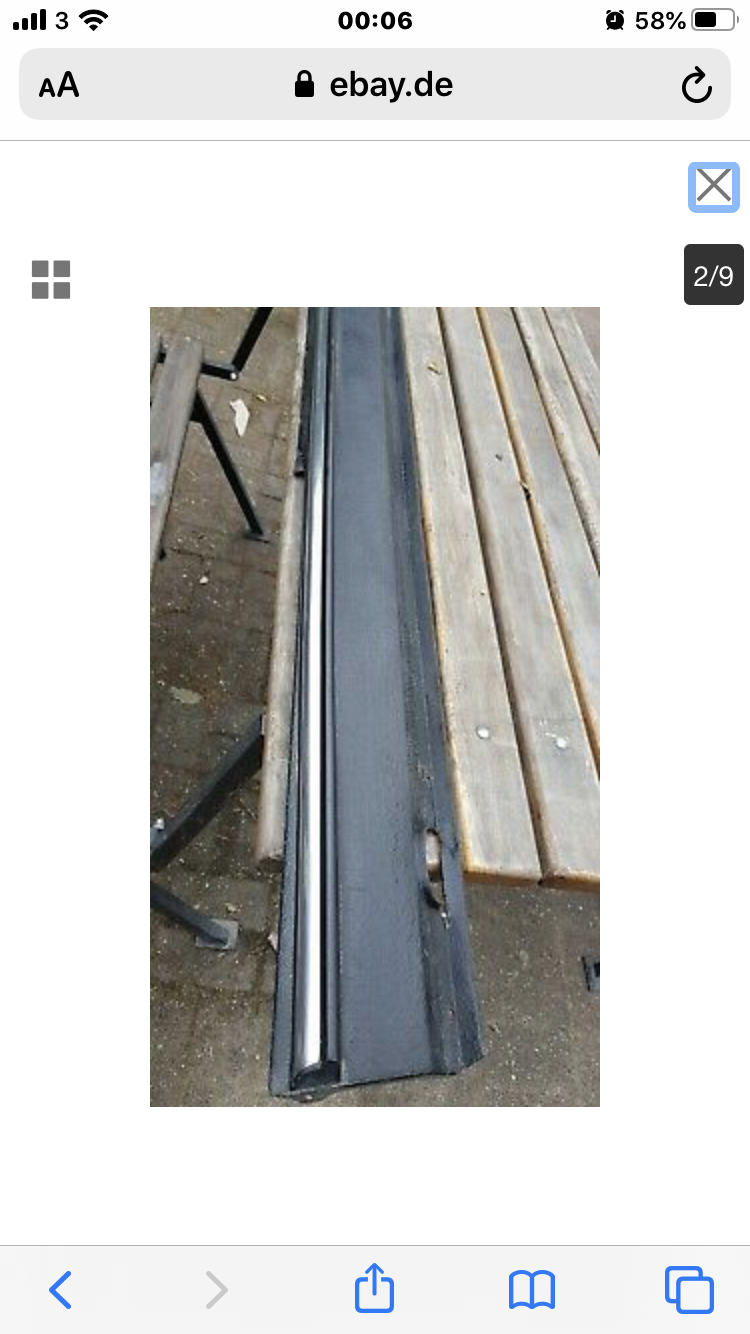

I am wondering if someone would know if the Bmw e3 sill/ rocker trims will fit onto the e9 .
Just the chrome and rubber bit , not the complete outer sill / rocker cover as mine are missing and I have seen a few sets for sale for the e3 , but none for the e9

Okay, thanks for checking,
I wonder if anyone has ever shortened an e3 one to make it work on an e9.

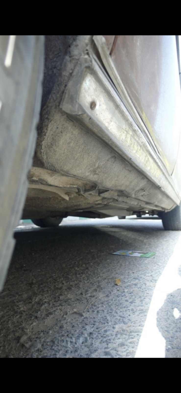

I do think that they are a complete different system. E3 does not have a sill cover like E9 (at least on my 75 3.3L). They just have the molding, that is not the same as e9. Here is a dirty picture of the trim.

Okay , thanks for showing the e3 trim pic earlier , it looks different/ wider than the e9 one alright, now that I could see it more clearly on your pic.
as i mentioned earlier in this thread, there were 2 sizes of the e3 trim - one 40 mm and one 60 mm (according to realoem). both seem bigger than the size of the e9 trim ... but i don't know how they measured it. 40mm is about 1.5" and 60 mm almost 2.25"
