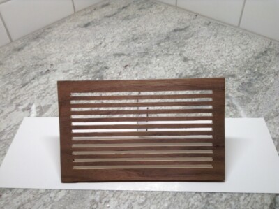

Seems like a fair price. NMNA
Stan, I looked at this a few years back. It is a decent alternative but if you look closely, you will see the slat edges are rounded as would happen with a miter. The original has the slats cut out such that they are squared off.
Good eye, Rob...that is true. I bought one a few years back..
Larry, the gentleman who made/makes these is a former coupe owner, and had them made out of need..he's a good guy. My biggest issue, tho, is the thickness...at 4mm it's almost twice the original, and the wooden slats on the vinyl dash tray don't like that. It is the best alternatative "out there" new. To make them from scratch at the original thickness is difficult...I've tried, and they like to warp and tough to machine the slits...they're so delicate.
Would it be possible to thin it with a joiner or too delicate? If you made a 4mm slot in a backing board that was the same size as the grille, maybe it would work?

I know others here are "real" woodworkers (you guys may chime in)...I sorta chip, whittle, and clamp, occasionally. I think maybe an abrasive planer (one that sands, instead of cuts) might work. A jointer would probably eat it, and I wouldn't do it with my fingers...biggest problem is the physics of plywood...always an odd number of plies for balance...and IIRC, the walnut veneer made this an even number, and it will warp....I seem to think that's why I tossed the one I bought in a box..somewhere...I'll try to dig it out to check my memory...
I was envisioning a board that was quite a bit longer than the speaker grille with a speaker-sized slot dadoed into it at 4mm deep. That way the grille would be supported from the top, leading and trailing edges. The blades would start shaving the sacrificial backing board and then hopefully keep shaving the grille without destroying it when it got to them. I'm sure you're right about the plywood issues - didn't think of that.

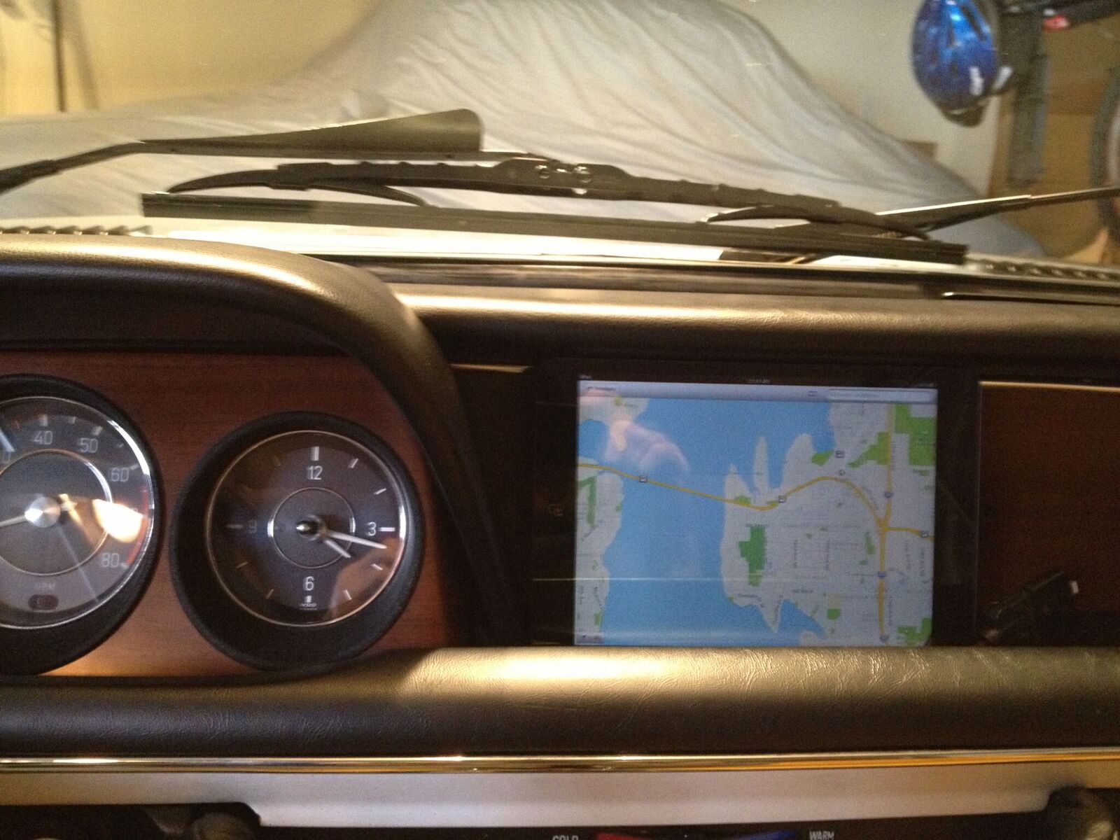

A good idea for filling that hole if you don't want to utilize a speaker cover:

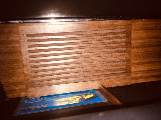

OK to be crazy and anal, my original one was in 3 pieces, I gingerly rebuilt it and then re-veneered the thing. I used a scalpel to cut each opening. This was a labor of love or insanity (or both).

Hello, it is very hard ti make one I do not have the patient, I just cover the hole with veneered complete board, I can not stand the speaker cover it is much nicer without the speaker.

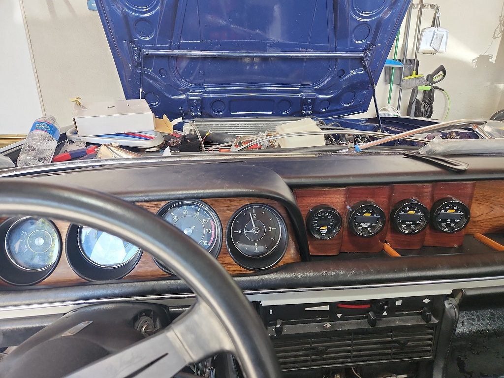

Hello, you are right for my one of E9 I need it extra gages for E46 engine on it but other is nothing in there but my 2 E9 have electronic rear view mirror with navigation

Interesting. Was it mounted in the speaker cover/grille?
