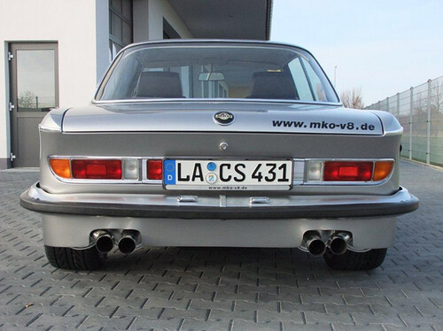

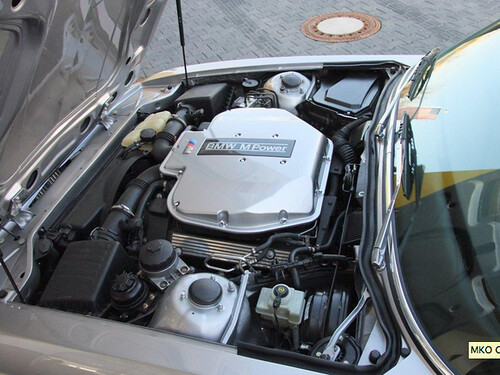

Back to the OP. There are a few S38 (M5M6 engine) coupes rolling around the US. Saw one at Hilton Head Concours last year. That's 255 HP stock and in my case 345 in my E28 M5.
Mko v8
Please tell us all about the www.mko-v8.de correct?
I heard about this car on my last visit to Germany, but did not have time to visit, so I hope to go to MKO next time I am there.
Apparently they took an e39 M5 and put not only the drivetrain but the modern dash, 6 speed and ABS, etc.
I found this excerpt from a german magazine. With google translate you can get to the heart of it, but essentially it says what I have told you above.
http://www.fxgraphix.de/mko/source/presse/bmw_power_5-12.pdf
This is the PDF file of the car.
They also did a V8 in 2002. Which was another project I have pondered.
http://www.fxgraphix.de/mko/source/presse/Blackmagazine.pdf
This article revealed more. I was curious about the shock towers in the CS, as they look like the E39 towers, sure enough:
"Michael raised the ramp the CS was on and I was astonished to
see that it was actually a 3.0CS body on a shortened E39 M5
chassis. One of the best engines and chassis BMW has ever made
combined with one of their most beautiful classic body designs.
With the wider tracks of the M5, the CS’s bodyshell had to be
subtly altered with wider wheelarch flares. In the case of the
rear, the flaring starts at the sill area in front of the rear arches
but you have to look closely to spot it.
With its wider tracks, lower ride height and modern alloy
wheels the CS Coupé takes on a much meaner and more
purposeful stance than the original. I have to confess that the
look of this modern classic with its slim roof pillars appeals to
me more than most current cars regardless of cost.
Despite the 3,000 man-hours it takes to build the CS/M5, it
costs just 150,000 euros (SGD250,000). “This is because I use a
workshop in Romania for the major work,” he explained."

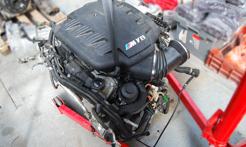

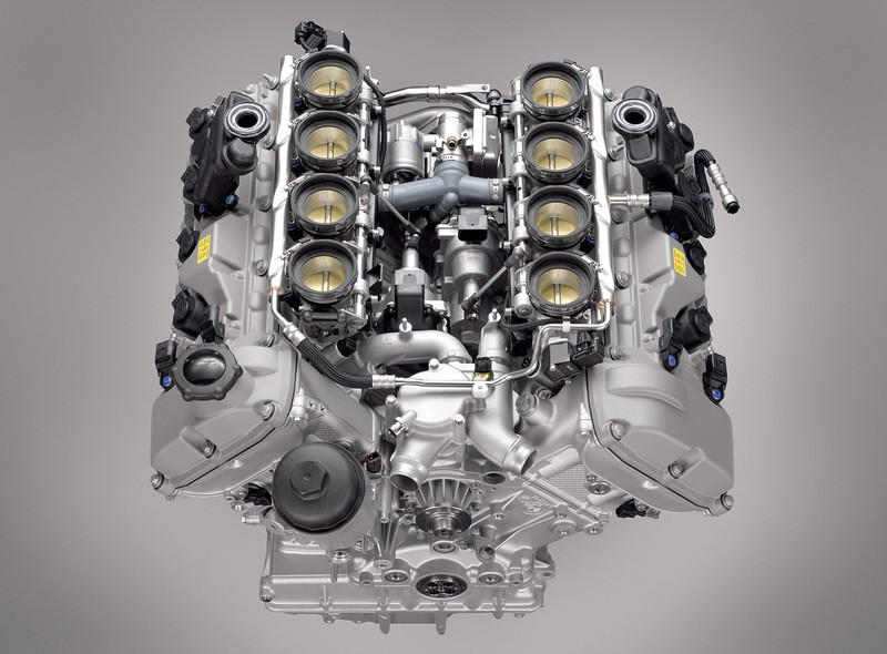

Okay - the problem seems to be getting worse. I can not let go of this idea. I have done some odd things with motors and cars in the past, but this one seems too good to not try. You would think after hitting 50 this lunacy would stop.
So the concept is pretty simple. Build an E9 based 4.0 CSI, based on the 2008 BMW S65 V8. The idea would be if BMW was building an e9 in 2008, as a retro model and had to use the previous skin, what would they put in it?
These engines are about 30 lbs heavier than the 6 cylinder and are very dense. The 6 speed gearbox seems to be a pretty close fit as well from simple math, but obviously it is time to either render it all up in cad or try the garage fit.
The problem? I have no E9 yet. Lets see if this really takes hold or is based on the fact I already bought the drivetrain.
My question to all is, would anyone recommend someone to blueprint one of these? No need to stroke, I think I am going to have ample power and torque for this chassis. *Dinan and RDsport both do a 4.7 Liter stroker out of this hitting 500hp. I imagine they would be very expensive to blueprint and refresh this motor: 11,000 miles:
Tell me I am crazy.
