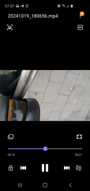

The rivets are the right use.
To remove the rubber, just dismount the override , bent if thre "crimp" on the other end, then you can just pull off the rubber from the override till the outer end.
Tip mount back thre rubber, start the other way.
Bent the rubber in a180 degrees loop, that will "open" the rubber more and he just slip over the metal stripe.
A little bit soap water help.
Breiti

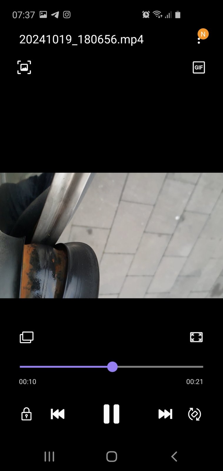

Pop rivets work well for this application.
Tip mount back thre rubber, start the other way. Bent the rubber in a180 degrees loop, that will "open" the rubber more and he just slip over the metal stripe.
It's kind of slick the way the rubber will re-attach itself to the metal strip when you manipulate it as Brieti describes. But doing the rear bumper is a little tricky, since you need to start in the center and then stuff the outer ends of the rubber into the notch in the metal bumper. The fronts are easier, as you can start at the outer ends, and hook the rubber onto the metal strip toward the center.
