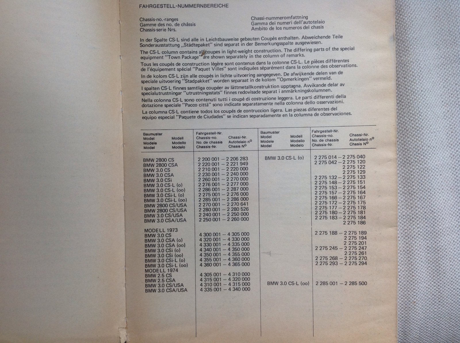

So there we have it, factory built RHD 3.0 e9 coupes were available from 15th July 1971 both with auto and manual boxes. Following the intro of the RHD CSi on 7th June 1972 , the auto box was only available with carbs and the manual box only with injection. However, as the concessionaire at the time probably had a fair number of cars waiting a purchaser, it seems likely that some carbed manuals might have been sold after the cut off date. A factory RHD auto injection model seems very unlikely.
It seems that the factory did not specify LHD or RHD in the parts book from which the thumbnail above was taken as there is a RHD CSi with a chassis 22654..
It seems they only specified L or R HD with the CSl and the 74 models.
