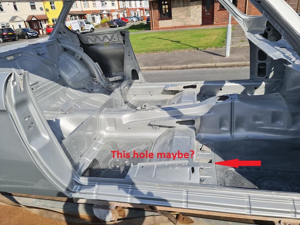

Would this be the hole the loom disappears down into? (Not my photo).
Andy- that doesn’t look correct.

This maybe the first and only time where i think I can beat Mr E9, the Don himself.
In his defense, 4 am is hardly anybodies time of the day to be sharp. But it does speak of devotion when you're forum-ing at that time...
I actually do think that the rectangular hole in your picture IS the hole in which the harness disappears.
Under that hole for sure is the frame rails. It has a direct channel towards the front right side of the engine.
The harness can pop out under the coil in the engine compartment as @Markos noted.
But, small disclaimer: I have only seen images of this wiring there, so I could be mistaking. My car is a carbed automatic, so a different animal all together.

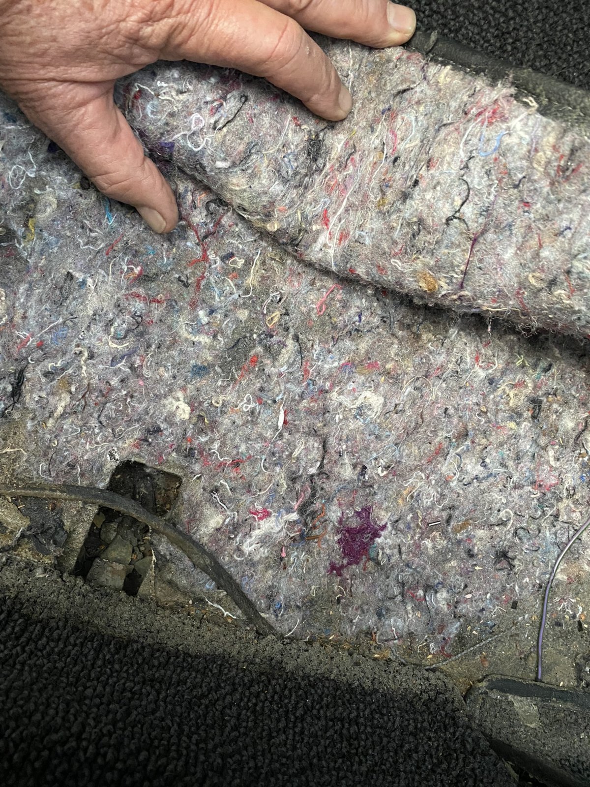

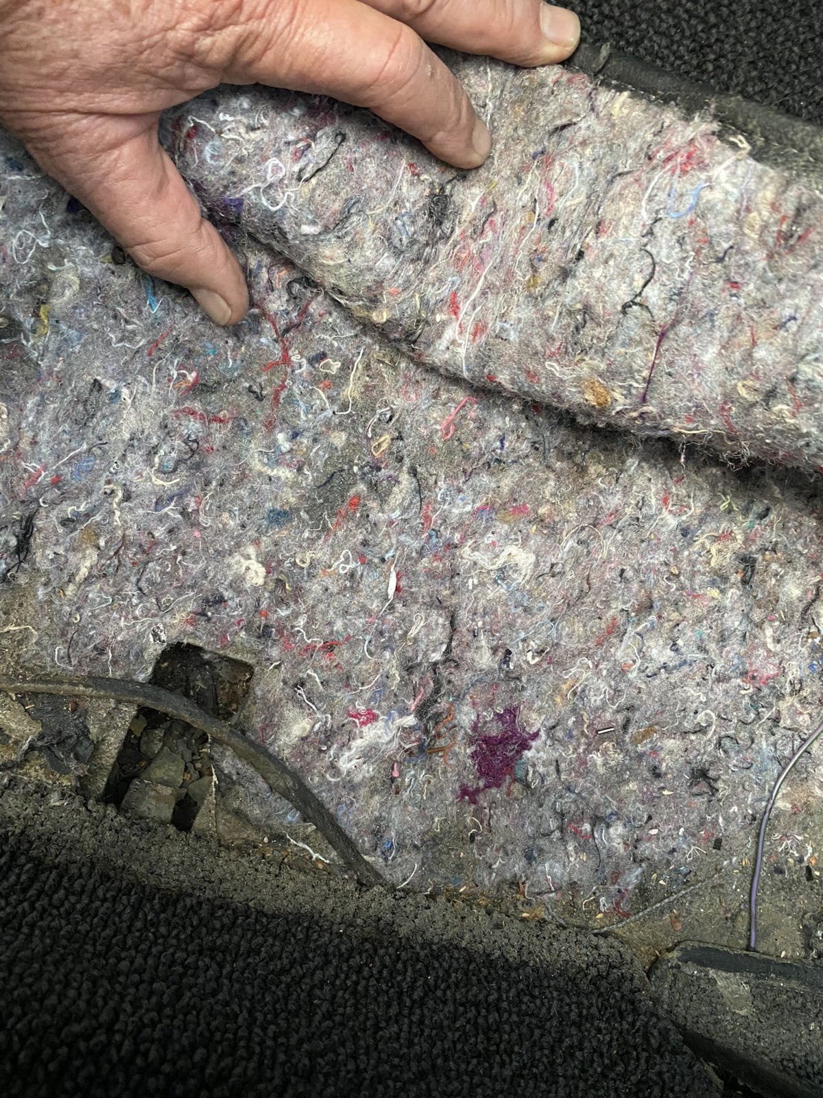

Andy- I have 2 csi‘s in the driveway and 2 more at my 1 shop and 2 Csl‘s at my 2 shop.
I just checked one csi in driveway- carpet glued down.
Ka-ching we have a winner. Erik is correct!
