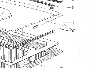

As I mentioned in my old sunroof thread at https://e9coupe.com/forum/threads/sunroof-howto-wanted.18413/ , the rear rises when the little plastic triangle on the panel hits the big round dowel in the track on the car. You are probably missing the triangles (Part #10 in the W&N image below). I have recently had a similar conversation with another member. I think these are NLA but might be available from other manufacturers (Volvo, Porsche, etc) who also used Golde sunroofs. If you can't find them I think we could 3D print some with little difficulty. They are not visible so the replacement just needs to be functional.

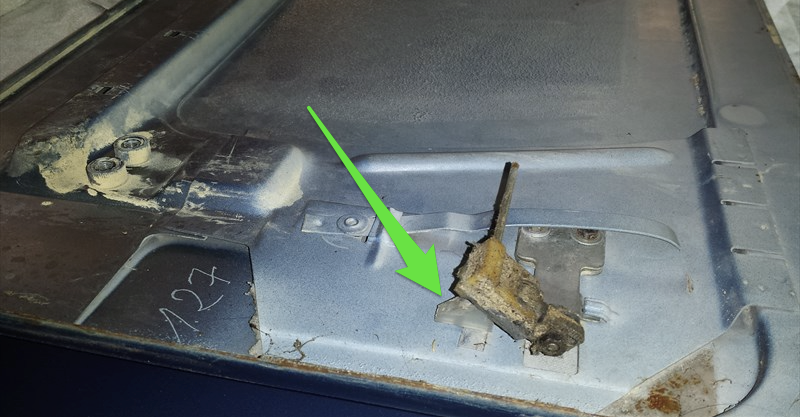

Hinge is resting against it here:

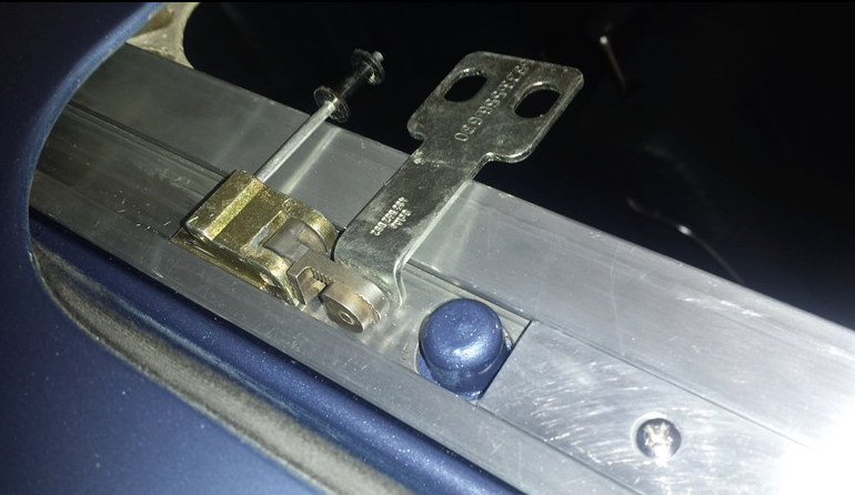

The "dowel" it rides up upon:
