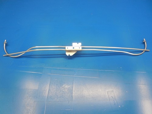

Electric Sunroof Cable Tubing Carrier
bavbob
3,768
1,869
Boston, Ma
See #3 below.
Each tube holds a metal cable that fits to one side of the roof. I have one tube with the metal cable totally rusted and wont budge. I have used heat, put PB blaster down the tube, a lot of PB blaster and let it sit for days, no go. I appreciate any other ideas. Right now I am tracking down tubing to make my own but having some difficulty finding 3feet of 7mm ODx5mm ID tubing. Thanks
