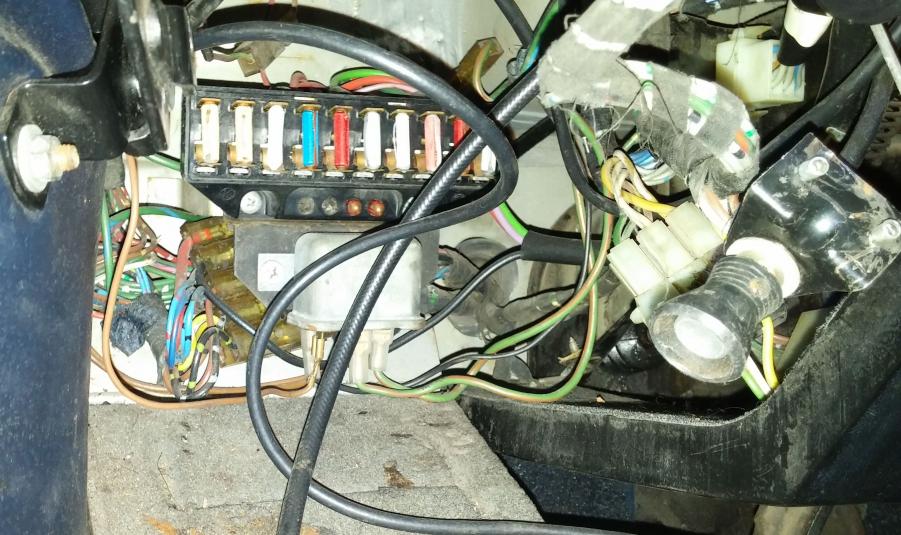

Pic of the inside of the hood release area.
Where does the odometer reset knob normally attach to? Seems the rivets broke off.
What are these fuses for? No labels anywhere.
What's that big relay for?

The wiper motor IS on a relay. The relay is located above the hood latch mechanism.
You might want to disconnect the arm from the motor and make sure the wiper mechanism moves freely. Next, check the small ground wire on the wiper motor that is separate from the wiring connector. After that, I would check the connections to the switch in the console and the operation of the switch itself. Then, its basic circuit testing from there. I believe the motors themselves to be very robust; it is not likely this is your problem.

That relay is only found on cars with air conditioning; it disables the heater blower motor when the a/c is engaged so you don't have heat blowing into the car while trying to cool it.
