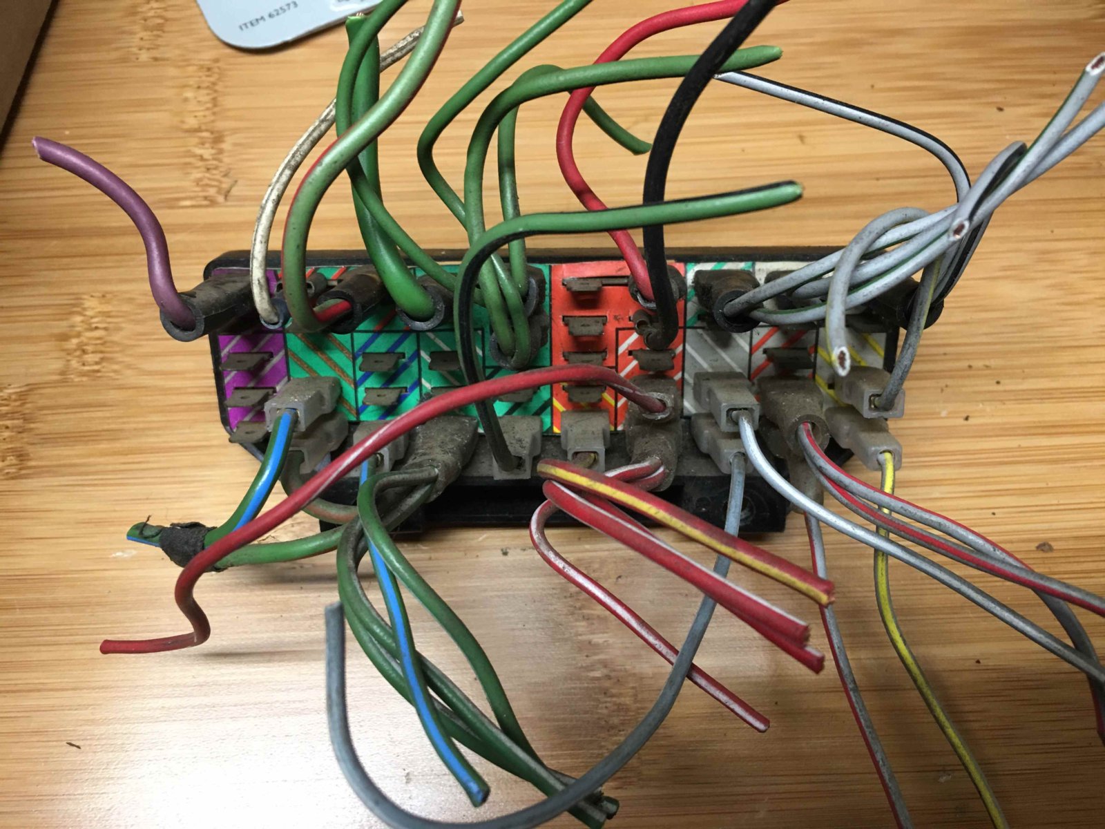

I have already posted that I have a 73 euro (6/28/73) 3.0 Cs with no power to the back windows ( fronts are manual) or sunroof. The car will run and the dash lights all work as well as the instruments. I have read thru countless posts on electrical issues. I believe my load shedding relay is working and there is power across the fuses. As usual, there has been a bunch of aftermarket alterations. I present images below of what I have: I believe the fuse box setup to be incorrect, the relays ok. ....I am totally lost and have spent 5 hours upside down with no insight.

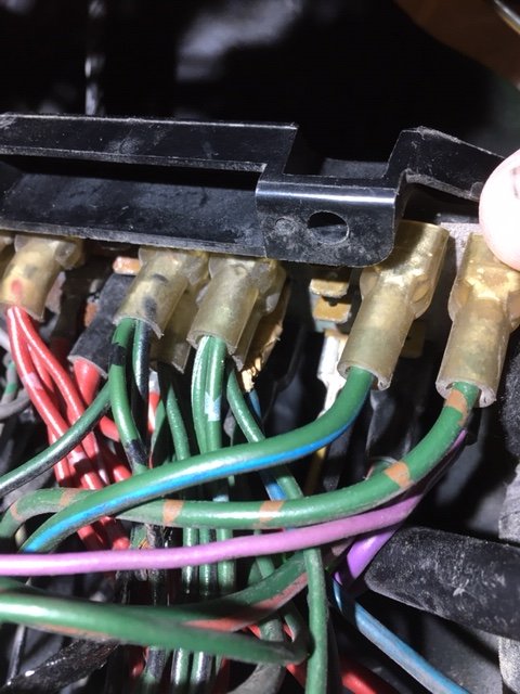

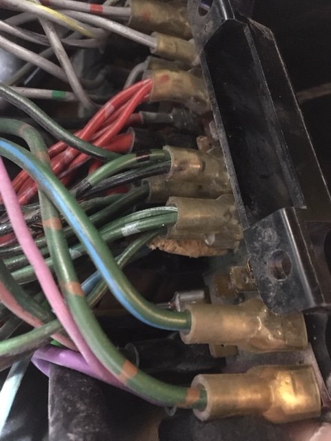

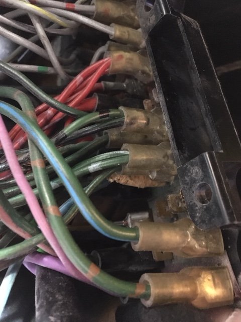

Fuse Box Rear from #10(bottom) to top

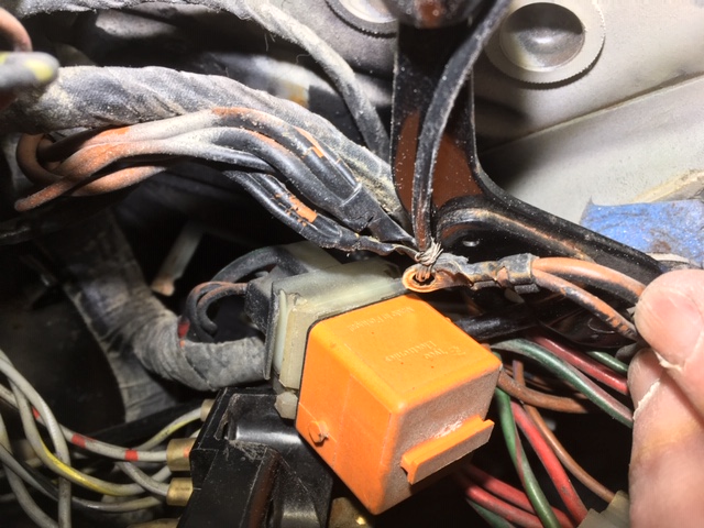

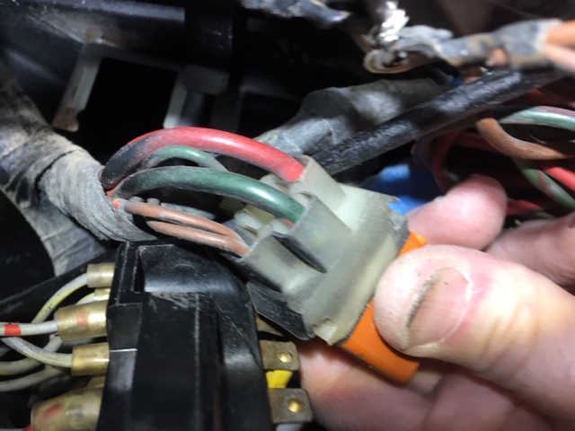

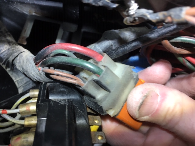

Relays under dash, believe the one with the black relay to be the Load shedding relay, other a window relay.

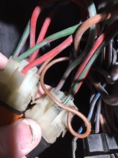

There is another relay besides the signal relay, way back in the dash

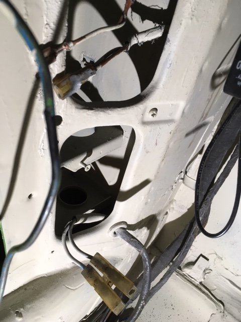

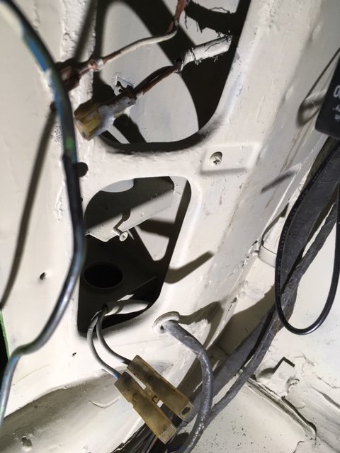

and the wiring to the door switch and what I believe to be dead wiring for a potential front door power window set up.

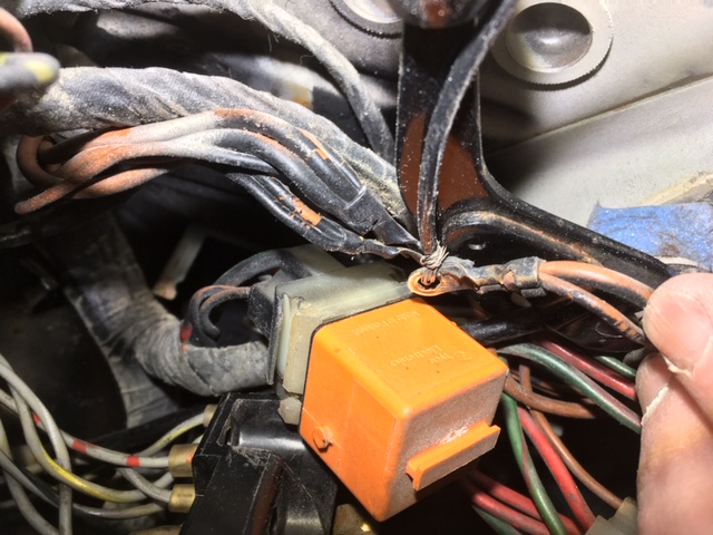

There was also this junction of 3 sets of brown wires joined to the body of the car/common ground. I bypassed the current ground for another due to rust and poor contact. Interestingly, one of these already contains a ground cause when I join the 3 alone, the black relay in the image above clicks.

4) Fuse 10 should have a green/blue wire for the sunroof, it is not there. The sunroof switch is new and it has a green/blue wire to it so not sure where the thing went to.

Chris: I had read your post and confirmed all the wiring to the relays. The "nest" of brown wires that are screwed into the front fender were all pulled and cleaned and replaced. I did notice that with the ignition on, one of the relays clicked on when touching all the brown wires together indicating that one set of these was already grounded, at least that is how I interpret it. Also, I have the door dome light switches out and the wires hanging in the breeze. I did confirm that I was getting voltage to the dome light wire though the light is not installed.

I have zero power to the sunroof. Again, there is no green/blue wire from fuse 10. In my original post, the first image shows what I had at fuse 10. You can see the green/brown wire on 10 when in fact , that should be on 8. Hence at fuse 10 I now have two violet wires only. I plan to run a wire from 10 directly to the sunroof switch at the terminal that has a green/blue wire.
Is the green/blue wire in my first pic at #9 supposed to have a piggyback to #10? I recall a picture, perhaps by Markos of the back of the fuse box and there was a green wire piggy back setup.

With ignition on, hearing the click when grounding the brown wires is good, it indicates that one of the relays is working. You should get the same response when grounding the second ground wire at the drivers A pillar. Ground this wire again with ignition off, not the dome light wire.
Thanks for this, I thought it was to #10. Did this fuse box come from a car with an electric sunroof? I think the purple wire at 10 is for the ignition but where is the input across #10?
Unfortunately I couldn’t say. It’s not from my parts car. Other than triaging a few issues and stripping out all of the extras, I haven’t concerned myself with wiring. My 2800 is as spartan as you can get, so the wiring is beautifully simple.
I know this is unrelated to your specific issue, but since this picture has arisen yet again (Thanks Markos), and I have spent hours staring at it, I can answer this question. Fuse number 10 on this fuse block is for the radio circuit.
