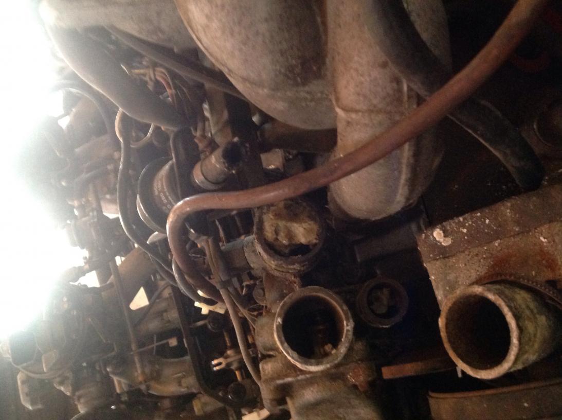

Well, over the weekend, I decides to begin dismantling my cooling system in order to install a new tstat housing, tstat, water pump and all new hoses. In doing so, I found this:

How can I assess what I am dealing with? I am concerned about possible corrosion inside the engine, within the radiator and inside the heater core.
Do I just flush and hope for the best?
The water divider corrodes easily, best to find a good used one if it's really bad. The firewall ground strap is important, mine is grounded to the intake runner. Without it according to SFDon, it can cause starting issues and/or Alt issues, he can elaborate hopefully.
The thermostat housing looks to be just simple aluminum corrosion, flush your block by draining the radiator and unscrewing the drain plug on the back passenger side of the block. Run a hose from the top side to wash as much stuff out as possible. I do this when warm (not hot) like an oil change to get suspended crap out. Don't run cold water through a hot block. New coolant then do it again in a month or so to see if coolant is tainted. This should minimize aluminum corrosion too.
As for grounds, I am not sure what your second pic shows but I ran a separate wire from negative batt clamp to the alternator housing, then from the altenator housing to the block (one of the oil filter bolts). I also have the stock strap from the firewall to the valve cover and battery to the fender.
Chris, let me know if you need one, I have a couple of the older style dividers (T-stat bodies) laying around but you can get the newer style ones pretty cheap also. Not sure if there really is a performance difference as I had both types on the blue coupe and even in Austin she stayed "cool". Not always so much in the cabin though even with the A/C on.

when i bought my coupe, that was the first action, to renew the cooling system, it looked worse than yours, aluminium corrosion allaround
Thanks guys. Good stuff. I have a new water divider I plan to install. I will also get the ground straps installed as I replace my hoses.

Using distilled water vs tap water is important too. No need to introduce unnecessary minerals. I flush with distilled water and use it for the water/coolant mixture.
