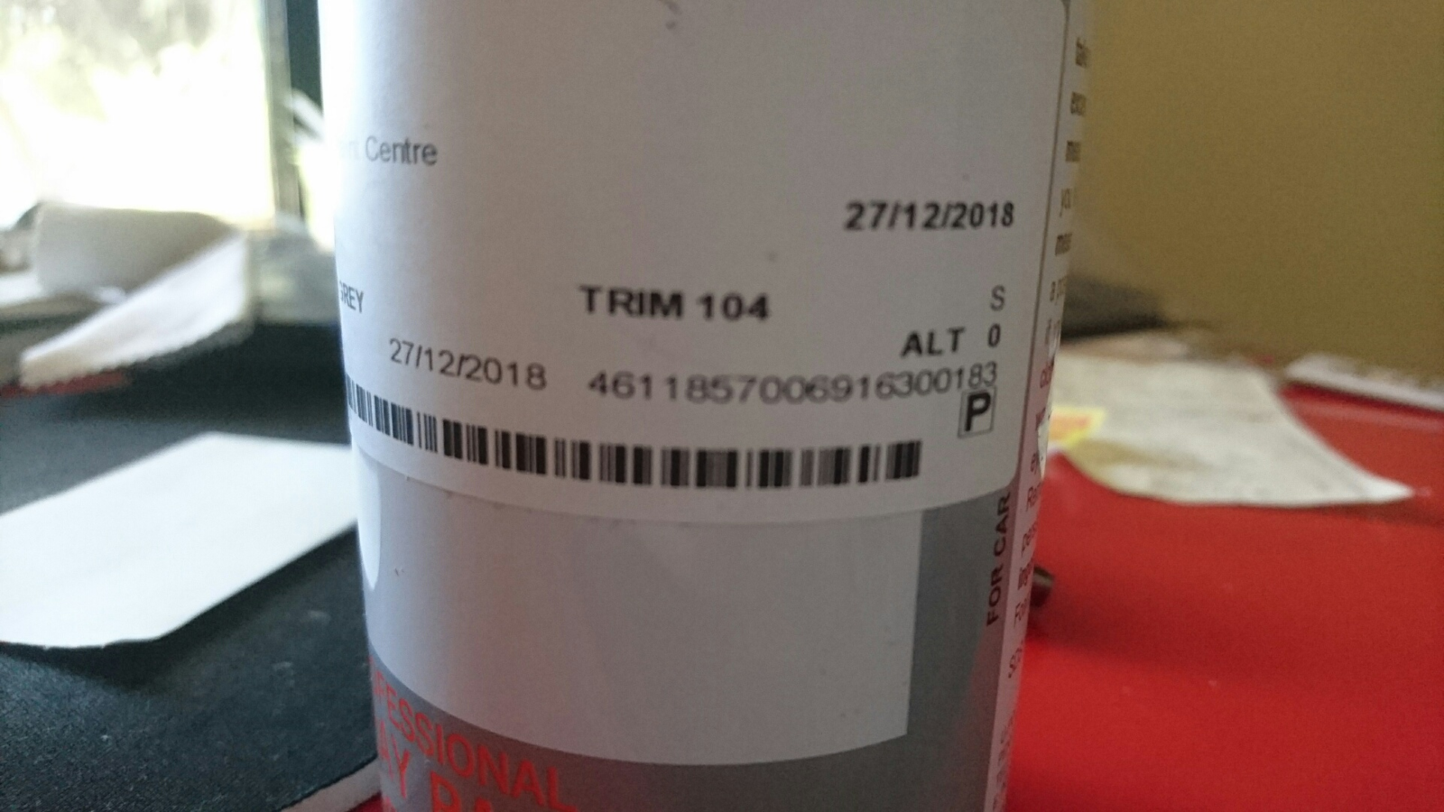

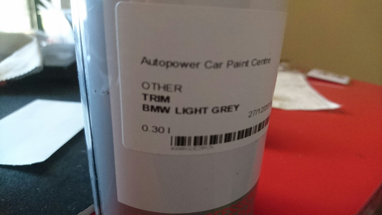

....well, this is the result for the paint code . The sprayed a corner of my elephant skin panel at the paint shop and when i got home I was hard pressed to distinguish where the painted surface was . This was matched to a specific panel from my '74 car so caveat emptor. Cheers, Simon
