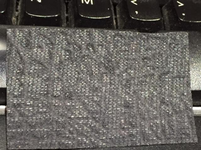

Tolex Pics
For the price per yard - its substantially cheaper than the stuff from BMW ... you can buy a bunch of cans of SEM storm gray and still come out way ahead.
Here are two pictures of the black tolex sample I got from them. Still looking for the silver one.
