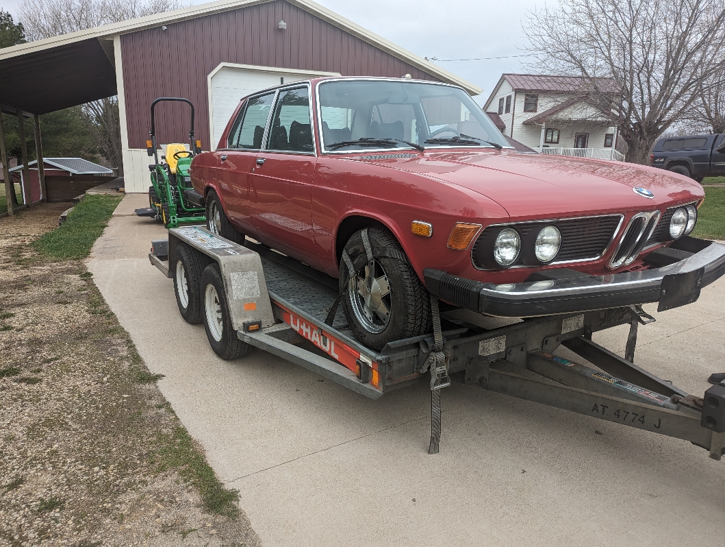

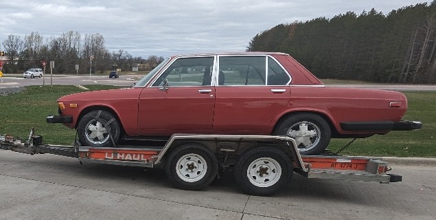

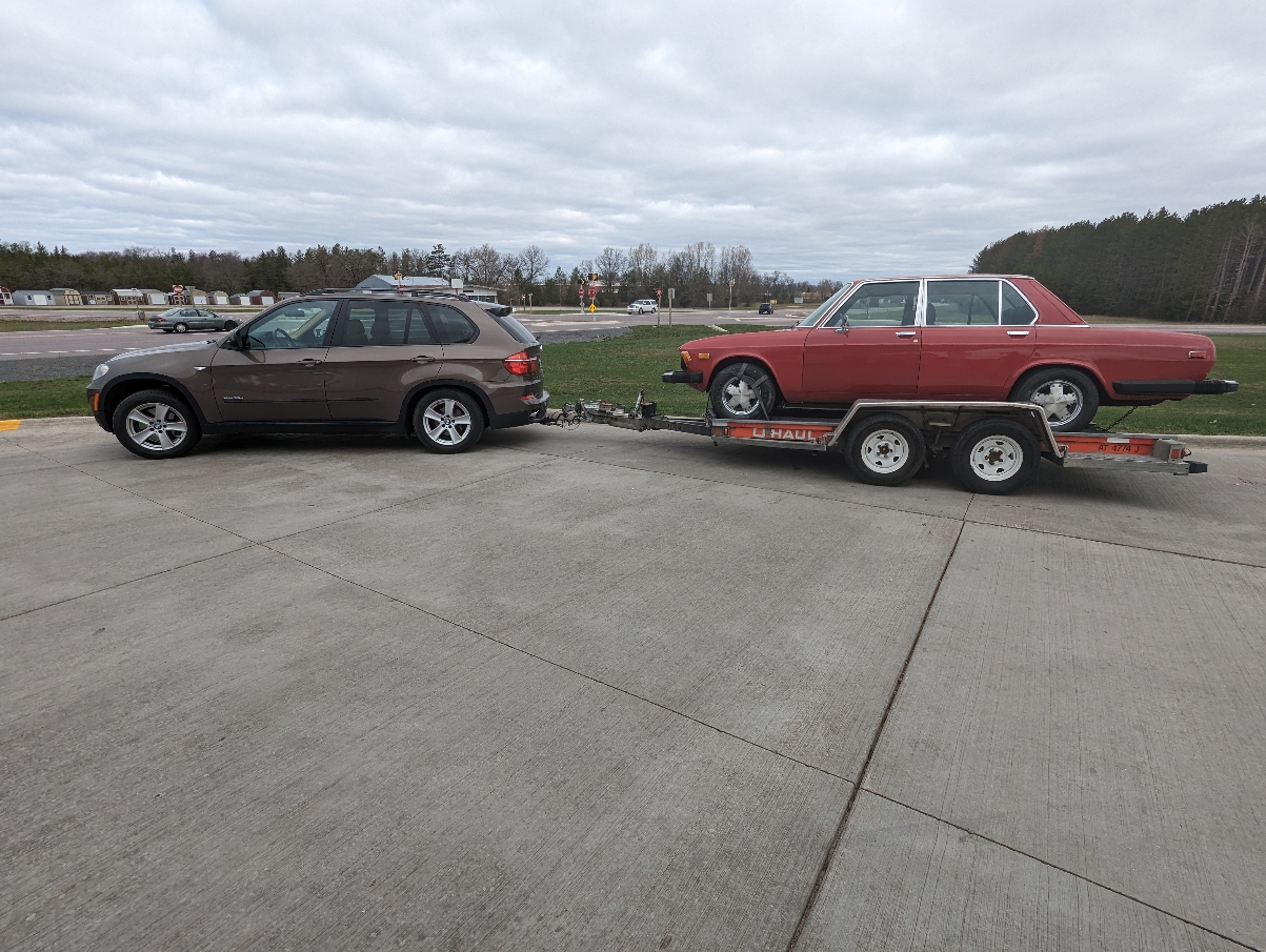

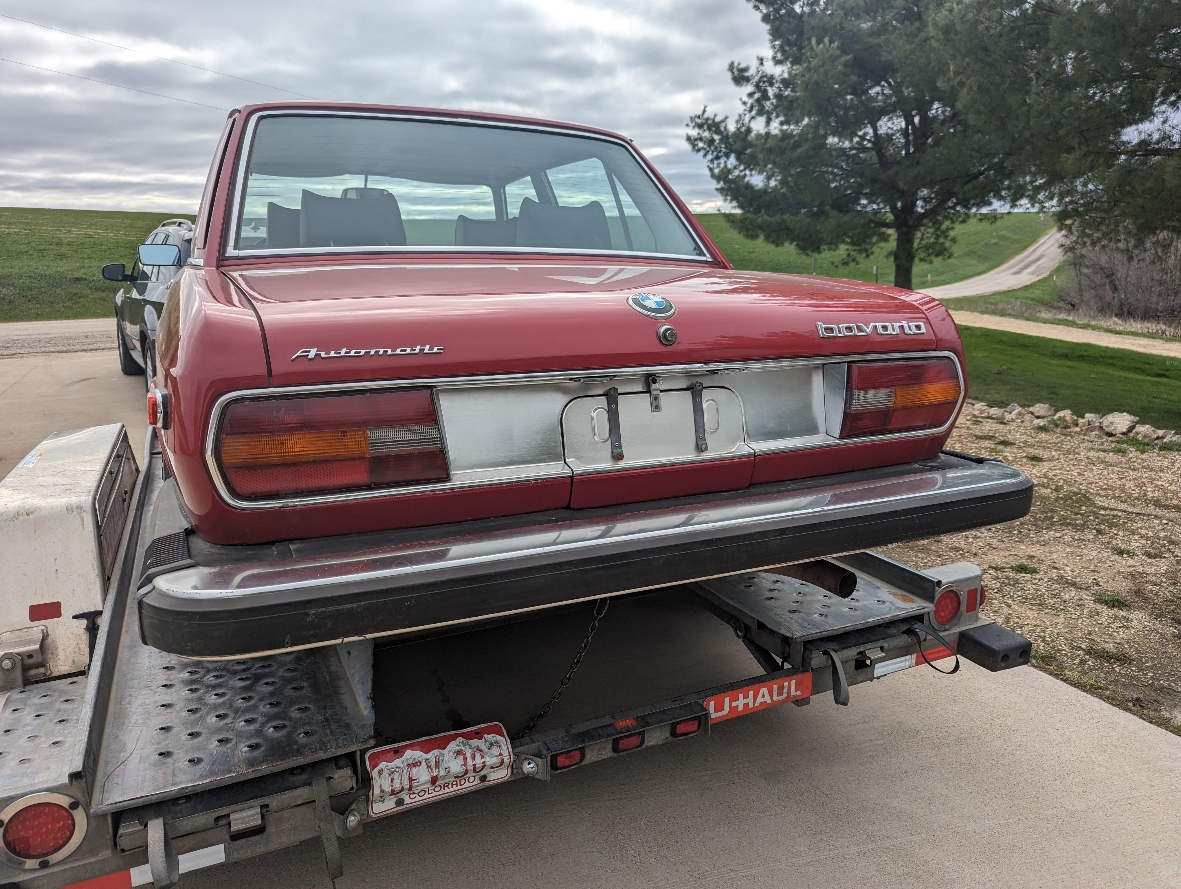

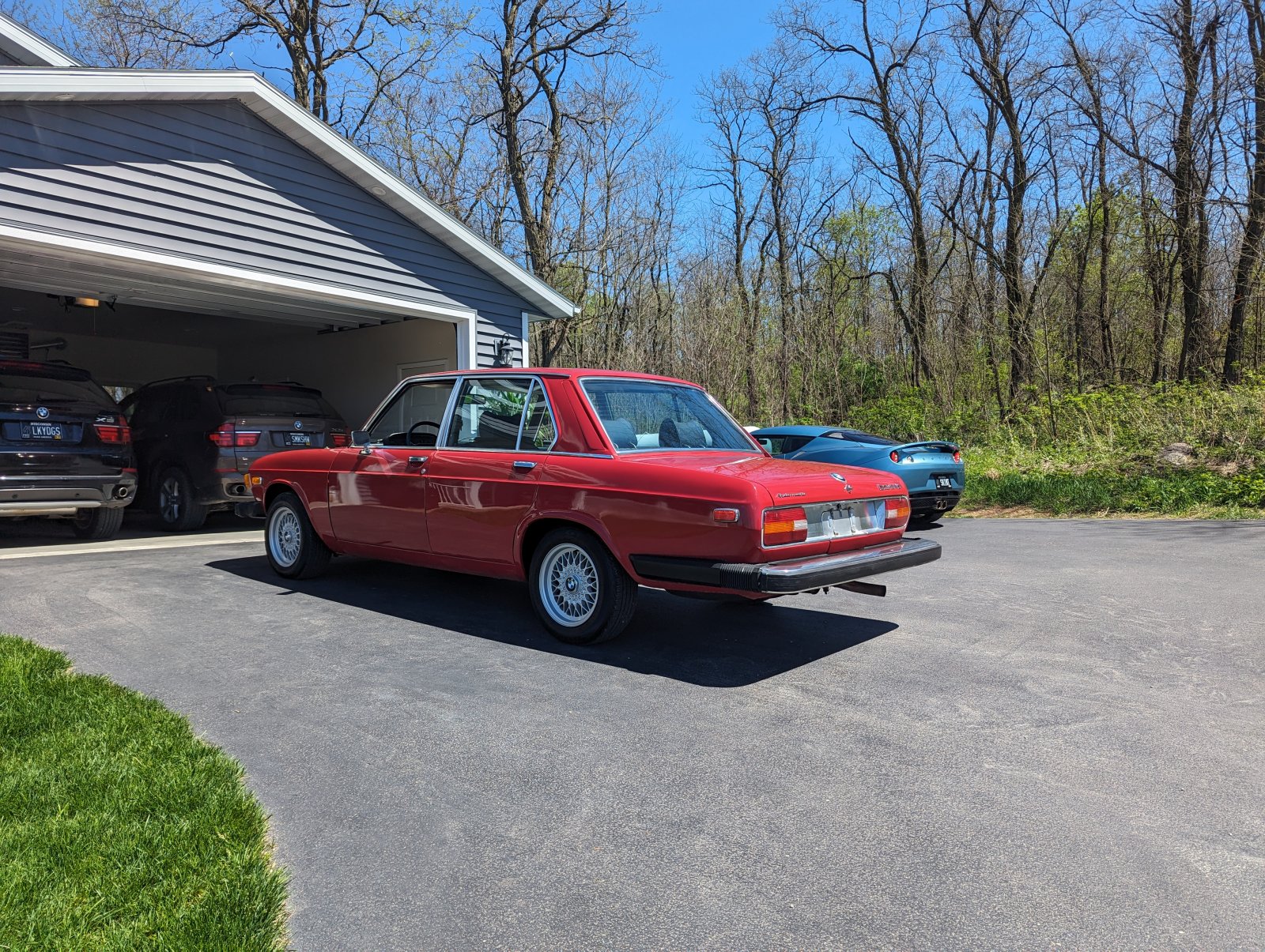

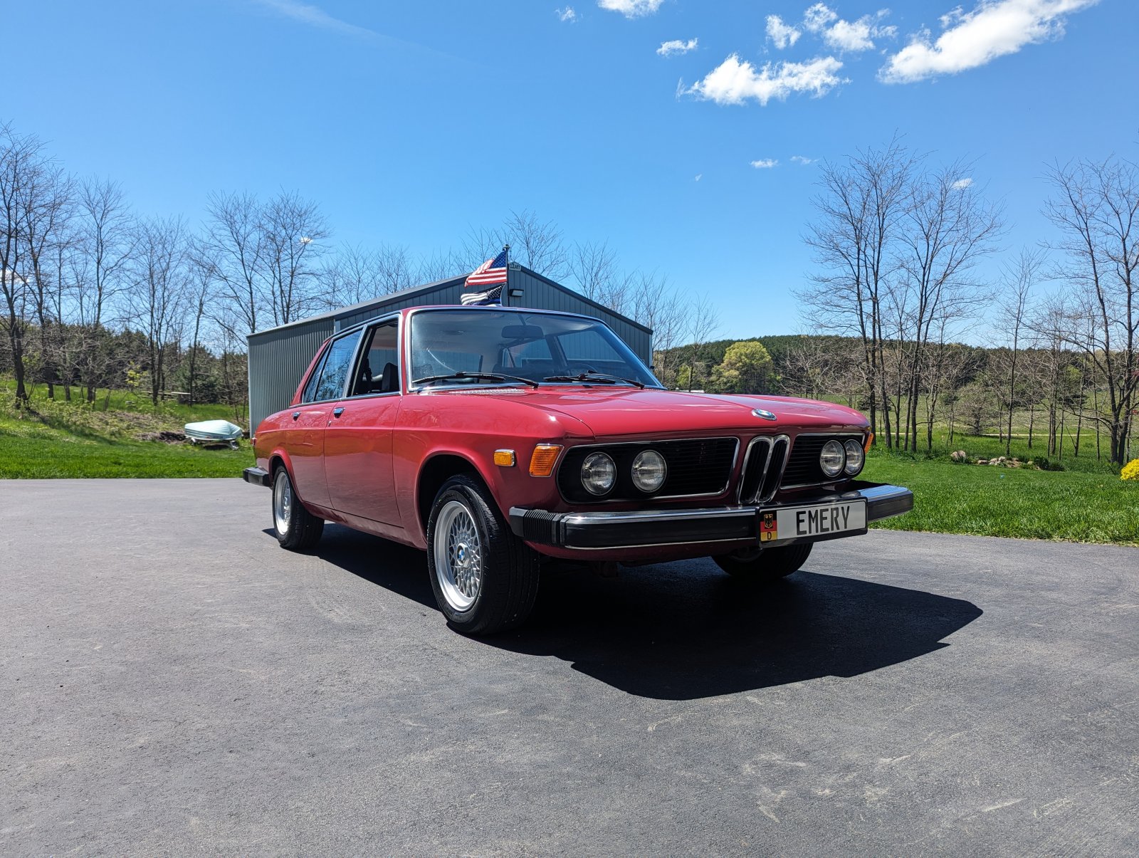

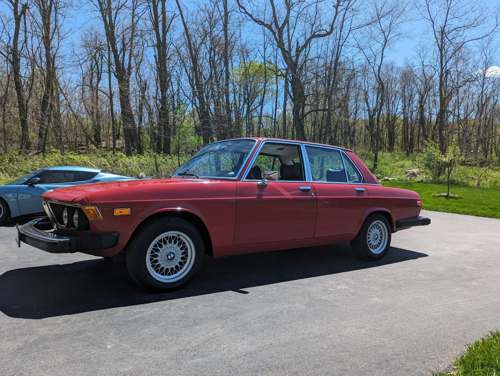

Here is "Emery". She's a 1974 Bavaria 3.0s that has been parked as part of a collection since 1984. We've have been wanting a 2002, but finding nice ones without taking out a second mortgage is near impossible.
Cruising FB marketplace, we found this Bavaria and decided take a peek at it. The first time I saw a Bavaria was at the Vintage in 2022, and there only was 3 of them.

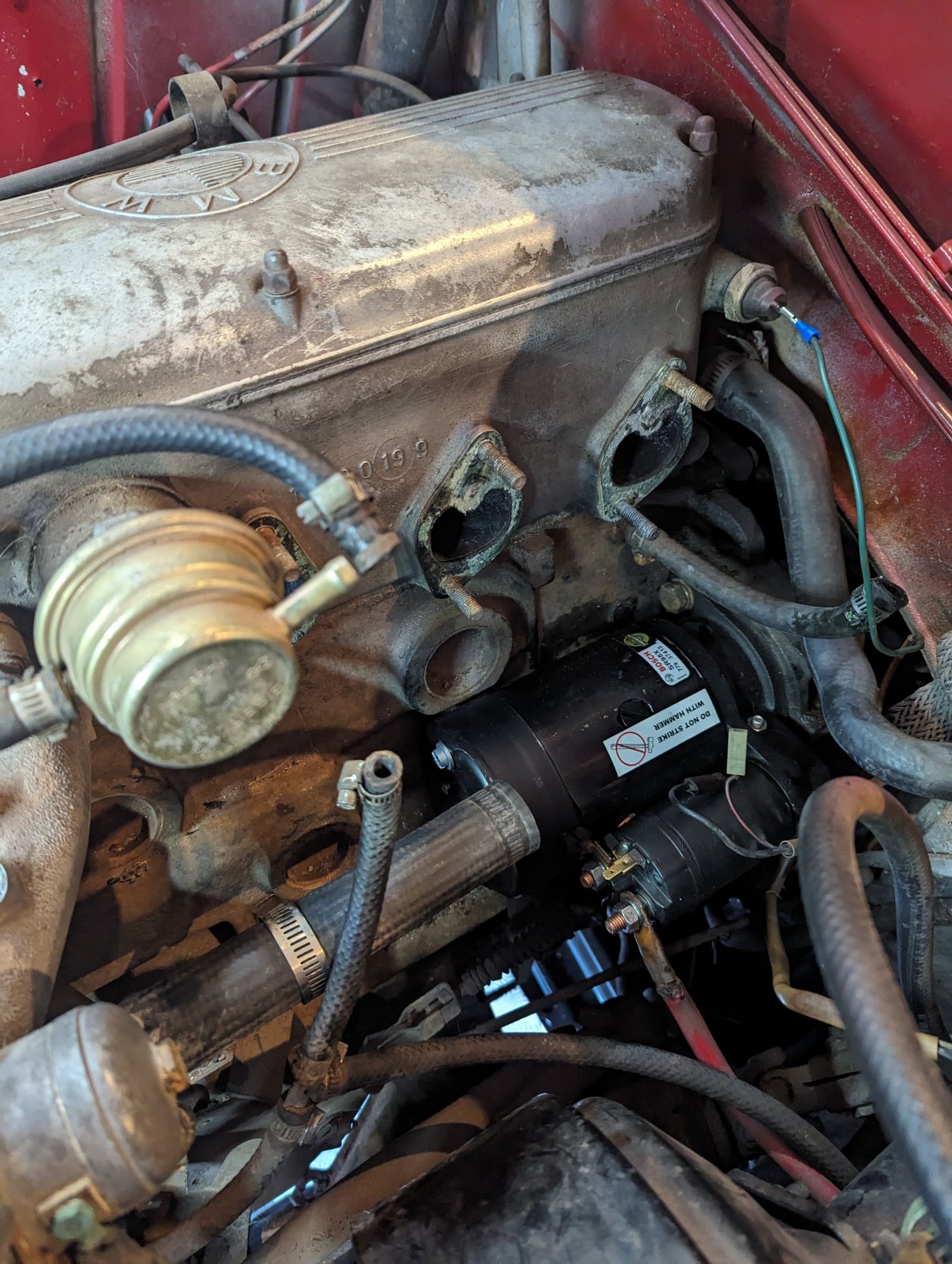

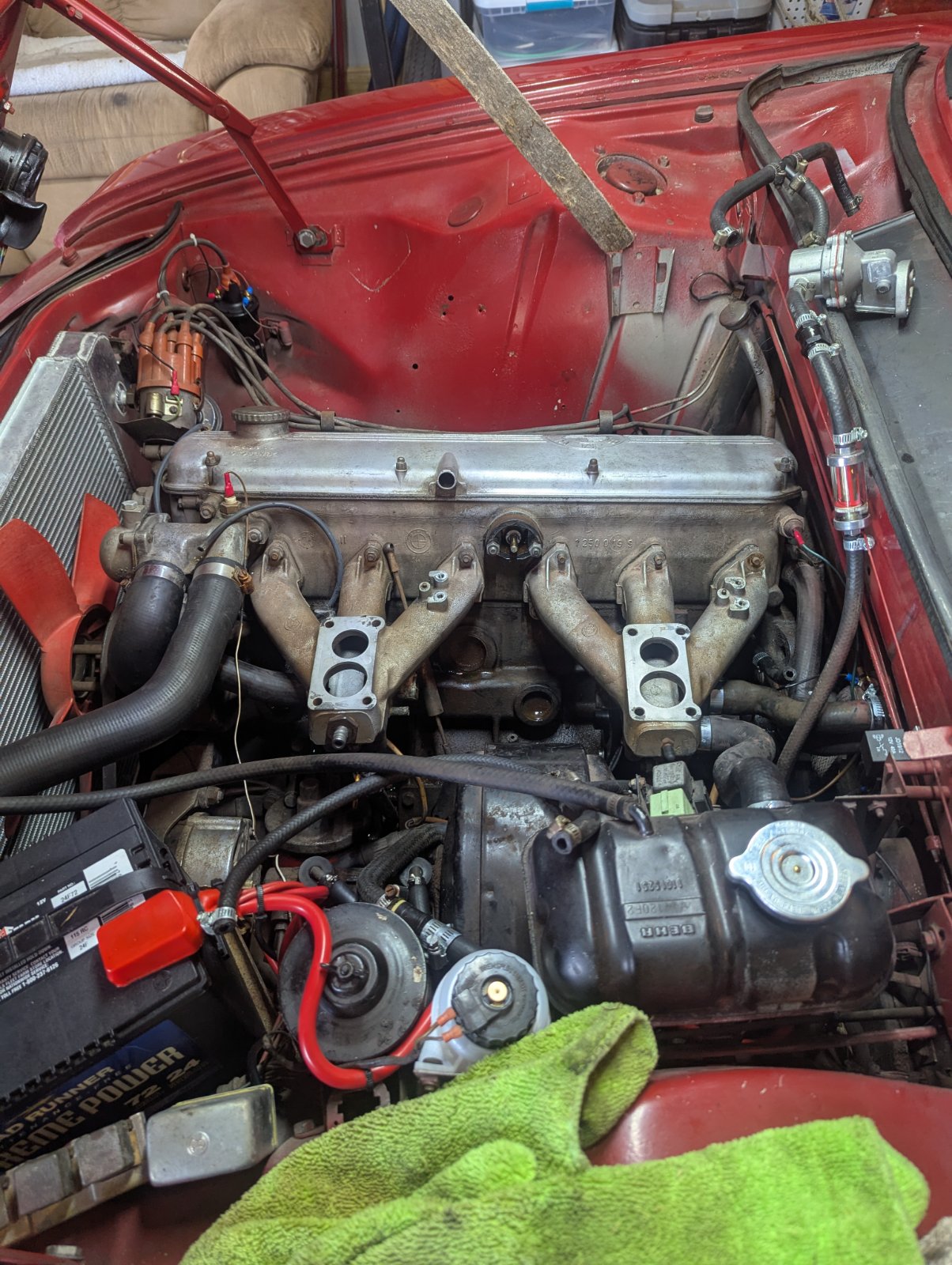

So, here she is!! I just got her running again after sleeping for the better part of 40 years. Very solid car... She was repainted to Red in 1983, but was originally silver.

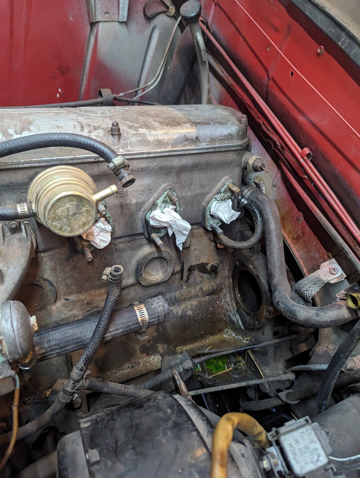

I've been going through everything; drained the fluids, and inspected the cylinder bores, added a starter relay, new starter, rewired a bunch of stuff, added grounds, new brake calipers, and new wheels and tires.... It's been a hell of a busy past 3 weeks, but she is back on the road!

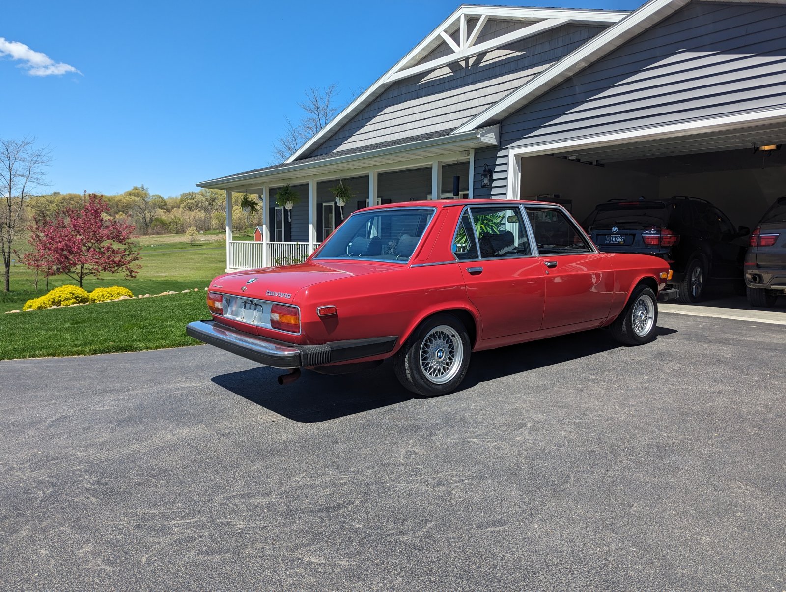

She made it to her first car show this last weekend for our BMWCCA Badger Bimmers Chapter spring picnic.

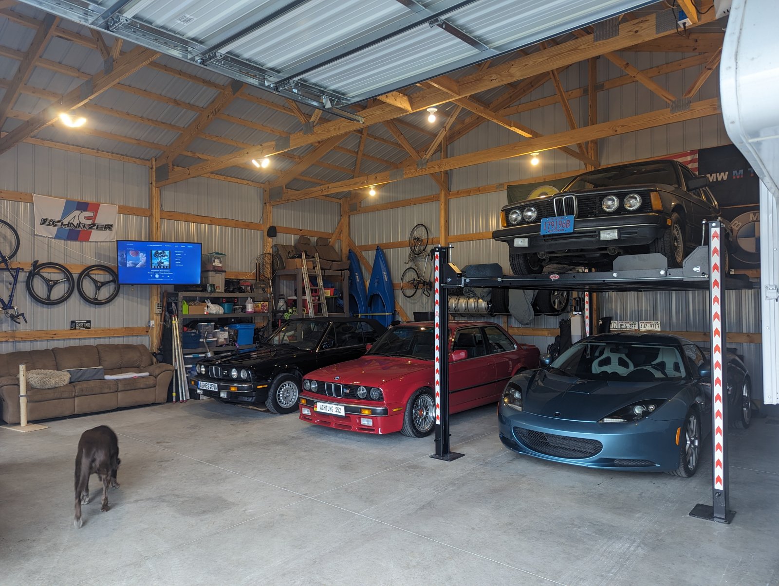

She's right at home with our E21, and 2 E30'S. The poor Lotus is lost surrounded by old BMWs! Lol.

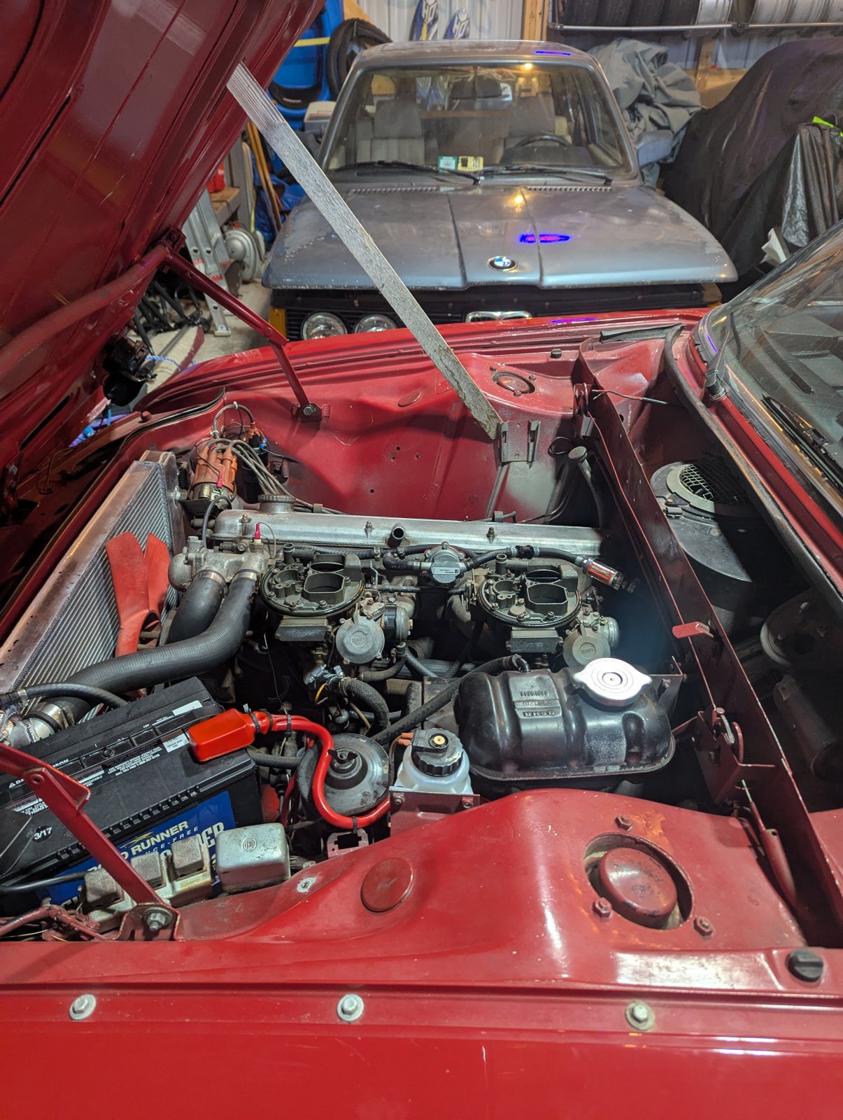

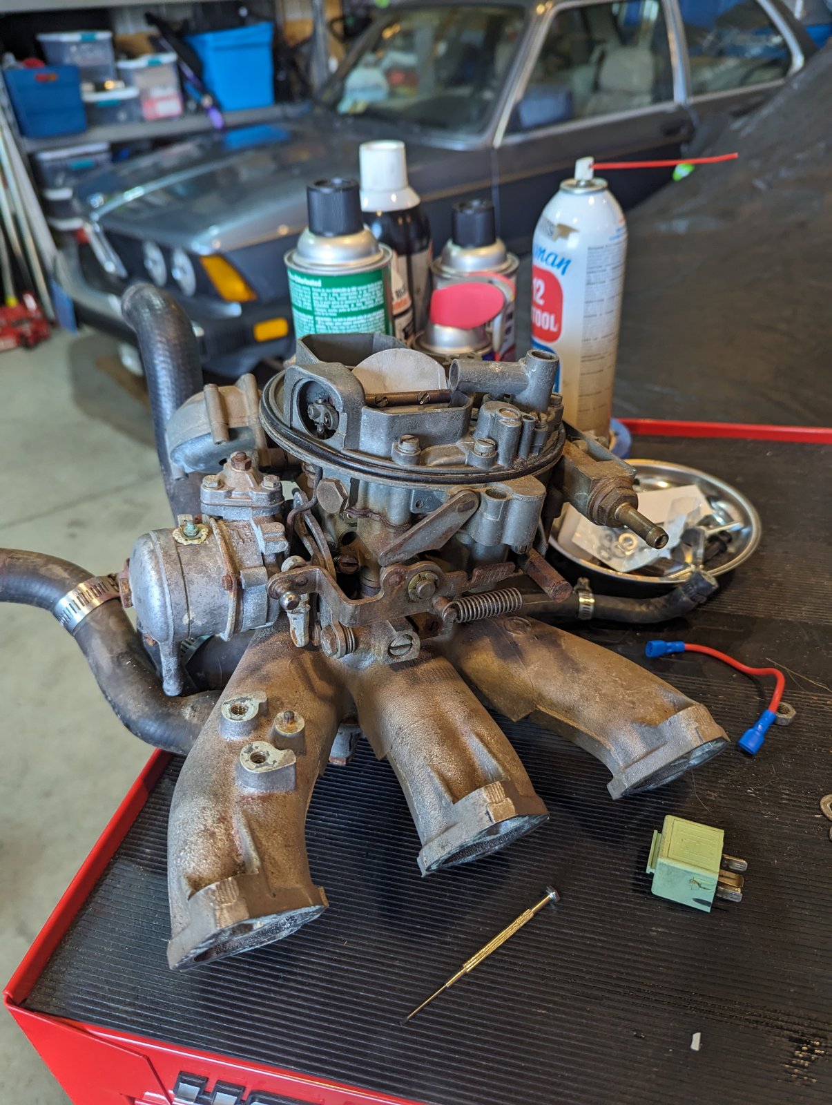

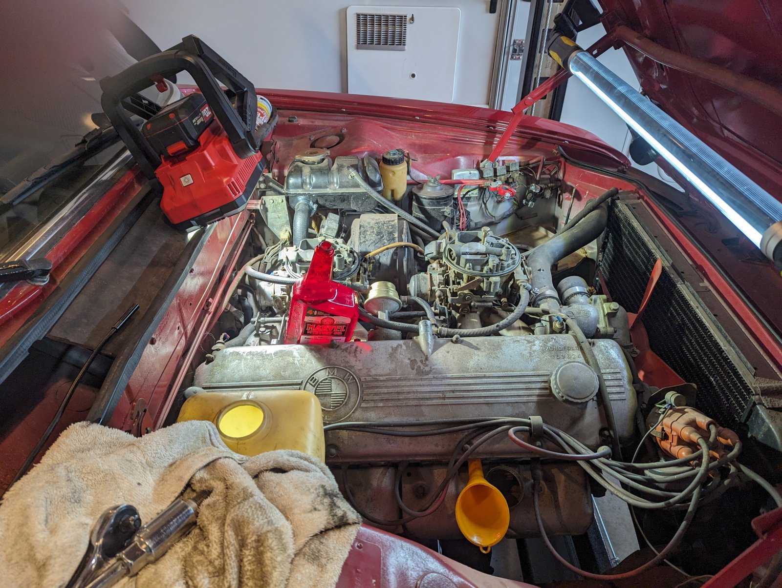

Lots of work was done over the summer including new brake calipers, wheel bearings, aluminum radiator, wheels/tires... driving good(ish), but starts hard and does not like much throttle without backfiring horrendously . The Zenith carbs are tired and beyond my expertise to repair.
Bavaria is under the knife again, this time tiding up some wiring, oil/transmission leaks (gaskets), and installing the Redline Weber carb kit.

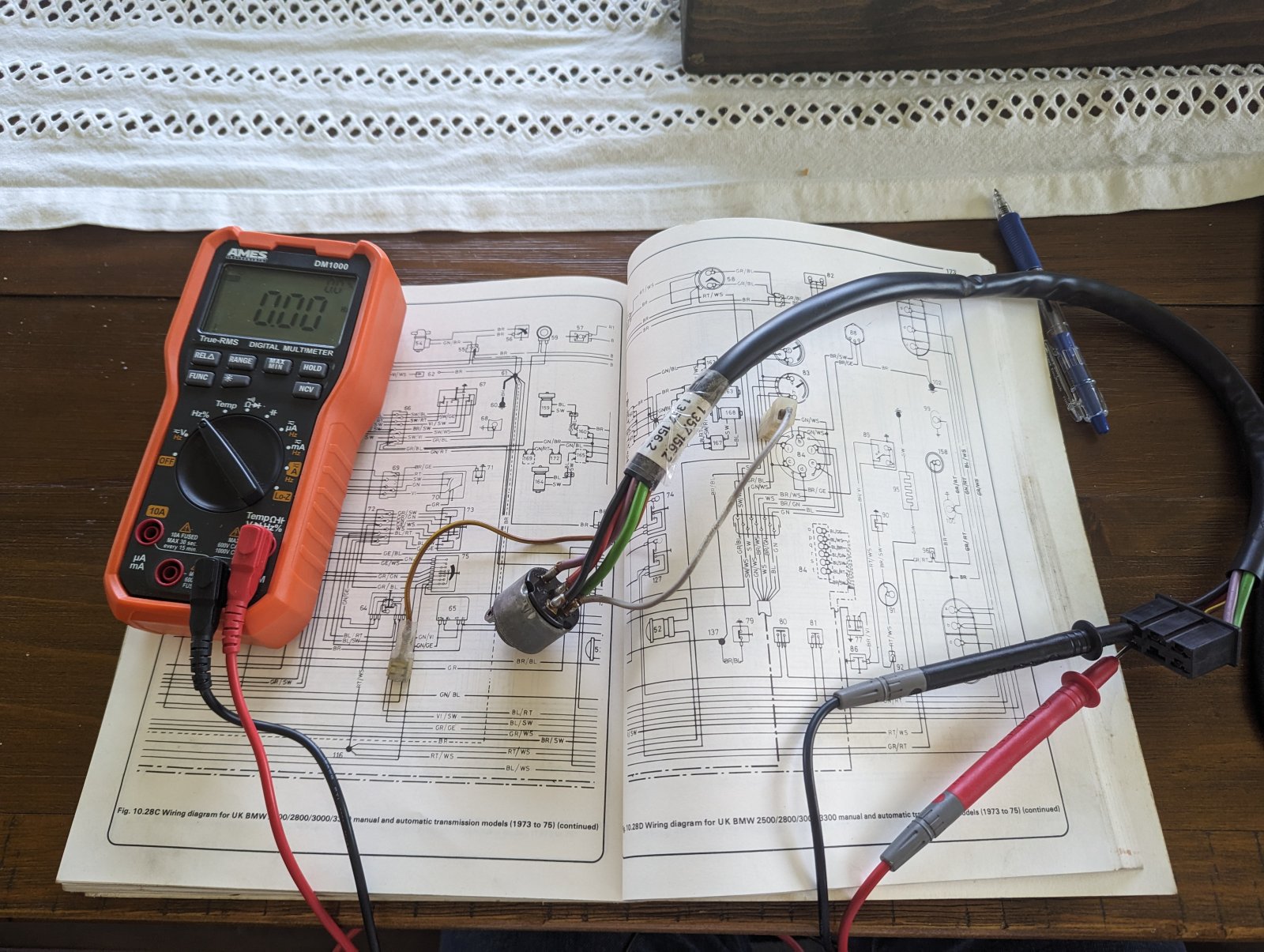

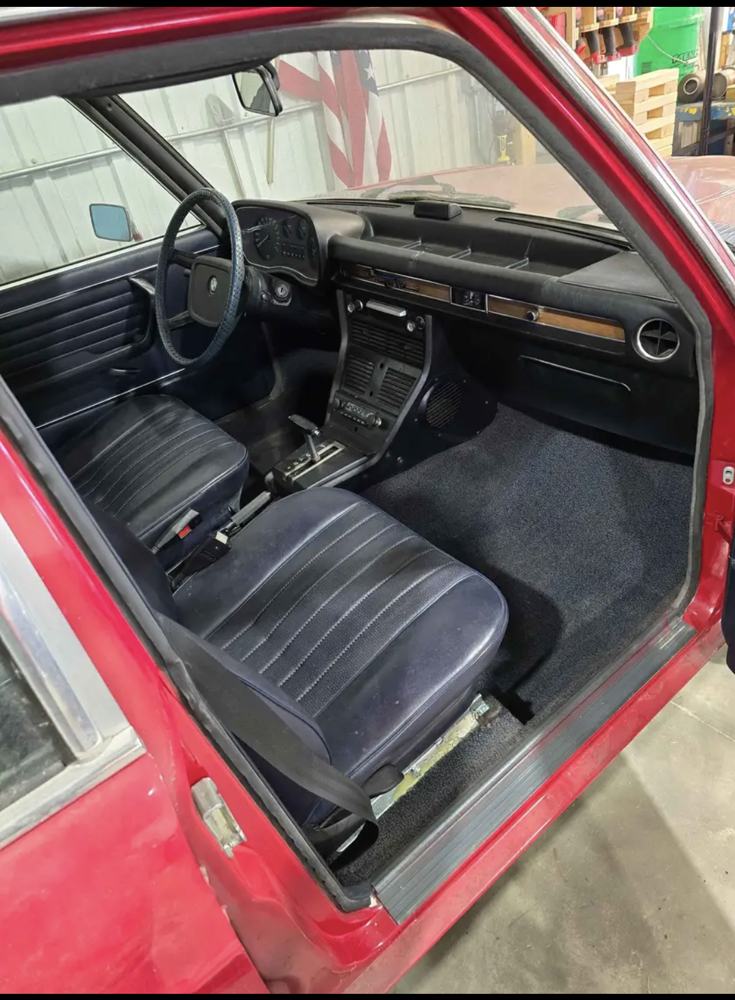

Good news is the heater blower functions great on the bench after a good cleaning and lubrication! Unfortunately, it is not getting power from the fuse box. No power at fuse #4 (and a few others) so I'll start tracing back to see if there is a relay (unloader relay?) that is unhappy. No AC on this car, and I don't know if it ever had it, but there is no evidence other than a couple holes in the center stack for knobs.

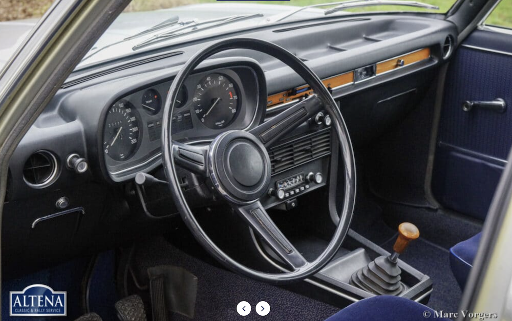

Your car most likely had AC. The center stack in a "no AC" E3 looked like this...
The two holes in your center stack were for the AC temp and blower speed switches.
Nice, thanks for the info! In that case, my AC is gutted, and long gone....lol
From what I've been reading, the '74 cars didn't use a changeover relay for the heat/AC blowers... I'll have to dig into th old AC wiring to see if that's where my problem is.... Then there's that mystery switch by the fuse box.

Whoopsies.... The Zenith carbs fell off! Mr FedEx is delivering something special this week I've been waiting for since December from Ireland Engineering. Weber carbs coming soon! She will be running like a top again
