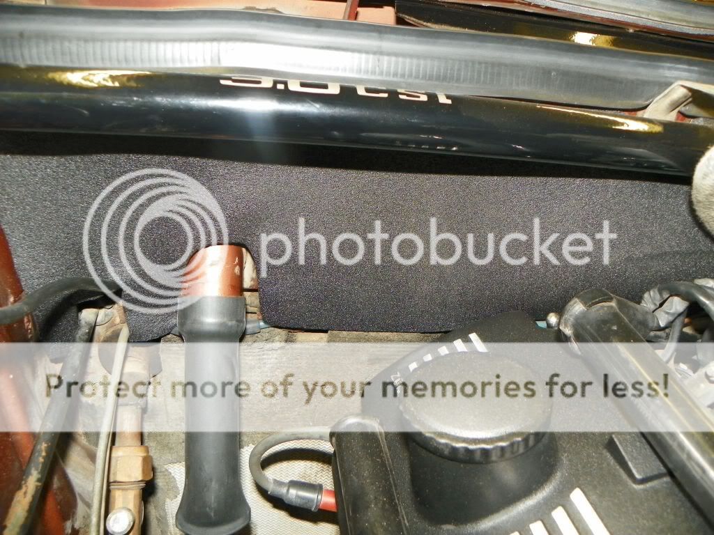

I used DynaMat /DynaLiner material for the fire wall as well as the bonnet. Used this product extensively in the interior as well...inside the doors, roof, pretty much everywhere. Good stuff and it made a huge difference to quiet the car. Light spray of Honda gray bumper paint to "disappear" the logo on the material (as suggested by a member here on the forum) in the engine bay. Made my templates with cardboard, light spray of 3M super 77 and then covered the cardboard with sheet plastic to make the templates durable and precise.
Insulation
I only did the top portion of the fire wall, what was deteriorated. The lower would have been tough if not impossible with the engine in place.

The upper isolation is still available at BMW. Well, cost some local-dollars, but the final result "in the engine bay" is stunning!
I spend a lot of my time in the engine bay!! More than the golf course!!!
