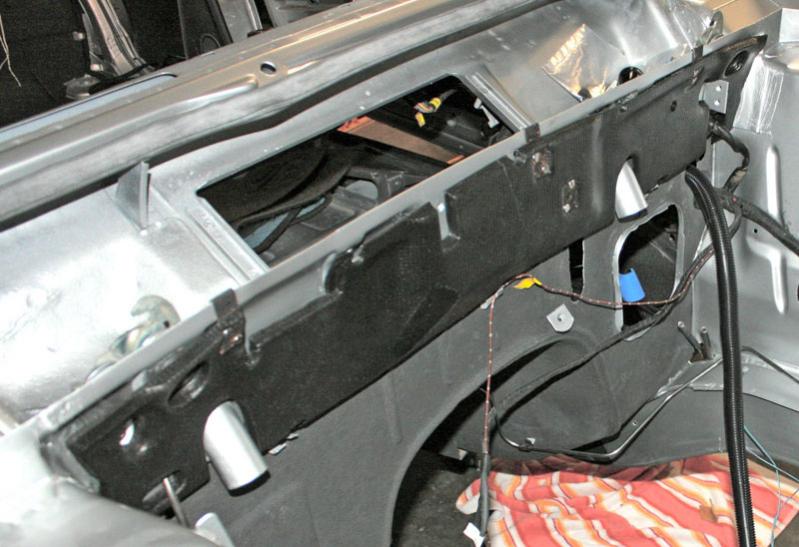

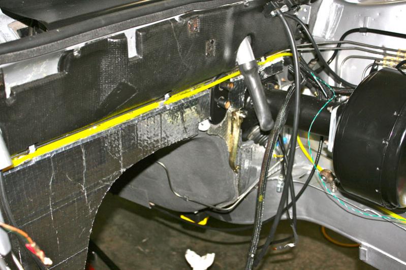

The upper formed foam piece is still available from BMW, although a bit pricey. I think it would be hard to do this out of sheet material and have it look good. This piece is readily visible from the top and there are lots of cutouts and contours to deal with. I used this BMW piece and then cut up a heat/sound insulation sheet piece for the lower sections of the firewall. West Marine has rolls of this roughly 1/2" thick material with self adhesive backing. It's heavy and also pricey (designed for engine compartments).
