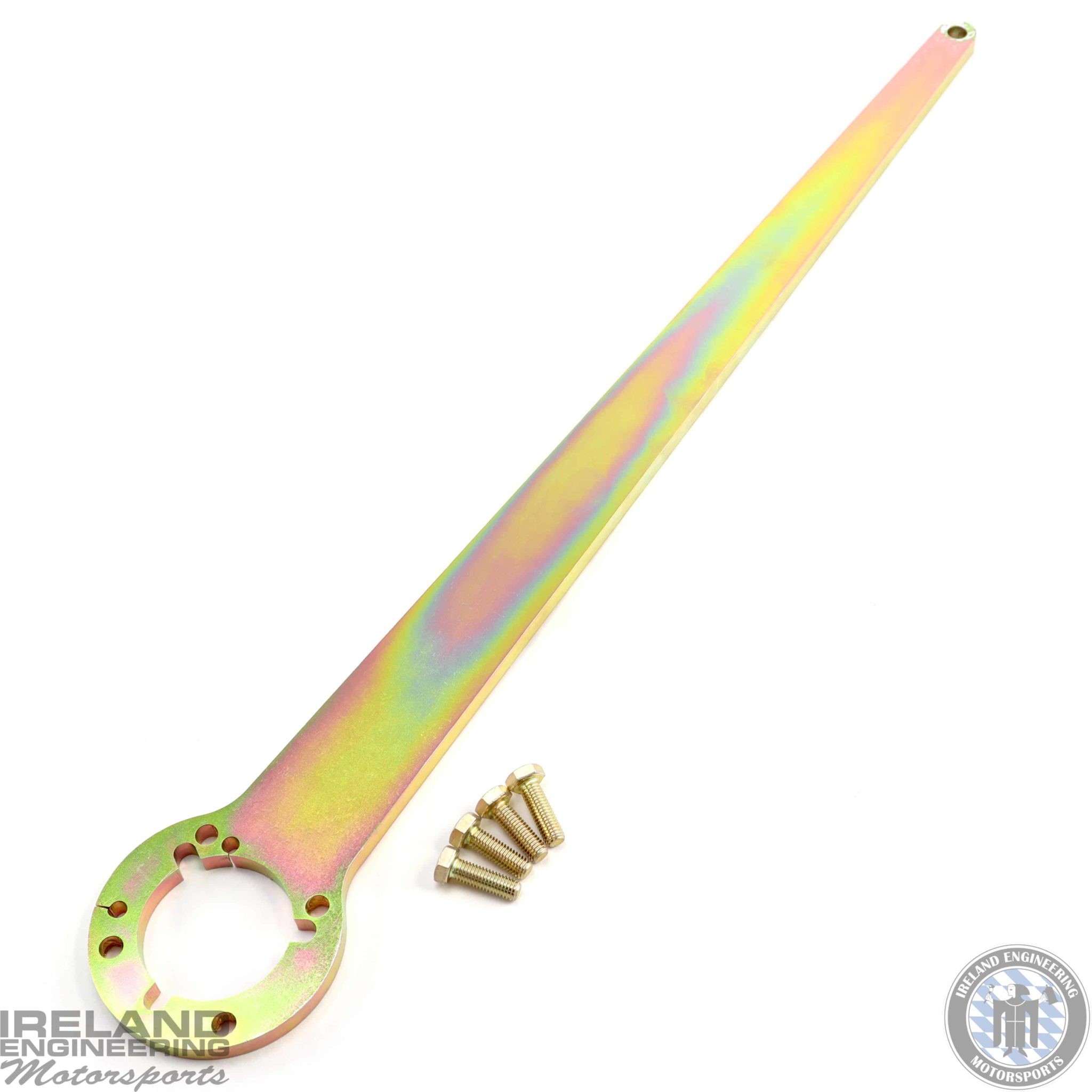

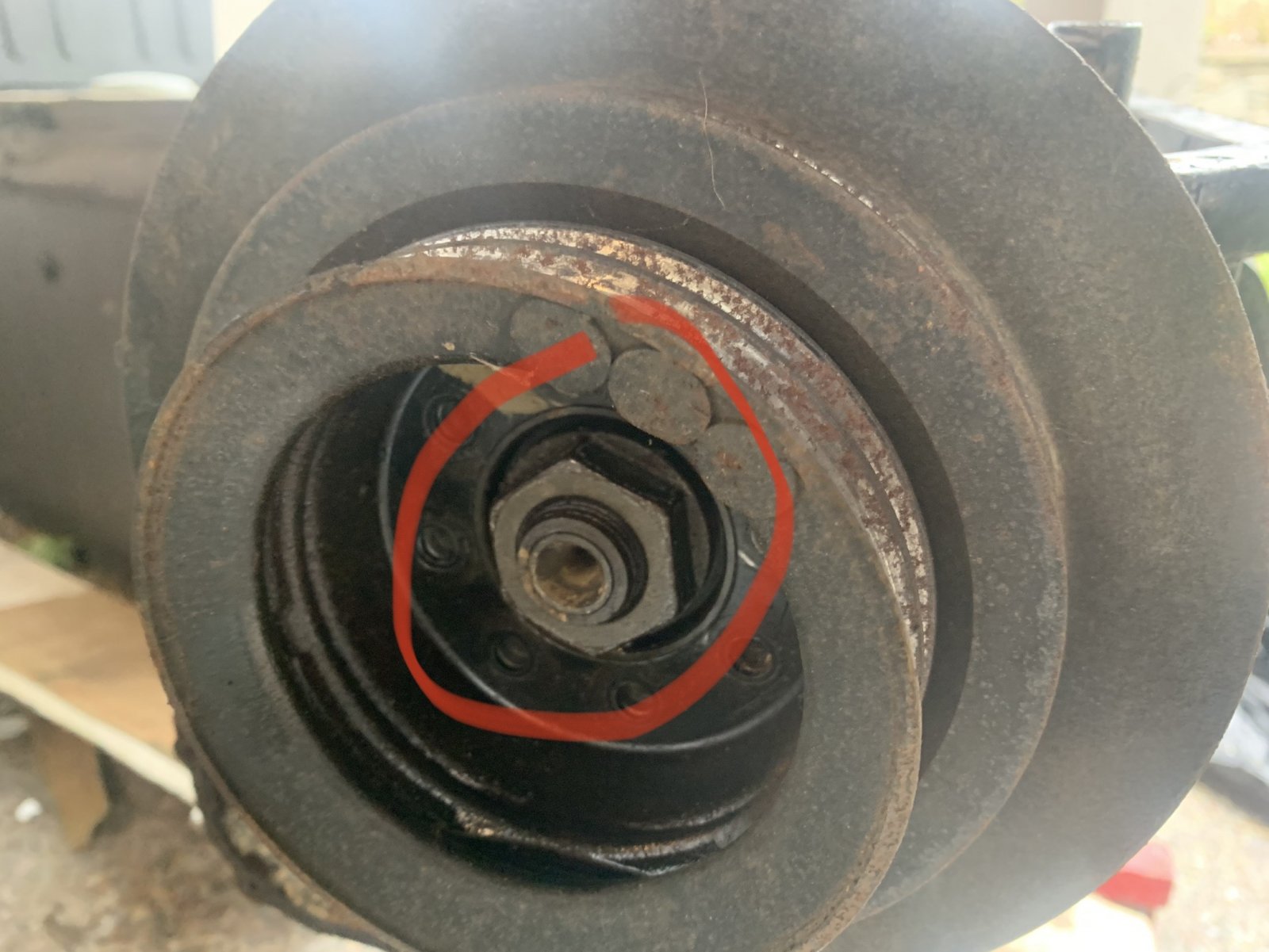

2: what size is the big nut that holds the pulleys on the right front side. It looks like a 36 maybe? It looks like I have to remove it in order to remove the crankshaft, right?

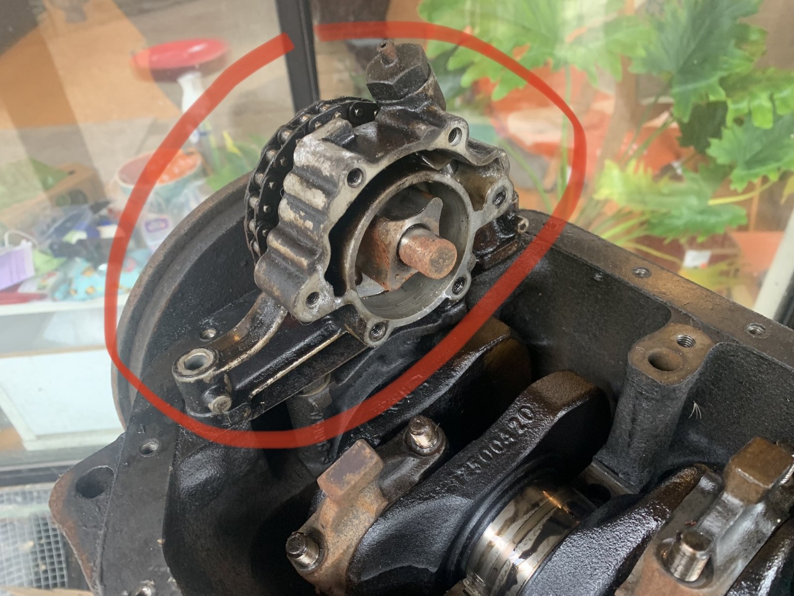

3: how do you remove the oil pump and chain assembly? After removing the two M8 bolts that secure it to the block, the chain still has enough tension that I can't lift it out. And that keeps me from accessing the last of the crankshaft journal caps

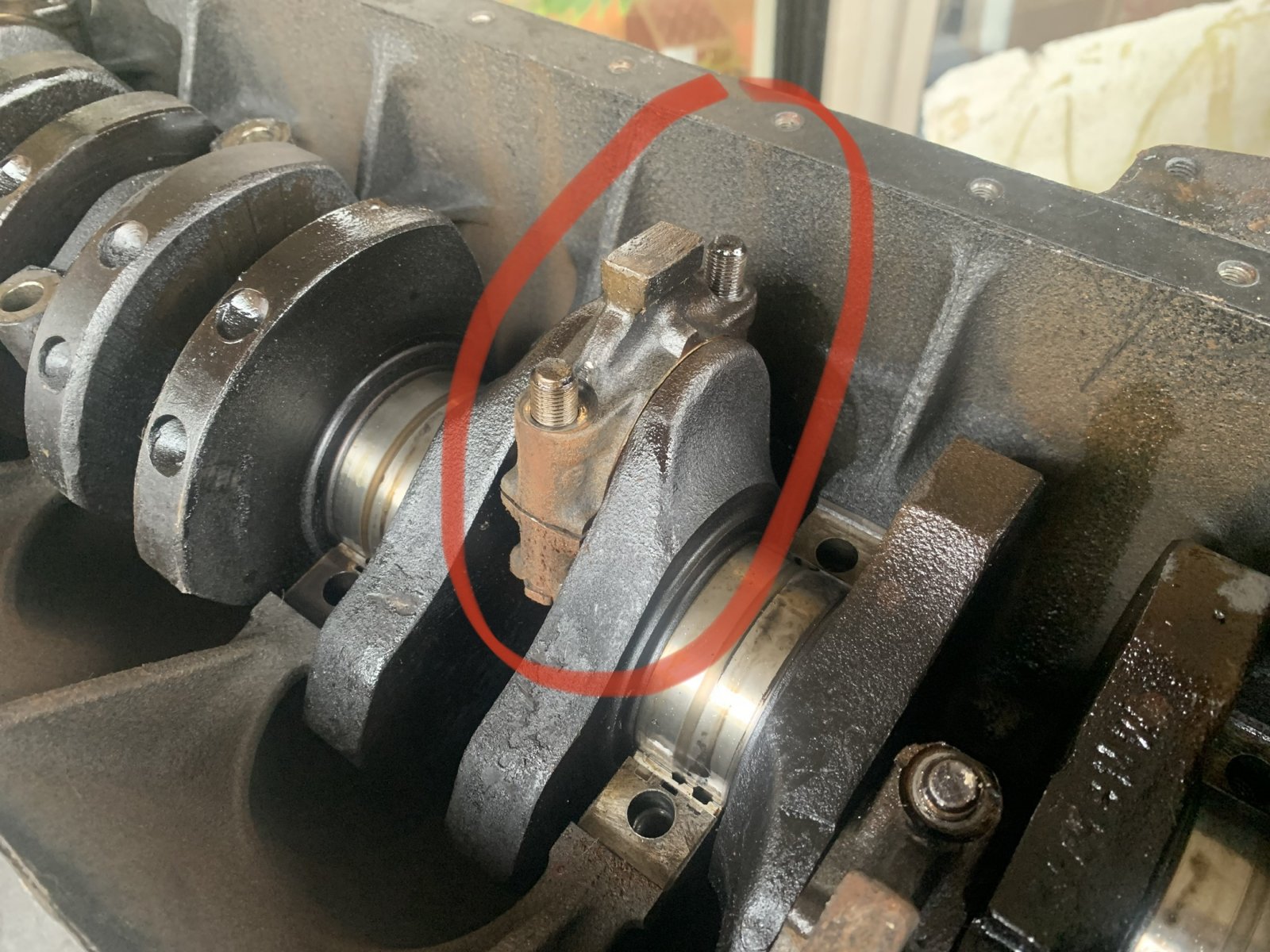

4: is there a trick to removing the con rod bearing caps? They barely move if I tap them with a hammer lightly. But I can't pull them out by hand. Vice grips maybe?

Remove sprocket from oil pump. Damper is something like 300 ft/lbs, why remove it? If you do remove 8 bolts holding the pulley, lock the flywheel and use an impact gun. Don’t keep chains and stuff.
Chris is clear- the pump is held down by the tension on the chain.
you either have three bolts that you need to remove or one nut that you need to remove, do so, and the sprocket and the chain will come off the shaft of the body of the pump. Once you do that the pump is free to remove.
After removing the nuts on the rod bolts and using a brass punch only and a small hammer, you tap the bolt until it loosens the bolt and slightly moves the piston. At that point the cap will be loose to remove.
Whats holding you up is the close register of the bolt.
Ok. I think I got everything out except that 36mm for the pulleys.
But if I need a "crank holding tool" it might be time to bring it to someone who already has both of these tools. Not worth buying just for a one time use
