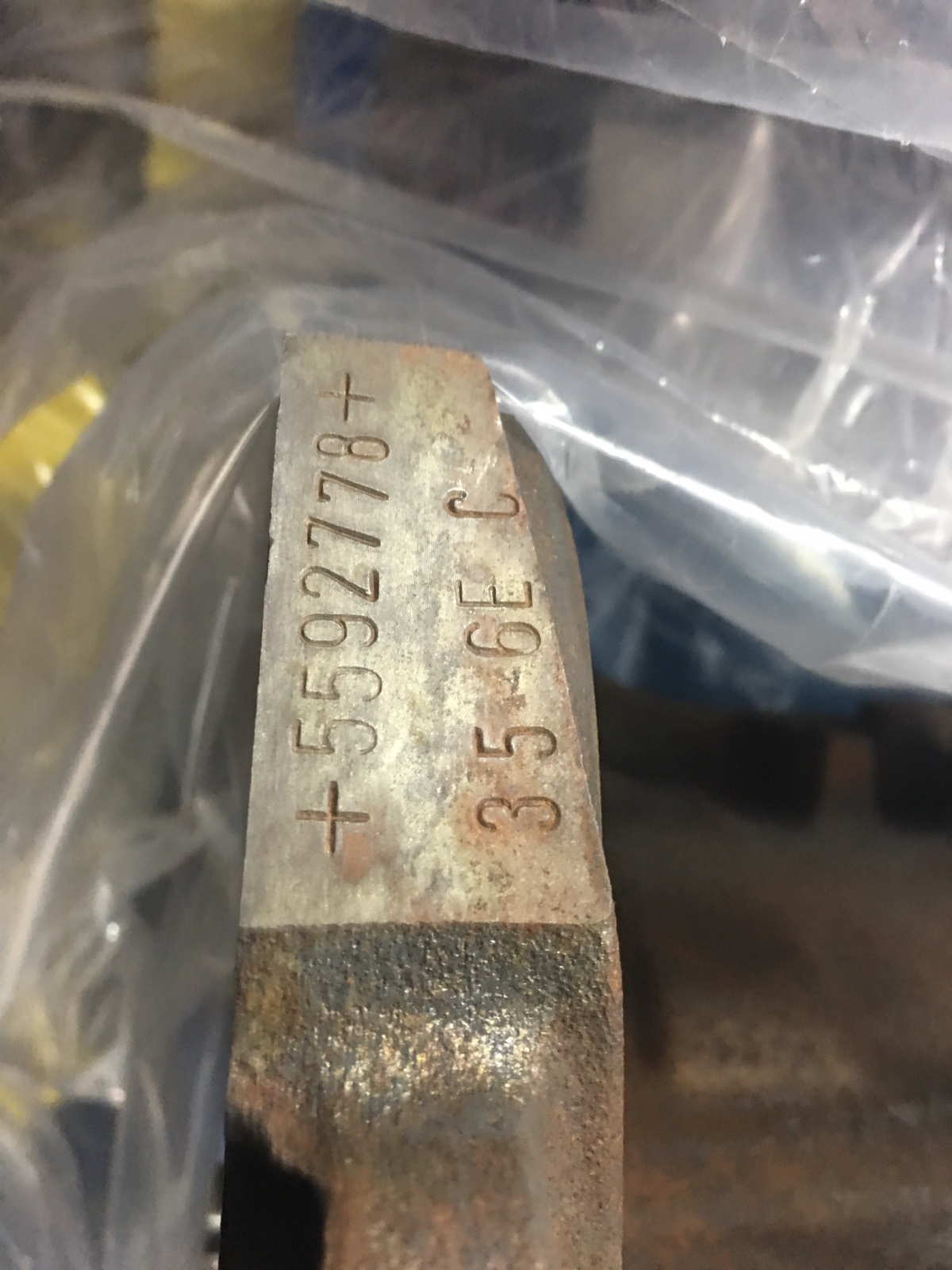

I have also seen a block that had a 3.2 casting on the block, and dated 9M76 (12/09/1976), with the original 1971 VIN number, but instead of + on either side, it had X on each side. I was told it was a BMW supplied replacement block.
True or not?

very curious if it has a + or an x on the block. sounds plausible as i remember replacement engines did use an 'x' ... just never saw one to know exactly where they used it.
I am searching for pictures, no luck yet. But they were exactly where the + s were.

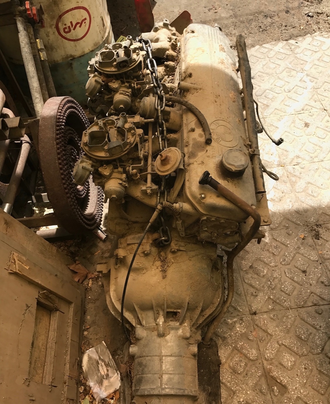

Correct combo for a 1979 block. 2 thumbs up nedrepsa!

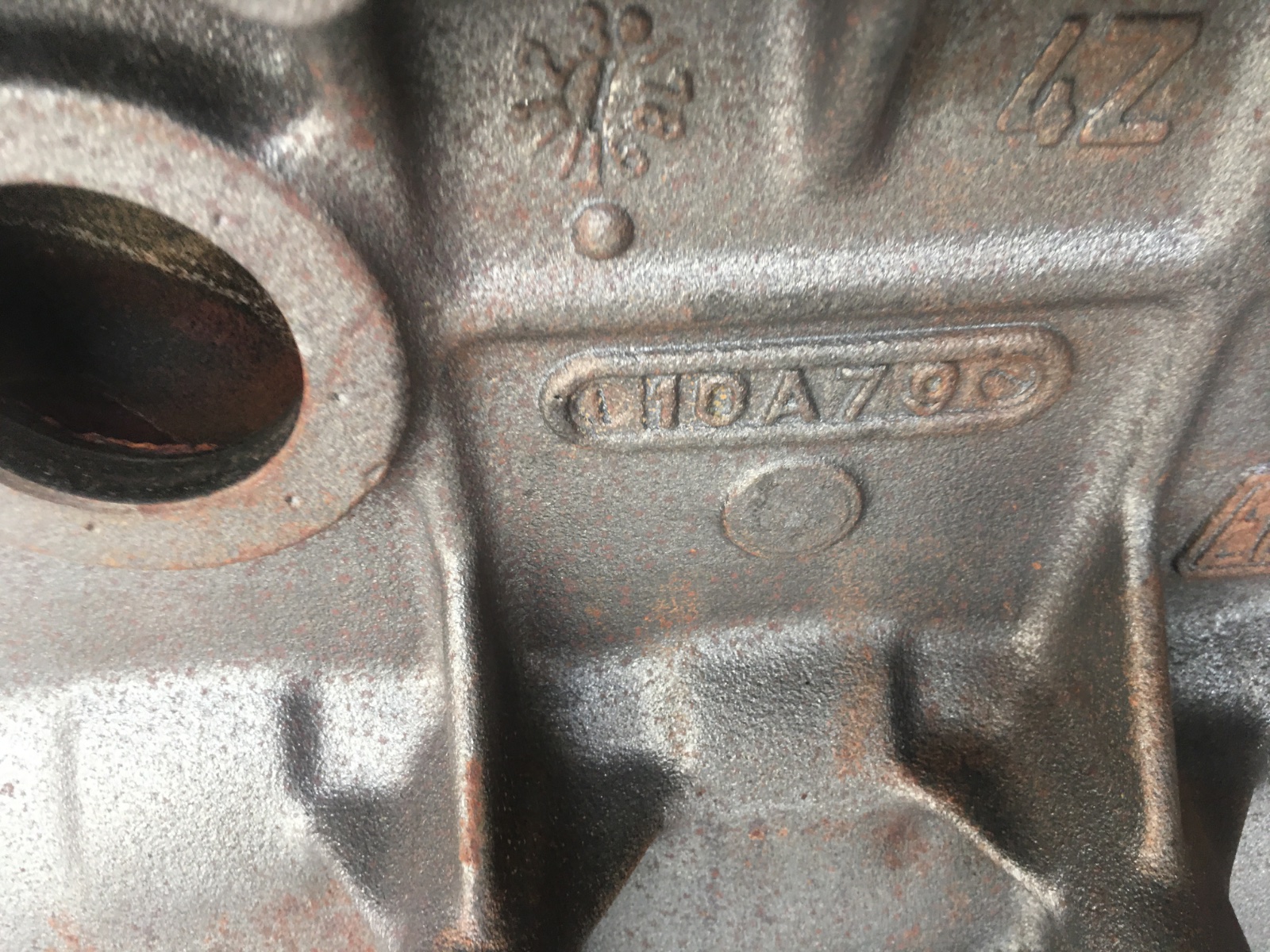

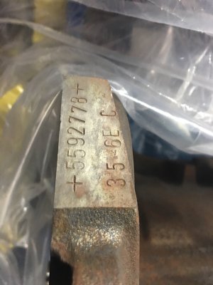

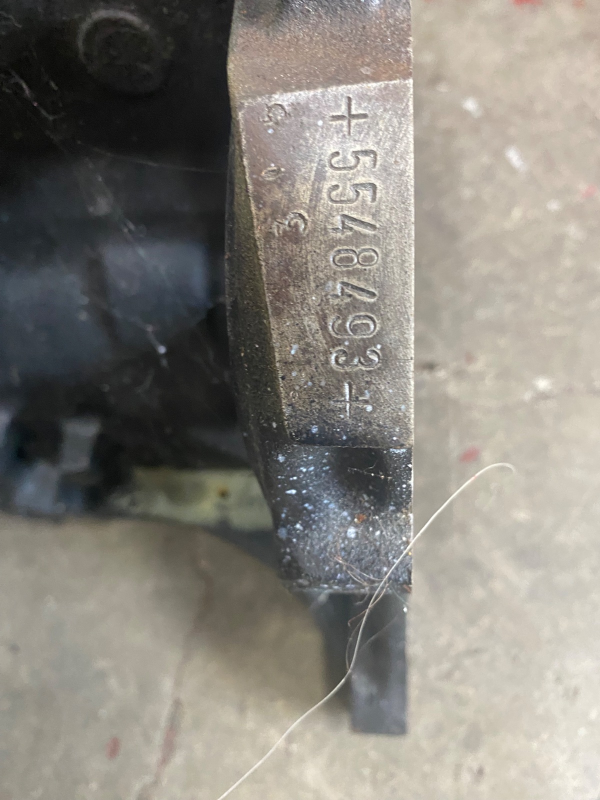

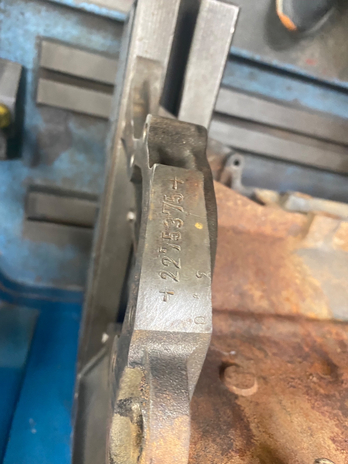

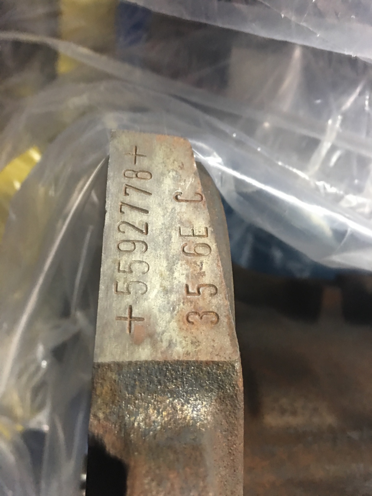

Note it is very difficult to fake a VIN
The grinding process for the flat boss is unique and very hard to duplicate.

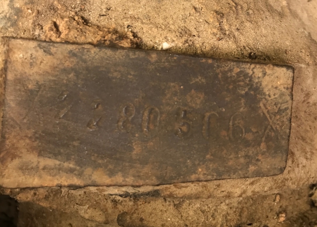

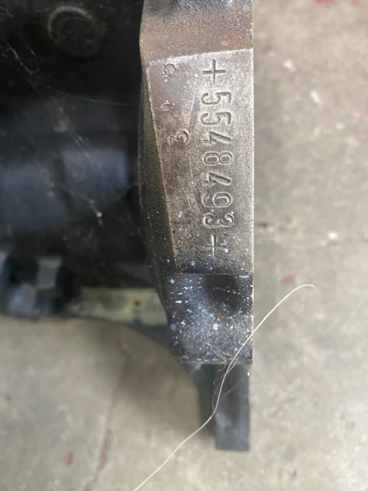

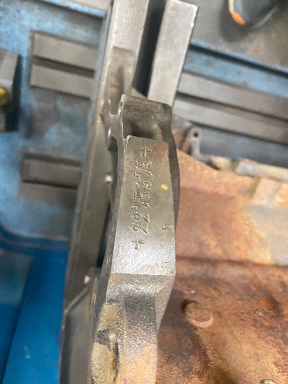

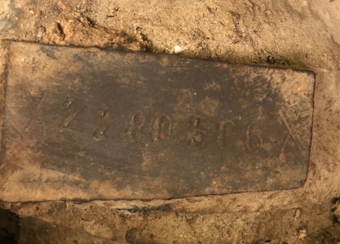

I cannot see a + or x but that is probably a fault of these 78 year old eyes.
but the stamping 3271264 is certainly not an amateur reproduction.
