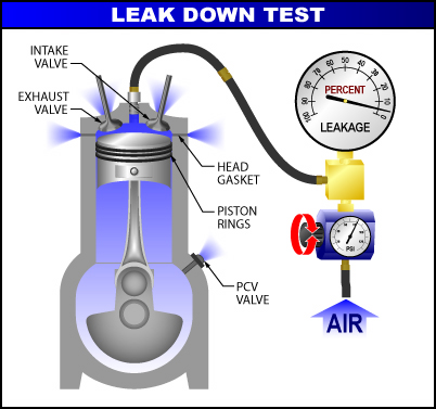

hi, some questions to try to help you:
1- can you please explain what is the "leak down test" in detail ?

I did the leak down test by applying pressued air throught he spark plug port while all valves are closed.
When I did the test I did it with the valve cover off to make sure I was TDC on each cylinder. I listened for air leakage at the valves and there was none that I could detect, but tons comming from the dip stick port.

From http://www.wcengineering.com/articles/leakdown.html
If air is leaking past the rings, or the valves, or the head gasket, we can directly read the amount of leakage and can easily find the leak. If there is air blowing out the PCV, we have a ring leak, if it's coming out of the exhaust, we have an exhaust valve leak, and so on...
A leak down test is especially good at discovering leaky valves. We use much less pressure (about 80 psi) than is normally in the combustion chamber (several hundred psi). If there is a valve that is slightly off its seat, the actual combustion pressure may have helped close it, but the lower testing pressure won't exert as much force and the leak will be apparent.
This test is very time-consuming with the engine in the car. To do the test, each cylinder must be tested one at a time, they must be at TDC compression, and the crank must be held in place to prevent rotation. A freshly rebuilt engine should have less that 4% leak down on each cylinder and if leak down is above 10%, service should be performed. All cylinders should be within 2 percentage points of each other. NOTE: These figures are for performance engines. Stock production engines may have as much as 10% right off the assembly line.
Benefits:
Direct reading of each cylinder's condition
Pin points any problem areas
Drawbacks: Difficult to perform
Time consuming
Requires source of steady air pressure

The leak down test gave me 90 to 100% leakage across all cylinders. Judging by the sound I think the leakage I heard through the dip stick overwhelmed any potential leakage there might be throught the valve guides.
