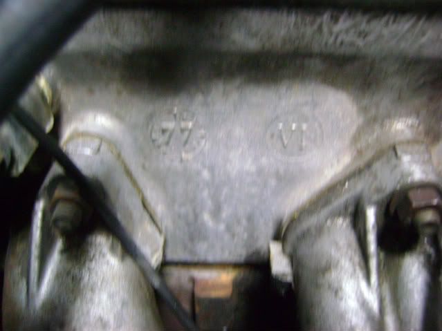

while i was out there i noticed that there was a 77 stamped on the engine block.
should have been 69 ... unless
but that got me curious now...
there is 77 stamped by the first and second intake runner along with VI
then by the third runner is a number 125 C (or G) 01 9 9
anyone with a clue?

Heads- near number one and two a circle with a two digit year.

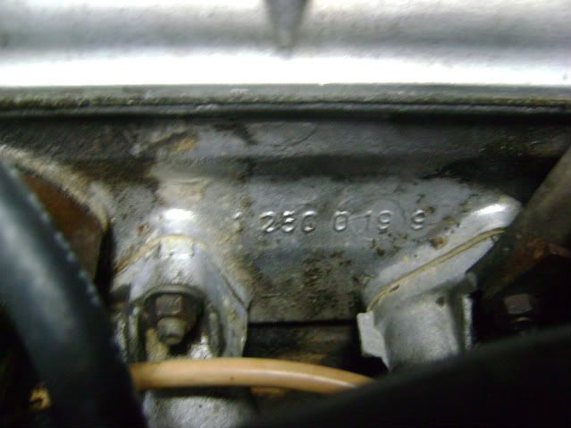

here are the only numbers that were prominent to me
this is in the front by the water inlet
and the other by the fuel pump to the right
the numbers look like 125 c or g 0199
Casting Marks
That's a 77 head. The other numbers don't matter. Make sure your cooling system is up to speed. 81 or newer has larger passages.

so it's the same 2800 engine block with different heads on it for some reason...
would it even matter ? are there any valve changes between 69 and 77?

You should be able to check the number on realoem or similar. If you want to get technical, look on the right side for the casting numbers. 3 of them.
The early heads were known to be problems. A 77 head isn't any different from a 69; maybe better as the cam is newer/ advanced.
Most everyone has a different head by now; don't loose any sleep over it.:)
i was actually getting excited over the possibility of having maybe 3.5l in there or so... but finding the vin# took care of that :)
if the number is upside down in respect to the vin, then i think i could make the numbers 426 out there
