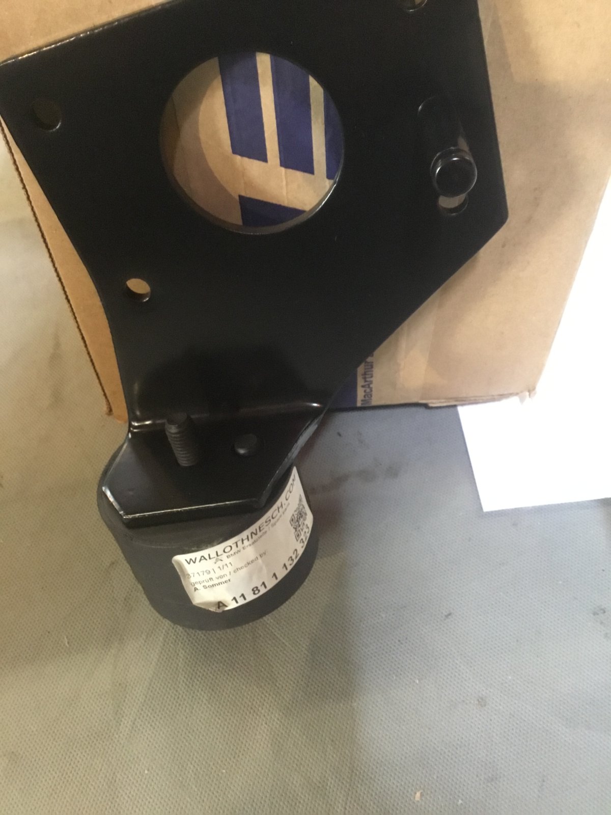

After a reasonable search for engine mounts, I seem to have discovered that the mounts available today have the little alignment nubs only on one side. Whereas, the old mounts I removed from my car have alignment nubs on both sides (and the subframe and engine bracket has holes for the same). Does it matter? If you use only the 1-nub version, is it better to nub up or nub down?
The shape is uniform so I dont believe there is an orientation. I just thought the nub helped hold it in place and stopped it from moving left/right/rotating. That's my intuitive sense.
The ”nubs” must go in the rear hole of the mount.
What this tells me is that:
1. It is okay for the mount to have only 1 nub.
2. Use the mount with the nub facing up.
3. Orient the nub in the rear engine bracket hole (thus positioning the engine more aft).
Thank you!
