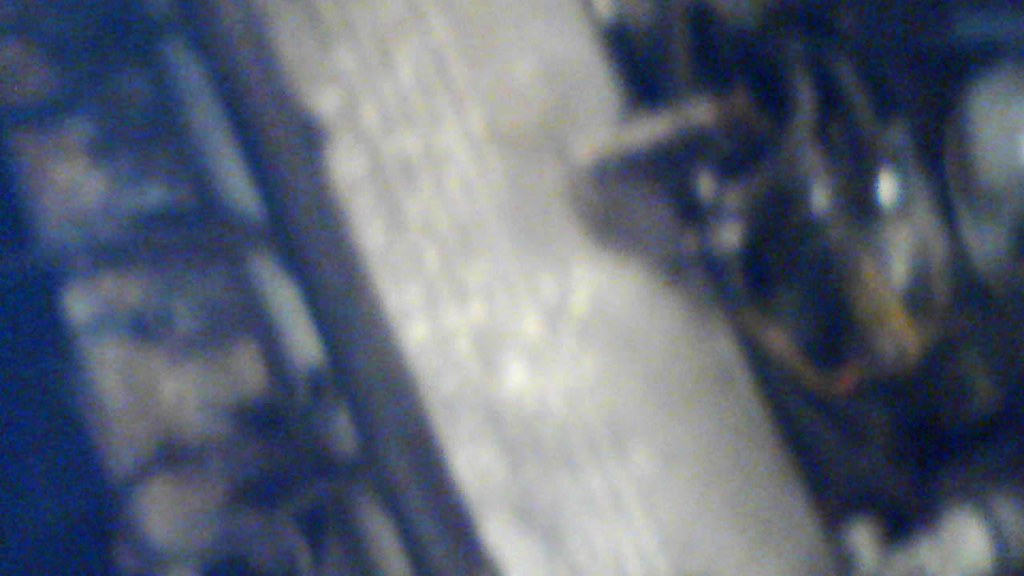

To be honest, I had the hardest time figuring out where the number was. Many people reference it, but I didn't realize that the number faces straight up. it is on the *horizontal flat part of the block, on the bell housing side of the starter. If the CSI motor is installed, you need to move some hoses around and peek down behind the last runner on the intake. I was also able to get a scotchbrite pad down in there to clean off the numbers.
It sounds like you have an M30B32 block. I had a great discussion with Don recently about the CSi piano top pistons. You can pick up an inspection cam for around $30. If you have a small one, you can sqeeze it through the spark plug hole and see the piston top. Mine barely fits, hence the fumbling in the first half of the vid of my 2800CS below. Once I do this on the CSI I can report back if you want to see what the piano tops look like from an inspection cam. You can clearly see that the pistons are flat in this video.

The 2800CS came with piano tops too, I see the edge of one in your video. Here is the crusty piston from our 2800 sedan.
