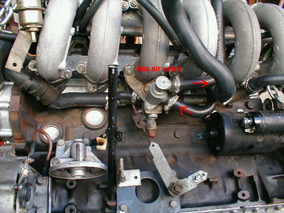

Hi I have a 72 csl with original d jet system that occasionally runs on when the ignition is killed.
It has had new injectors put in it and been dyno tuned. I was having trouble with the auxhilary air valve but now that seems to be fixed and the cooling system is all in order.
Any ideas or thoughts would be most appreciated.

What about the cold start injector at the top of the manifold? Could it be dribbling or leaking fuel? (The fact that your auxiliary air valve is not fully closing suggests you are possibly jury rigging something to obtain an acceptable idle. ??The ecu potentiometer setting? The co adjustment at the throttle body? Timing??)

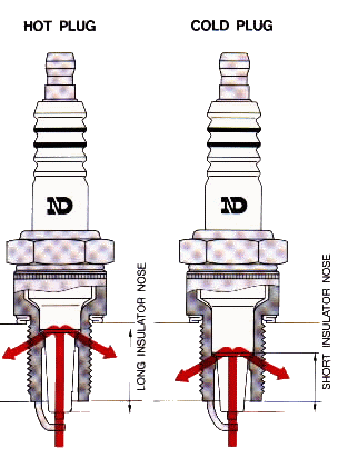

Spark plugs that are too hot for the application can become incandescent. Have you tried a colder range plug? What is the overall state of the combustion chambers? Carbon-laden combustion chambers have a tendency to become aglow and also foster run-on.
