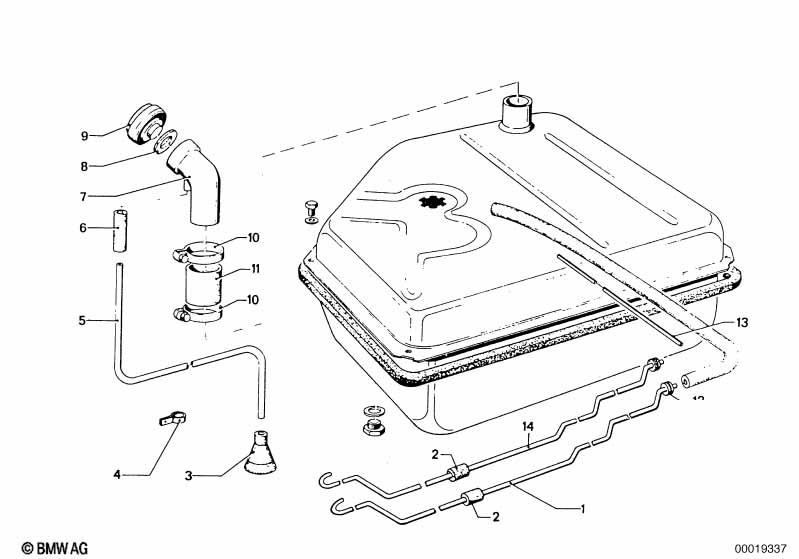

Also check the return line from the engine to the tank. Mine stalled but would restart for a while and then stall again. I had sealed the tank with POR 15 but not cleared the return inlet on the tank.
Would a carbed car have a return line? (Moderator: not until 74) Do you mean the tank vent line that goes through the charcoal filter under the battery then on to the air cleaner?

OK - MADE IT to Blowing Rock tonight with no stalls - I will check the return line - thanks (Mike) for the diagram - there is 1 electric pump mounted in the engine bay, on the left near the master cylinder/brake booster. It has been an electric pump since I've owned it (2006) - the mechanical pump had already been removed by the previous owner. The older pumps I mentioned were the ones I've replaced. So, only one active pump.
