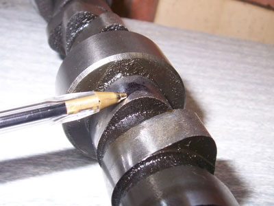

If the lobes are worn, you should be able to identify it fairly easily by examining it. Unless the distributor shaft is oscillating up and down (like a spindle sander) you would likely see grooves or worn areas in the distributor cam lobes made by the point's rubbing block. (Not unlike looking for obvious damage to the lobe on a camshaft where it contacts a valve or rocker -below)
