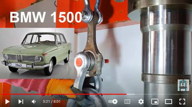

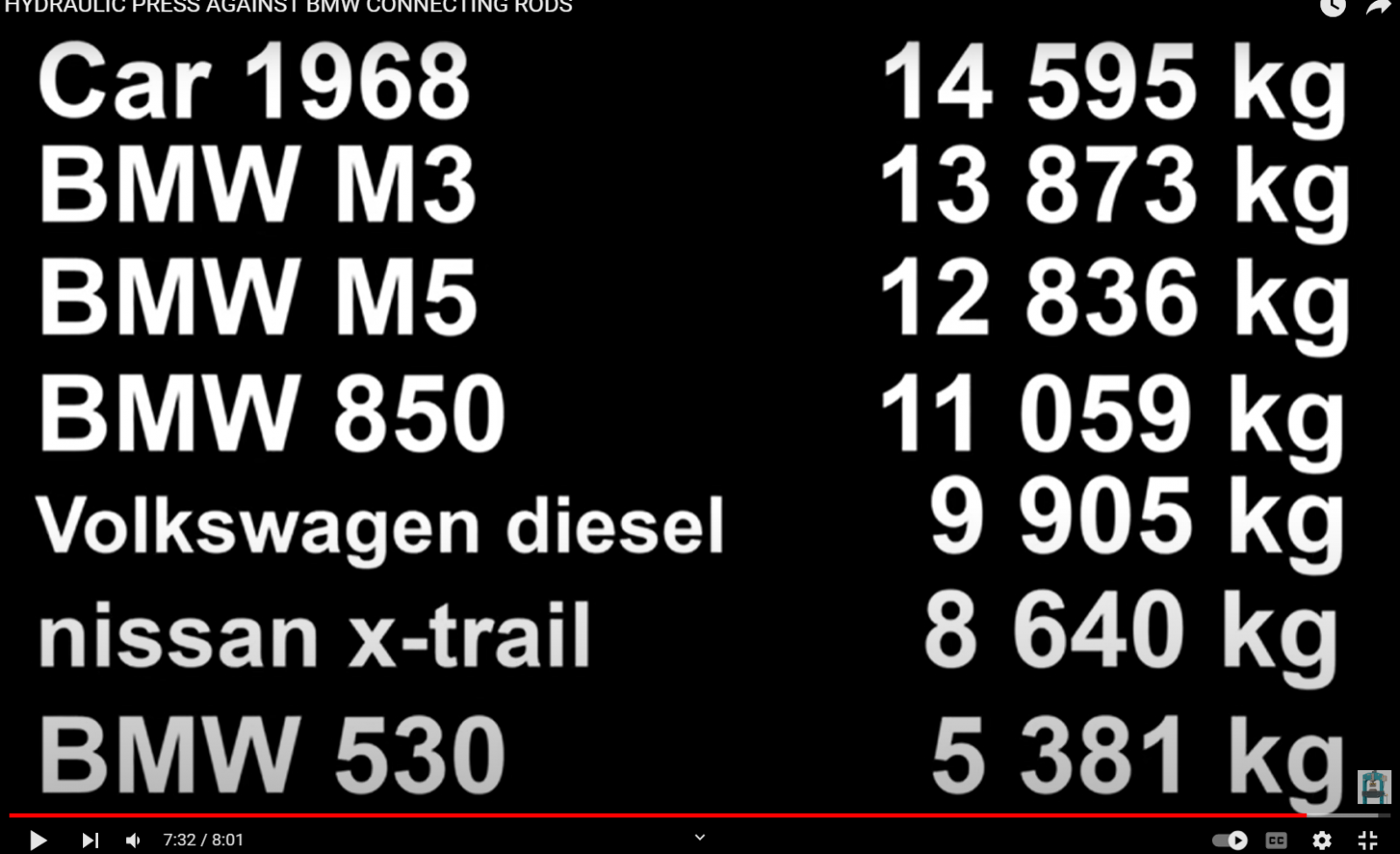

Youtube video claiming to test the connection rods of various bmw's and other cars under tension.
The 1969 BMW 1800 wins hands down, even when compared to a modern M5.
I know, i know. it's just overdesigned because they couldn't computer calculate it. A bit like the Roman bridges that still stand after 2000 years.
but you can still throw it into a conversation with your next generation that always talks about Ai being soo great....
Is tension critical with connecting rods? Definitely over designed as Eric mentions.
Engineering has improved with FEA to where it isn't required to over design.
I wouldn't equate over-engineering with "better" engineering. Sub-optimal is sub-optimal, whichever side of perfection you are on. In the case cited, excessively heavy connecting rods limit top RPM, put unnecessary loads on the crankshaft and (most importantly in the 21st Century) detract from fuel mileage.
I wouldn't "engineer" the entertainment value out of this video. I think it was just someone that happened to have access to several interesting connecting rods and some big equipment, so... let's test these to failure and see what we get. :D I don't think they were arguing that new connecting rods are bad or poorly engineered, and I don't think they were suggesting everything should be 1968 heavy. As the owner of a 1968 BMW, I can now have an interesting story at dinner with friends. "Did you know that my connecting rods are stronger that those in your M5?"

i tend to agree about engineering ... to me is it better manufacturing compared to less expensive manufacturing. certainly now there are various alloys used which are lighter, stronger or cheaper and some are easier to manufacture into certain components - so better is the operative word needing the correct word - is it better price, is it better lasting, is it better performance ... or what. in most automotive manufacturing, better price wins. in racing, its all about being light and strong.
I agree, it was likely suboptimal.
Your right about that point. The lighter a rotating mass can be without giving away the better.
