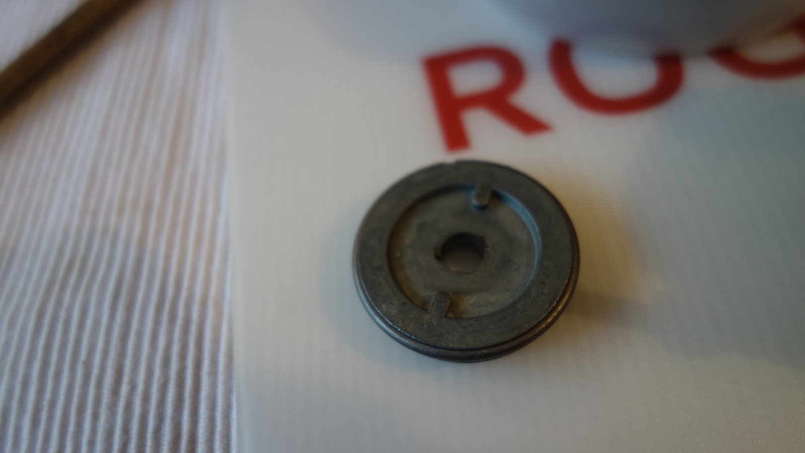

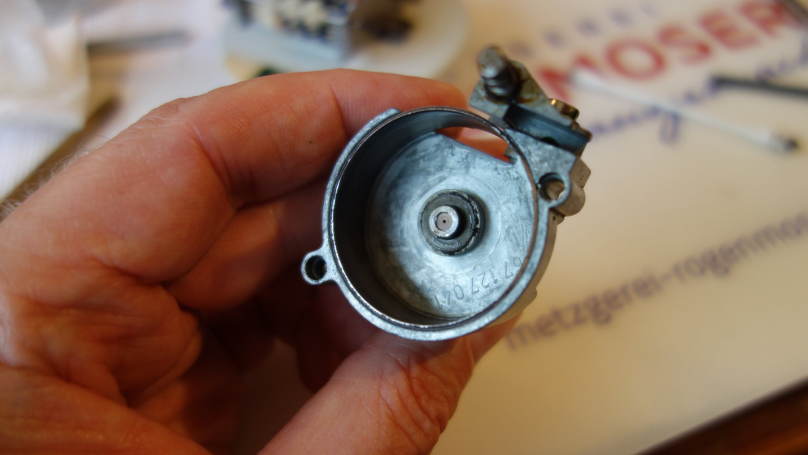

Common problem. There is a disk inside the speedo that is spun by the speedo cable.
The needle at the hub of the speedo gauge gets "excited" by magnetic eddy currents caused by the rotation of the spinning disk that deflect the needle. Slow rotation, little deflection, fast rotation big deflection. The needle hub of the speedo indicator seats in that tiny hole at the center. In order to work properly, the speedo needle hub sits centered, but not touching that hole, so don't bend it when seating the parts back together.

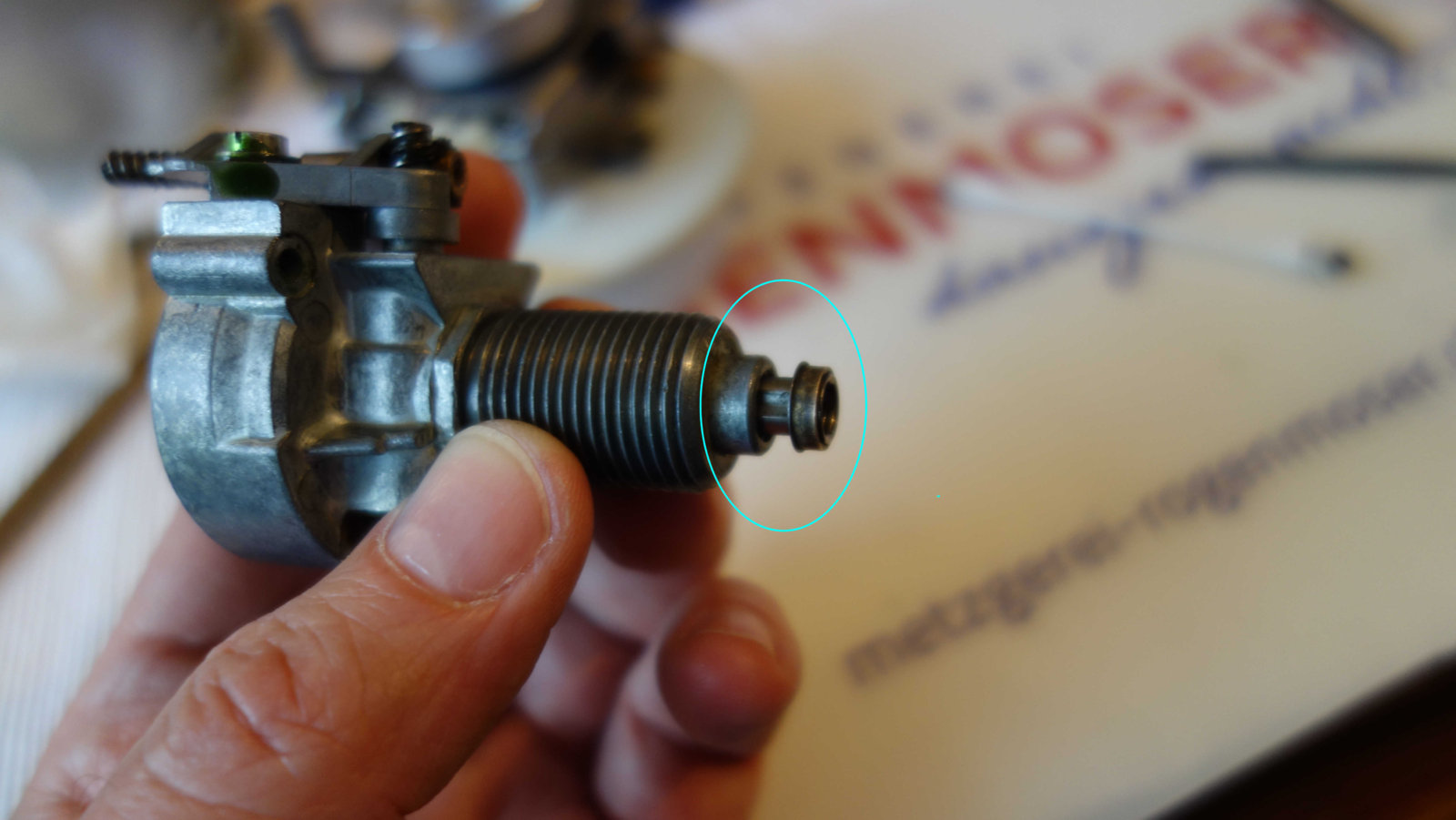

Most likely, the speedo cable has worked the hub for the disk out of the speedo slightly.

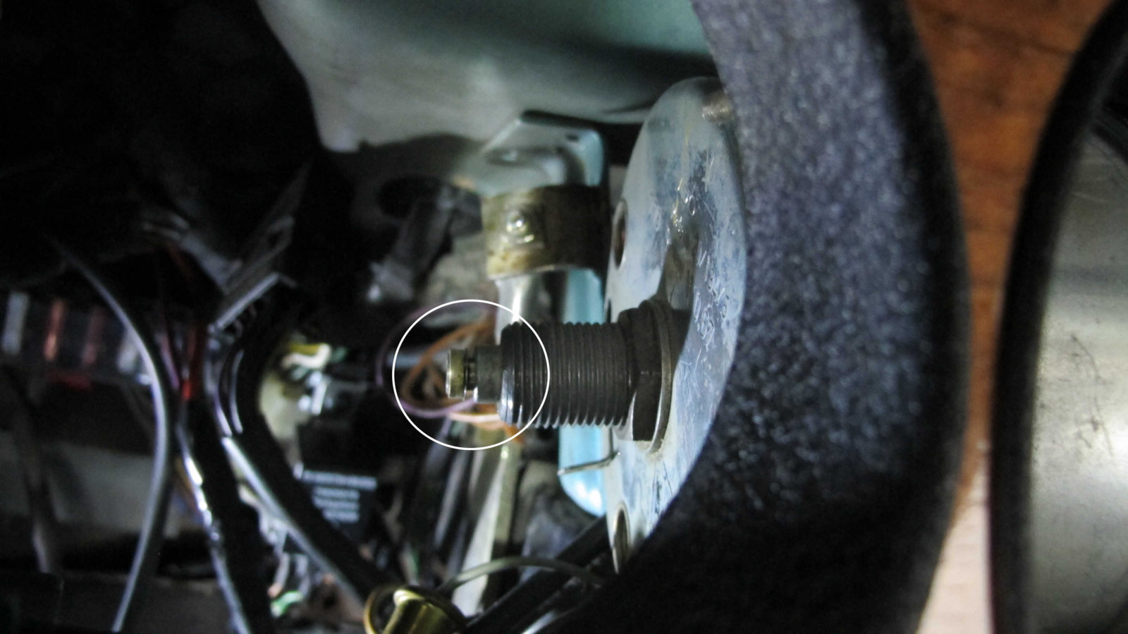

The quick repair may be to unscrew your speedo cable from the back of the speedo and push the hub back in. This may fix your problem. You can do this by simply pulling your speedo cable, without dismounting it. Just give the hub a push with the end of a screwdriver. If you're a contortionist, or a good hand with a phone camera, you can actually verify this problem in place:
It may be that the disk has worked off of the hub by that amount, so opening the speedo to push the disk back onto the hub may be necessary.
