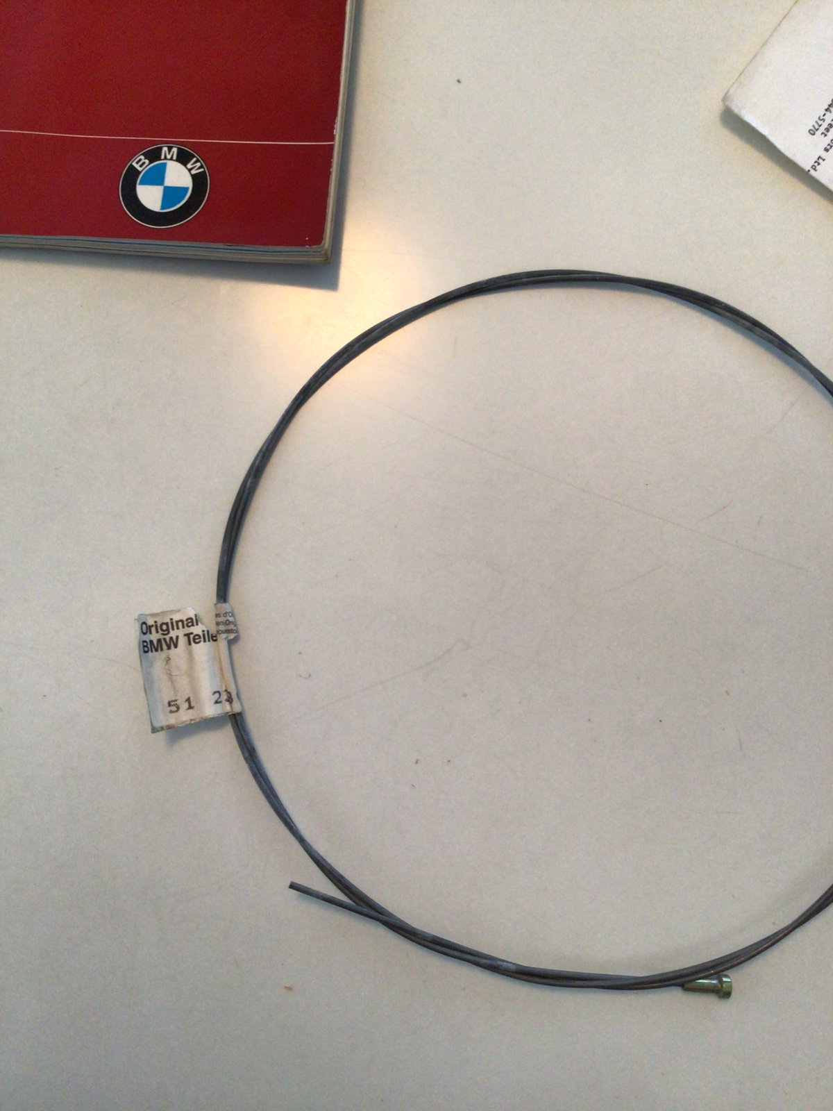

I also discovered a original BMW part. What is it for?

It looks an awful lot like a hood release from a later car. Very similar to E36. Might it have anything to do with the sunroof?
Built April 25, 1972, took a long time to sell back then. Cable is not hood release which has a T at the end.

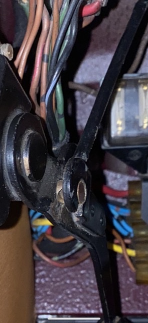

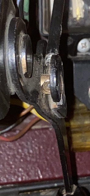

That’s the number but other coupes I have seen have a T at the end of the cable which slips between the lever and a parallel bracket. These tend to separate and the cable can slip out. The fix is a pair of channel lock pliers to squeeze the brackets back together.

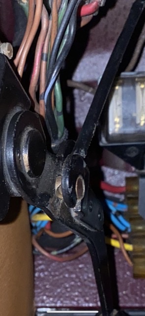

Mine has a cylindrical barrel with a hole in the middle to retain the cable. The barrel sits in the gap between the 2 sides of the bracket (which together forms a "T"). I have always assumed that was the original design but I do know that it is strong as my cable itself has snapped with the end still securely in the barrel and bracket.

Mine is the same. 71 2800CS

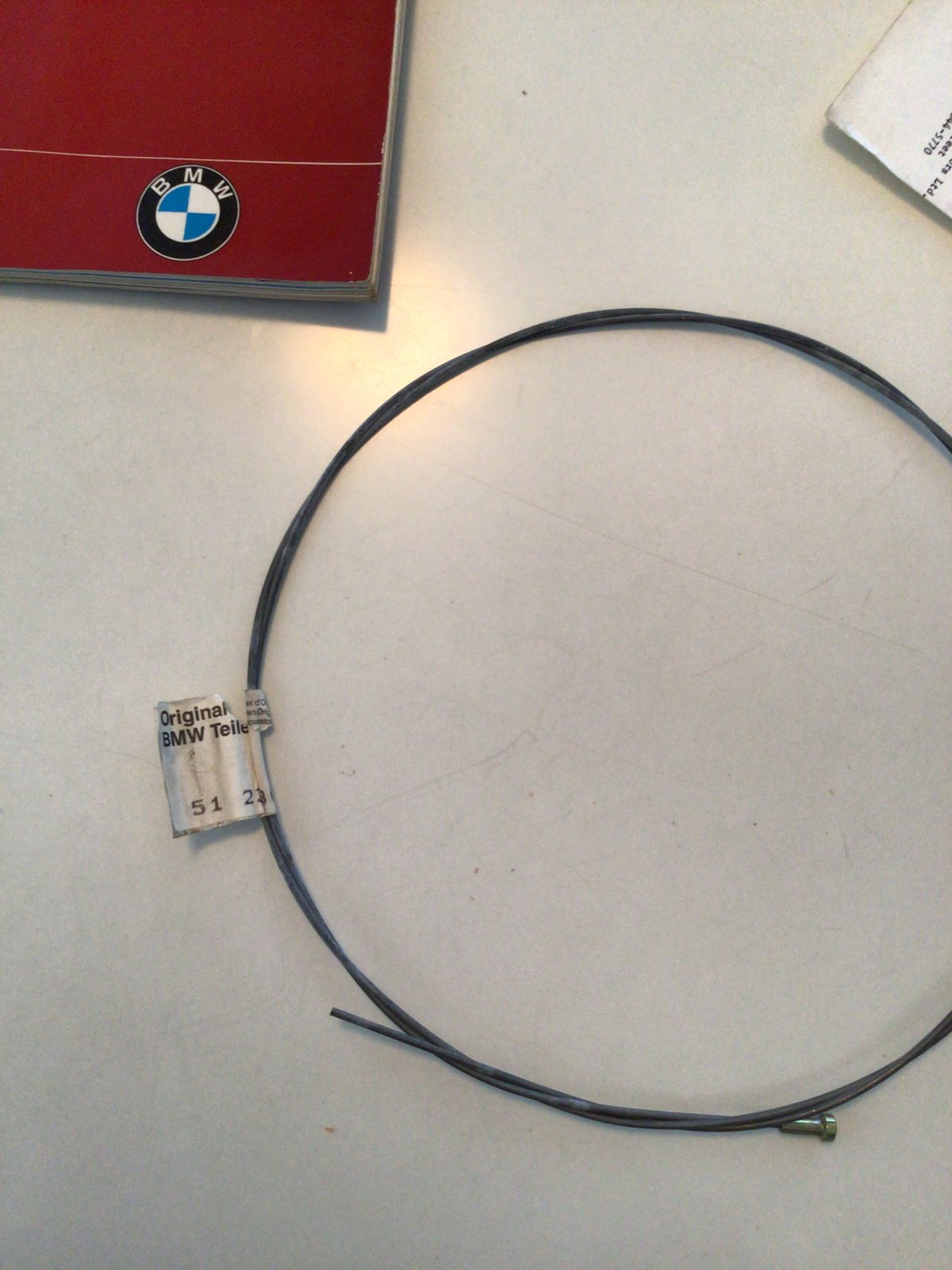

Ah, so the barrel is separate, my coupe isn’t here to check. I don’t see a separate part in the Orange book.

Mine
