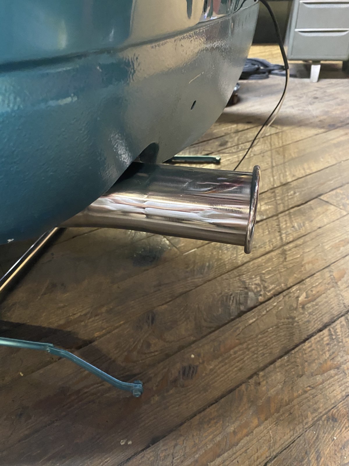

The Coupe King stainless exhaust tailpipe has a rounded tip. It can be wet sanded and polished to look like chrome. The W&N stainless tailpipe doesn't have the rounded tip. I'm sure it can also be polished. Here's the Coupe King tip.
