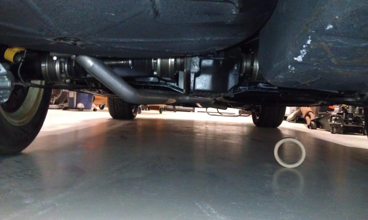

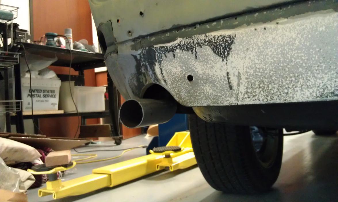

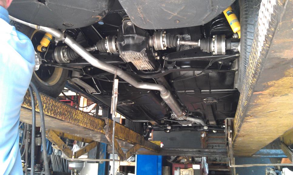

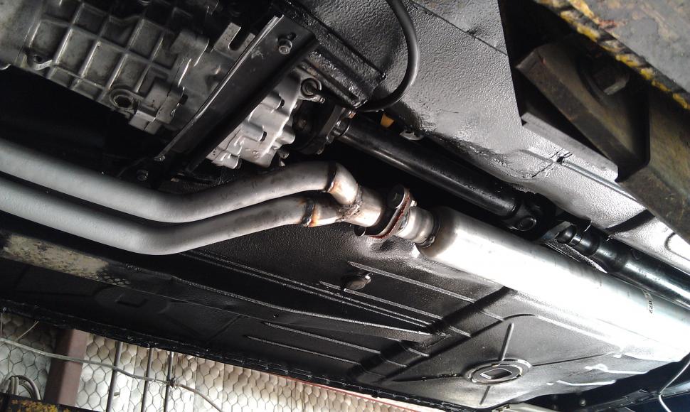

Here is what I did
Hi Henrik,
All this stuff should be pretty cheap- even in Sweeden or thereabouts. I had the 2 header pipes from the stock system. I sanded all the rust off and painted with High-temp silver, then brought to my local muffler shop and walked out the door for under 400.00 US

Reviving an old thread here, but I have come to the point I need to address my exhaust system. Long story short, I blew out my rear muffler and had it replaced by a small magnaflow exhaust; that, coupled with the deleted front and center resonator by the previous owner left me with an extremely loud system that I don't think has enough back pressure. I am looking for a temporary fix for now as I will eventually be putting in a 3.5 engine which will merit an upgrade to nicer system; for now, I would just like to quiet things down and not have the car sound like a V-8 wannabe. Peter, on your setup, what is the part number on that front resonator? Does anyone have a recommendation for a replacement rear muffler?

Hi Walter, it is a magnaflow but I don't know the model. We just found something in the shop that fit, and yes- it could be quieter. When I upgrade the engine I'll get something "proper" :-)
Thank for the reply Peter. I will go to a shop that has magnaflow products and see what can be worked. Hopefully I can just put a center resonator on it and get the effects I want. My coupe sounds like a Harley until it warms up, and even when warm, it still is pretty loud.
