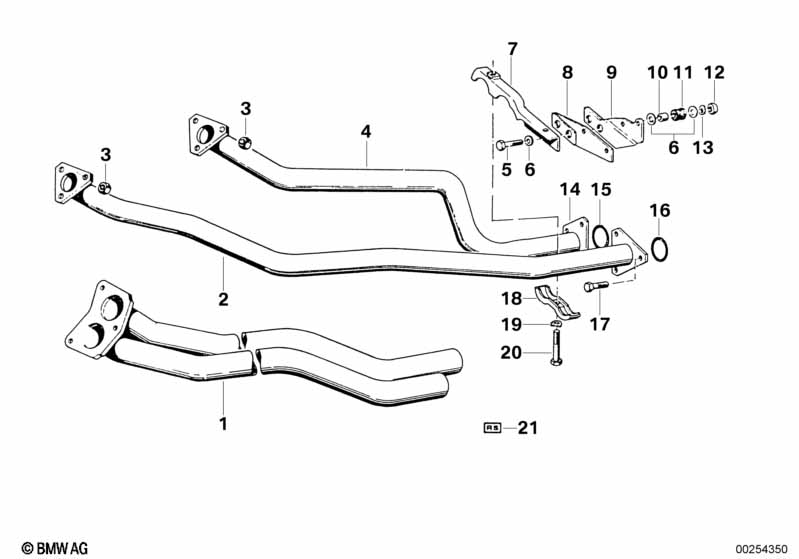

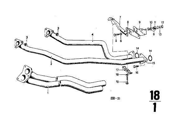

I need to buy the exhaust rings that join the down pipes with the center silencer. You can see that Maximillion (1st image below) has both of them as part #14 while Real OEM (second image) has them as different part numbers. The down pipes do appear to be a little different in size on my car. Anyone have an answer to this? Thanks

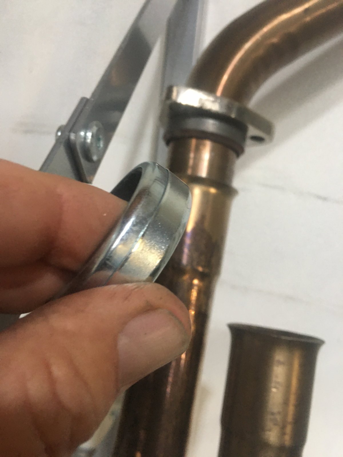

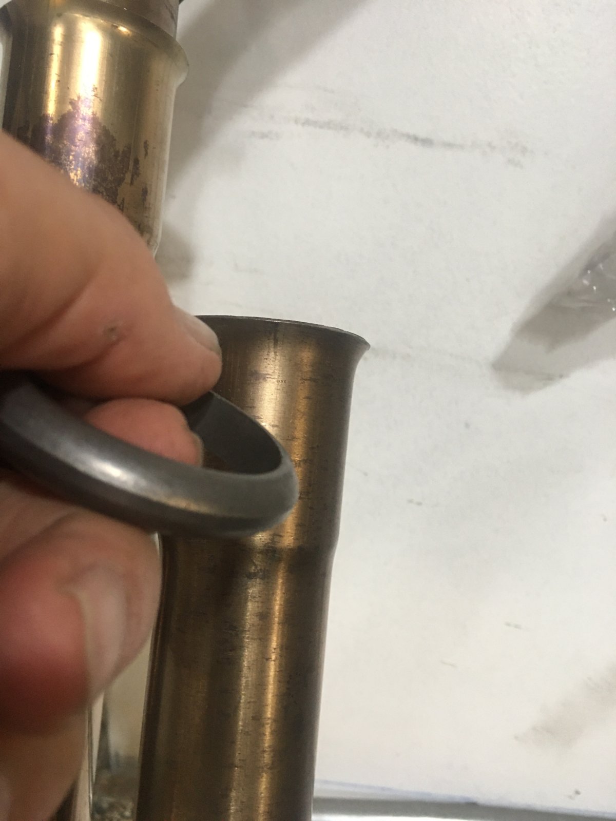

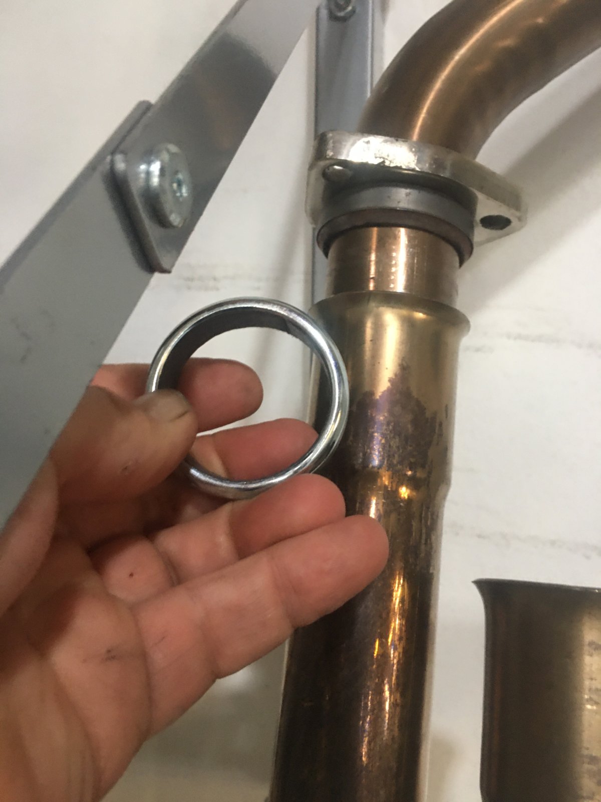

They are different.
The one is made of metal and it seals between the 2 cranked exhaust pipes.
The second one has a kernel with sealing material. It seals additionally by pressing on the pipe which is extended and goes in the inner through the connection.

One is solid ring of metal- between two flanges. Careful- if you drop it, it can break into pieces.
The other is a crush ring of soft metal layers
So I will purchase 15 and 16..Can I trust the diagram that 15 is on the right and 16 on the left or will it be obvious?
One solid ring, one crush ring
