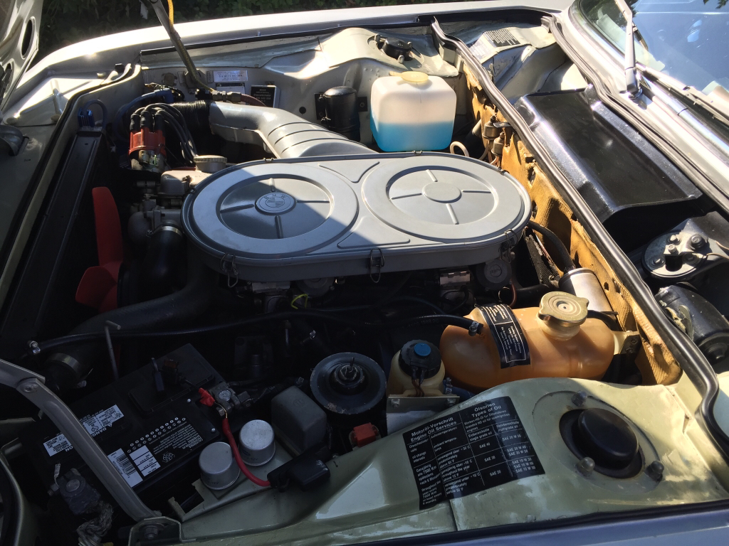

Definitely have your brass one fixed. You can take it to Seattle Radiator. Otherwise, you can fix it yourself with solder and a propane torch. It's the same a 'sweating' copper pipe. There are lots of youtube videos on the process. I consider myself pretty poor at soldering electronics but pipe work is easy.
I believe that they all had brass tanks inlcuding the '75. @HB Chris would know for sure. The thought is that they all started leaking and were replaced with the plastic ones.
