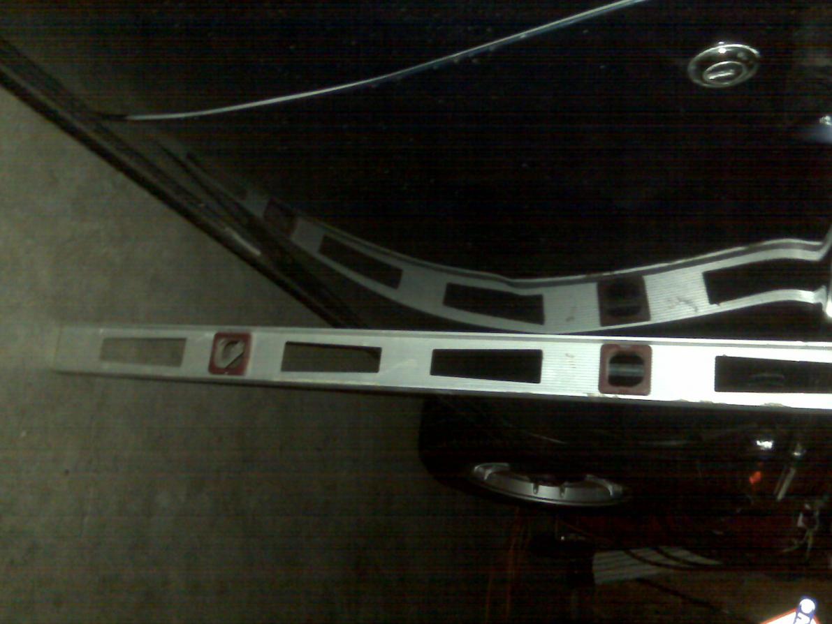

Door Profile
Hope this helps you out.:)

thanks very much. I'll now have a go at comparing your door shape with mine. Just to confirm original shapes... Is your door in original condition?
cheers, Bryce.
Door profile
Bryce,
Yes, my door is original. If you need measurements just let me know.:)

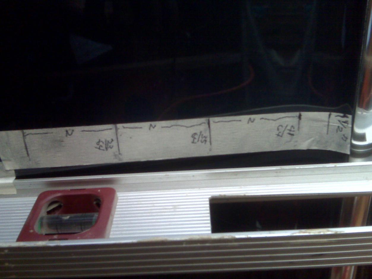

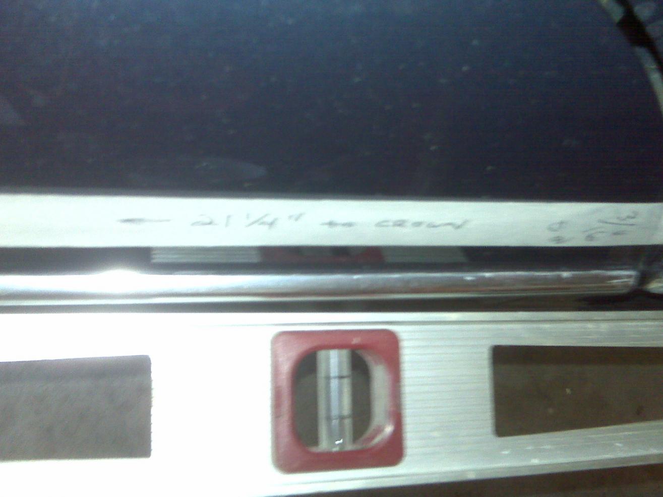

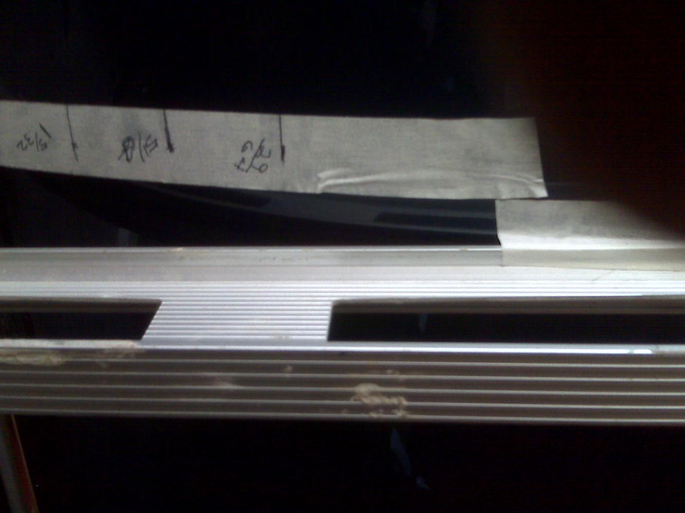

Door profiles with measurements
If the measurements are hard to read, just let me know. The interesting one is the horizontal with crown/ peak.
Best of luck!:)

Thanks very much for these pics - I'll be having another go tomorrow at seeing how "corrrect" the panels are.
cheers, Bryce.
