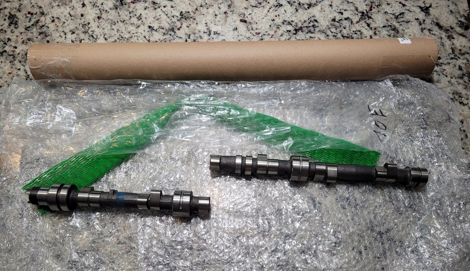

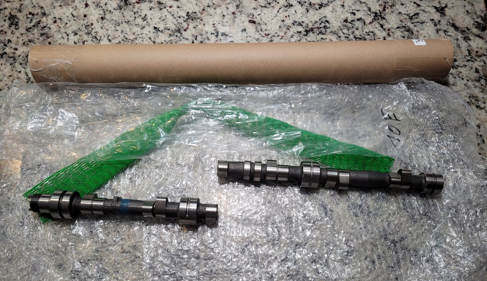

My Dbilas 282 cam from Gladen arrived last weekend. It must be the new "easy to install" two piece cam as it came that way. It wasn't packed well at all for an international trip and Gladen is working with DHL to settle a claim.

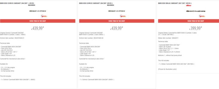

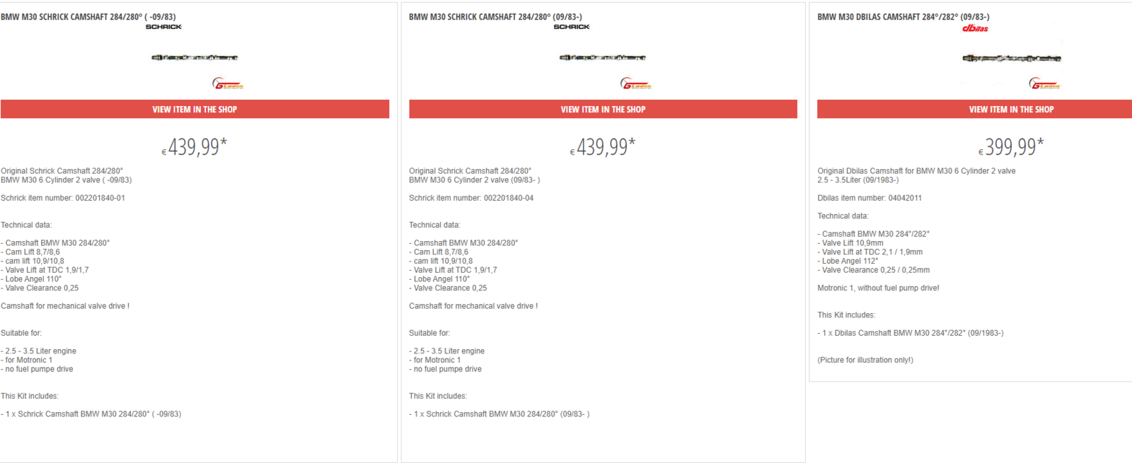

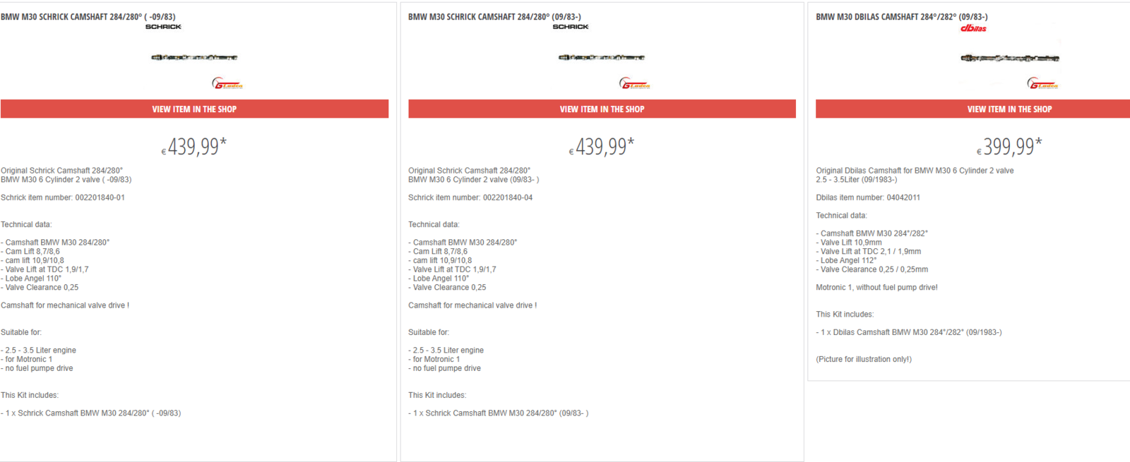

Unfortunately they don't have a replacement distributor cam in stock and don't know when they will. They do have the 284 cams in stock, both Schrick and Dbilas (see pic). As I understand it, I could use either of these three by simply adding the parts necessary for the distributor drive. I'm using an electric fuel pump so the pump drive isn't important. Suggestions?

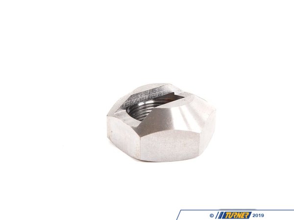

@sfdon, Thank you for that link. I've got the nut ordered.
Do you prefer either one of the three cams in the comparison chart I attached above? Engine is soon to be (next year) 9.5:1 compression, Shrick/Dbilas cam, 40 DCOEs, ...
