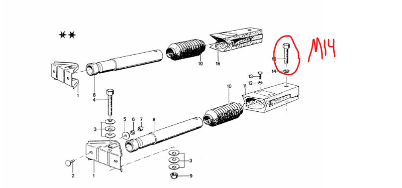

Is it as simple as removing these M14 bolts?
Please tell me I don't have to pull the radiator to remove the front bumper
You shouldn’t have to. The two bolts you need to remove are located at the top of the frame rails on either side of the radiator. The issue may be that your radiator has an additional tank on the right (passenger) side for automatic transmission fluid cooling making it wider, on the top half, than a manual trans version. The trans cooling lines connect to the right side tank. Combined this may make access to right side bolt difficult. Can you get an open end wrench on the bolt?
I had already converted my car from AT to manual and had installed the manual radiator so access to the bolt was easy when I did the bumper swap.

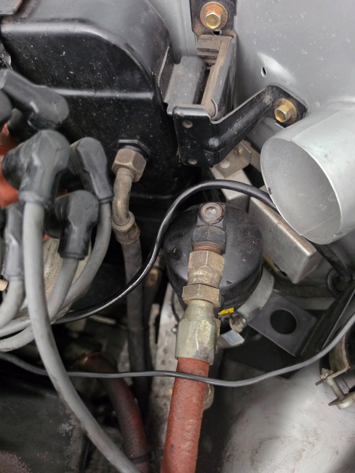

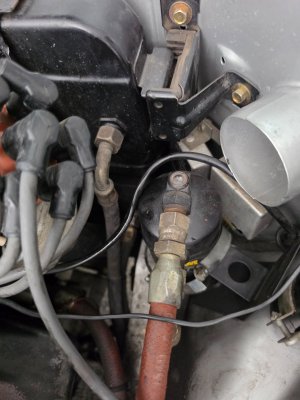

I can take a photo on my car if that would help.
Yep, the bolt is below the AC dryer. I wonder if you remove the radiator bracket and the relays below it if you'd have access with extension and a swivel adapter o_O
